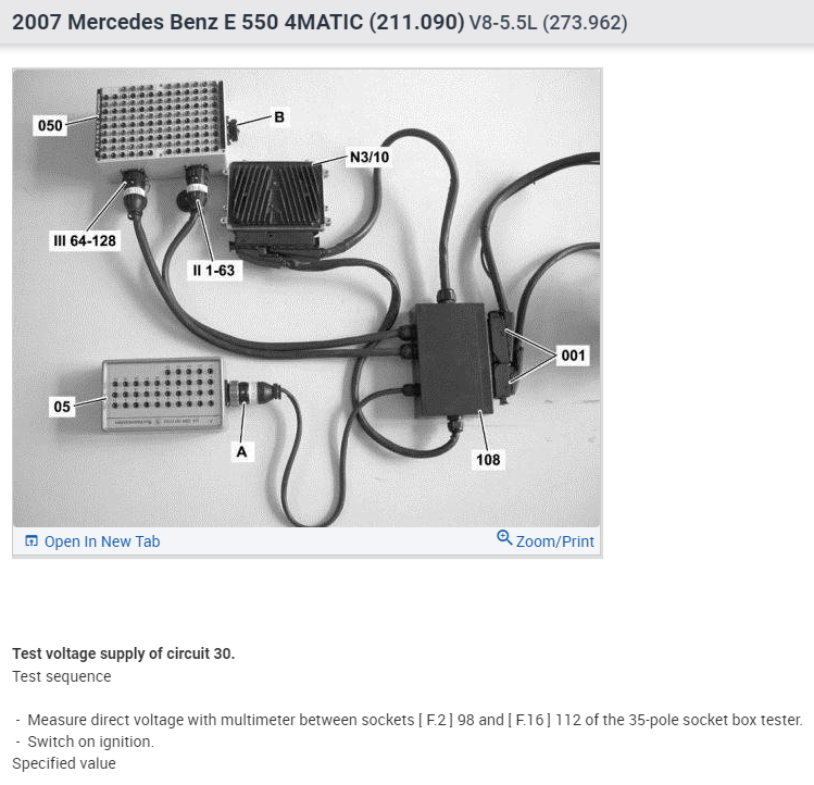

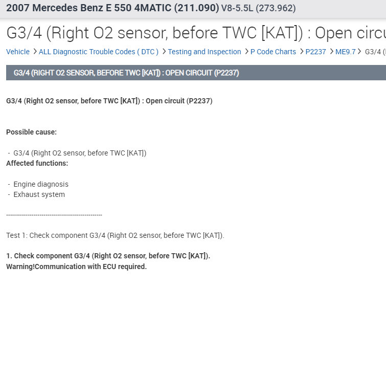

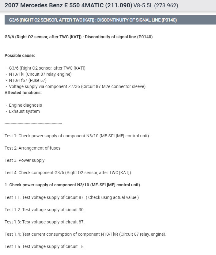

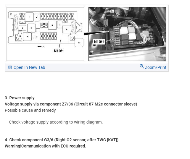

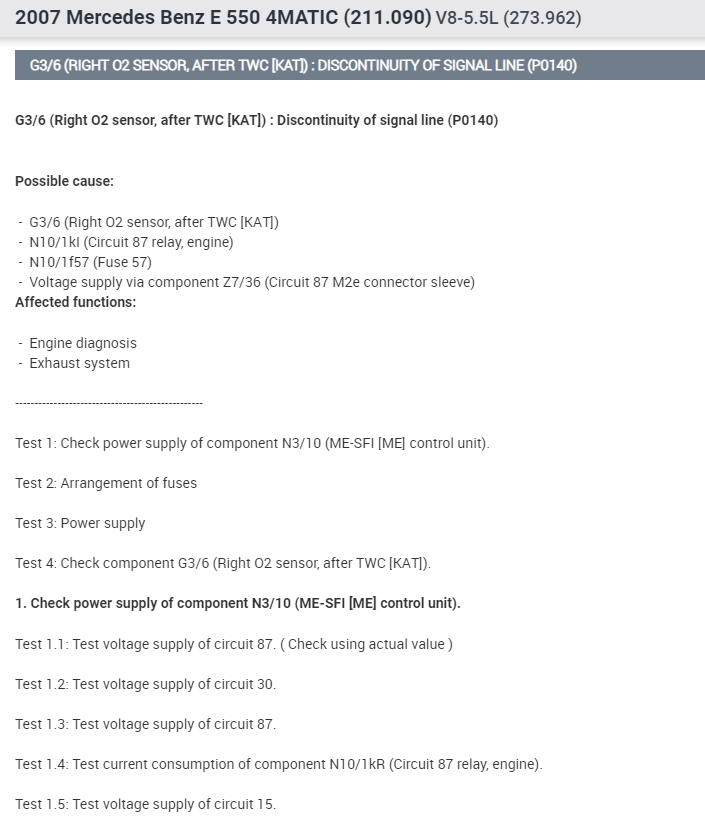

These codes are for the right-side oxygen sensor after the converter.
This code is typically generated due to wiring issues.

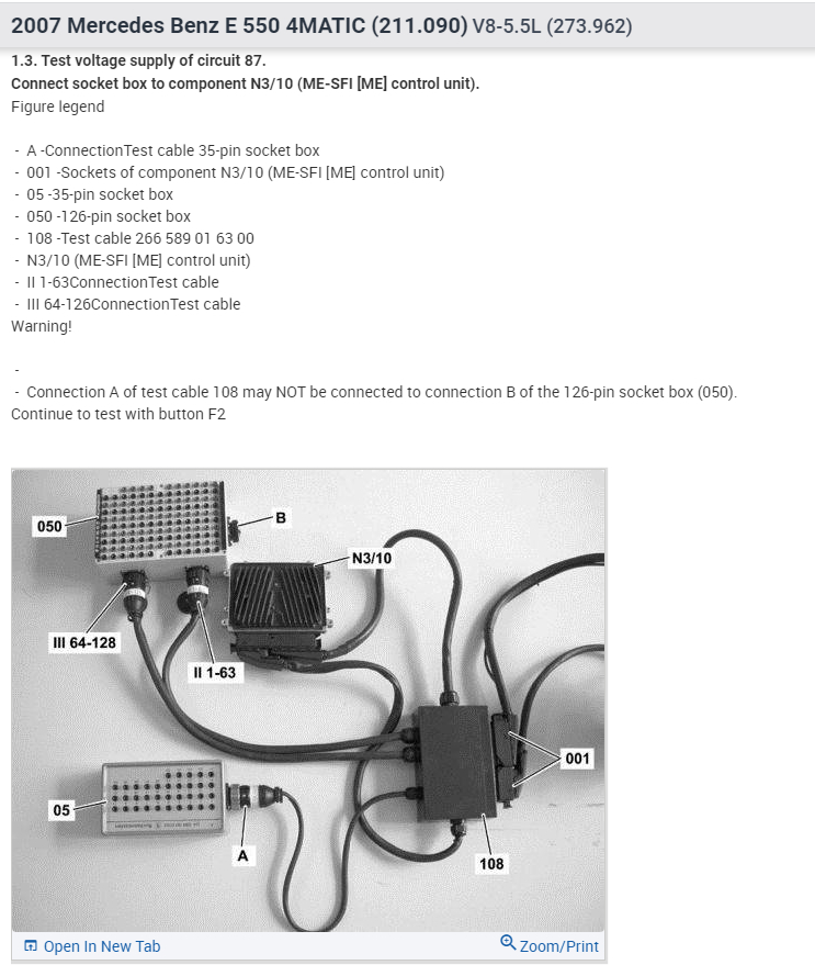

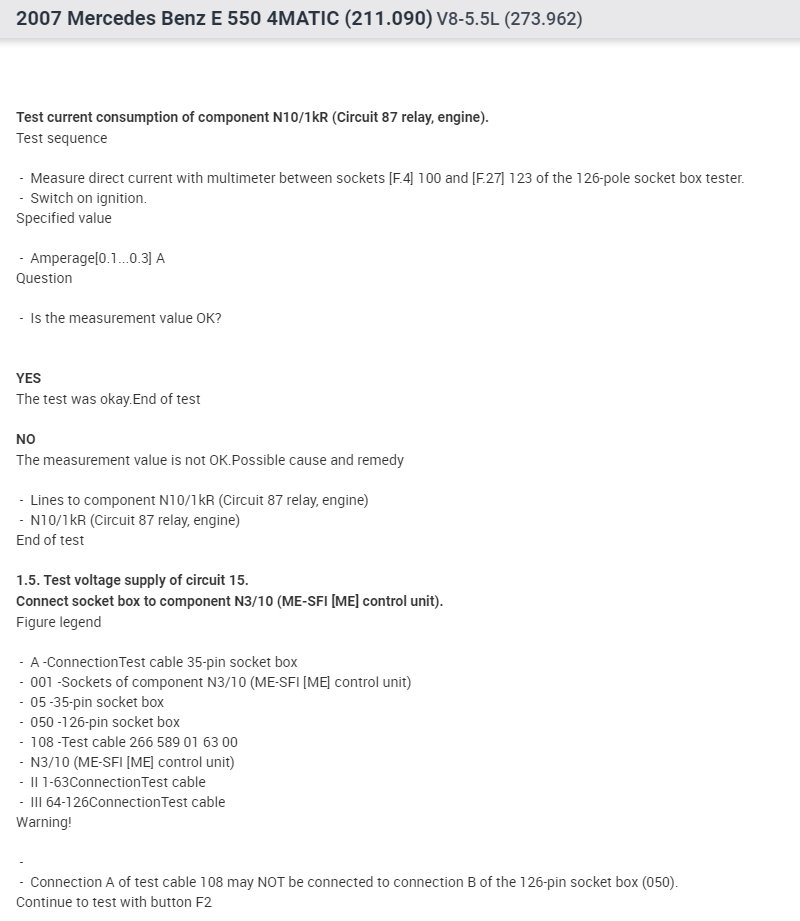

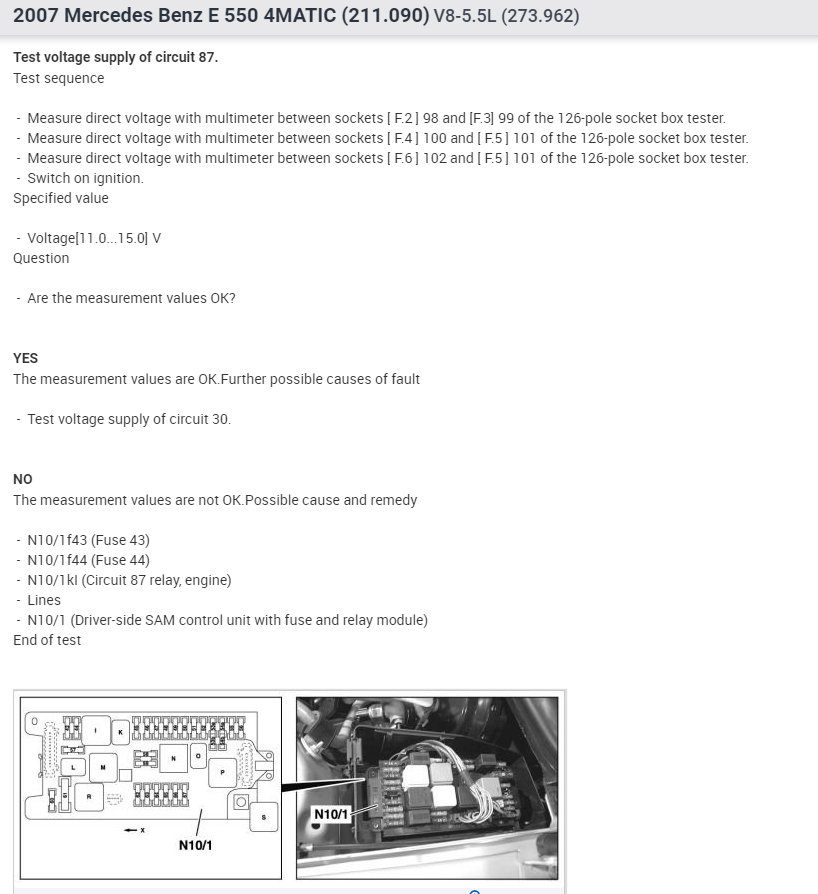

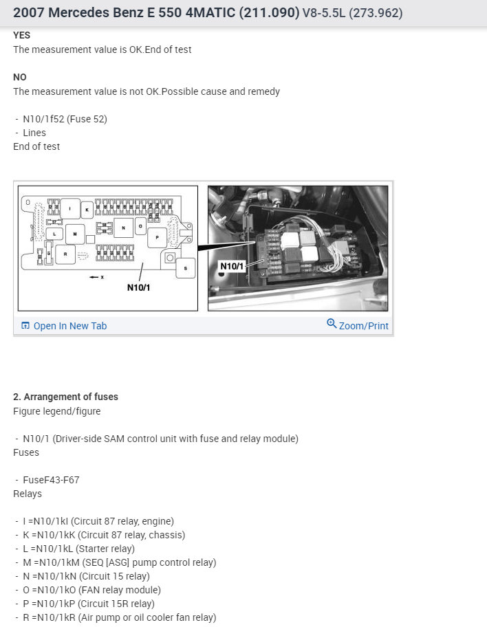

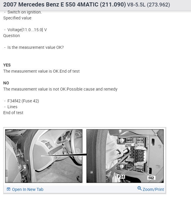

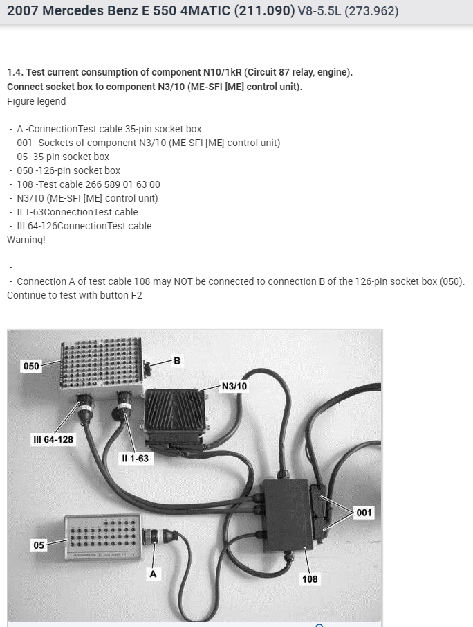

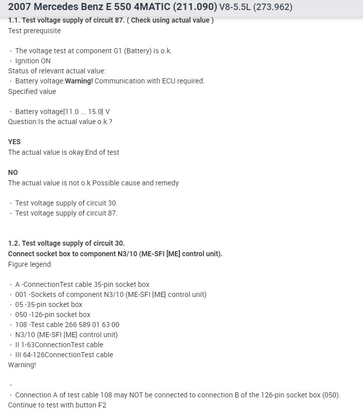

I have attached the diagnostics steps for code P0140 below. It shows the exact steps you will need to take to find the issue.
