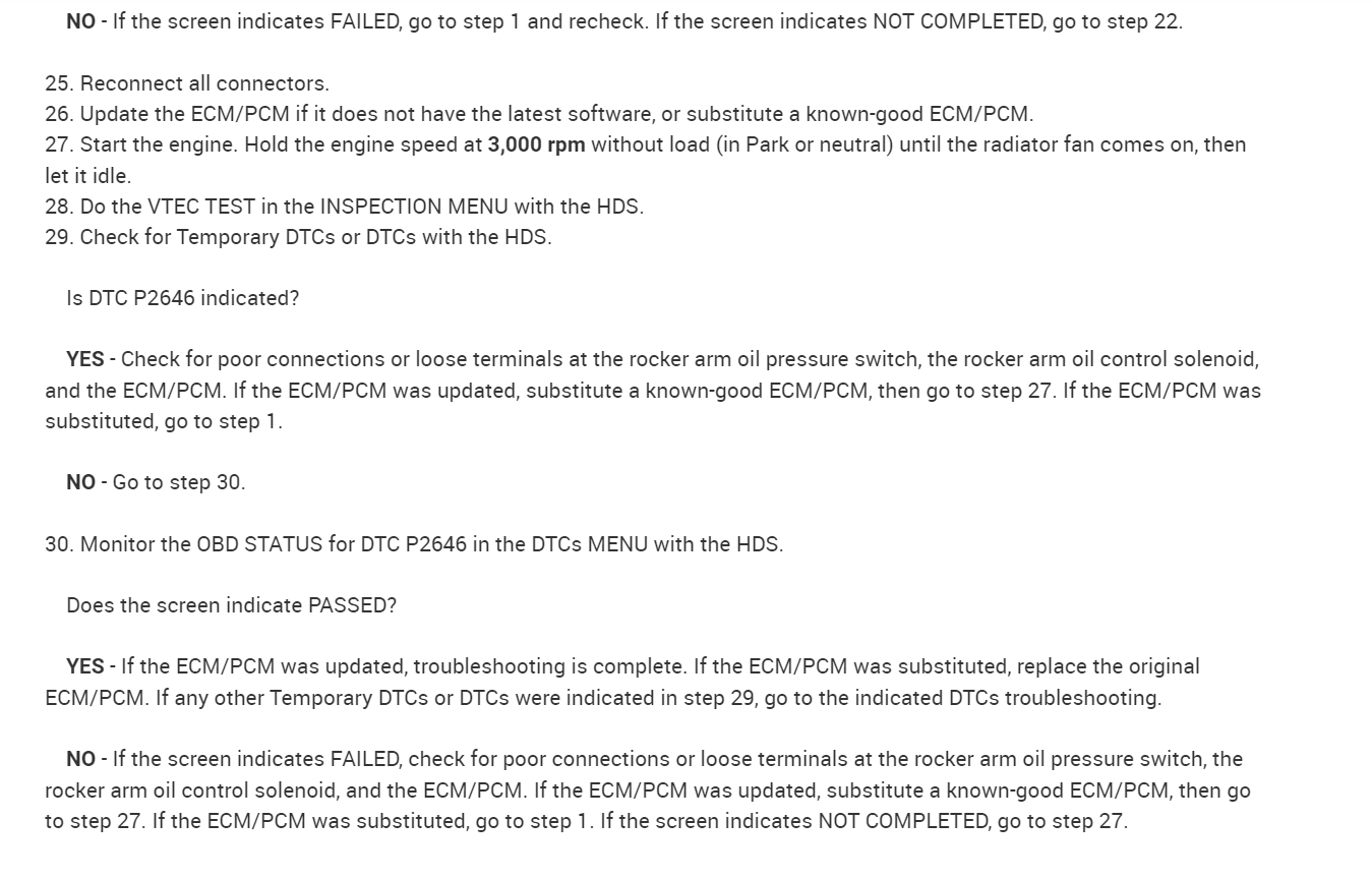

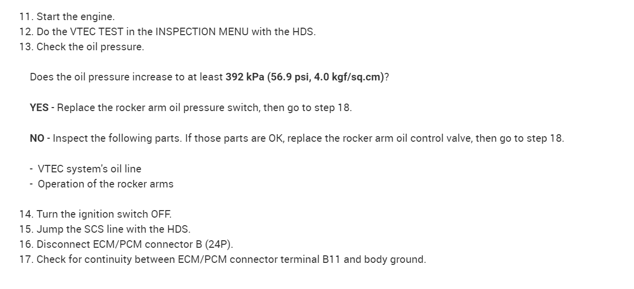

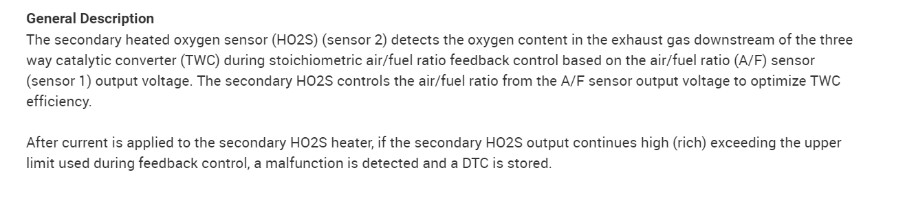

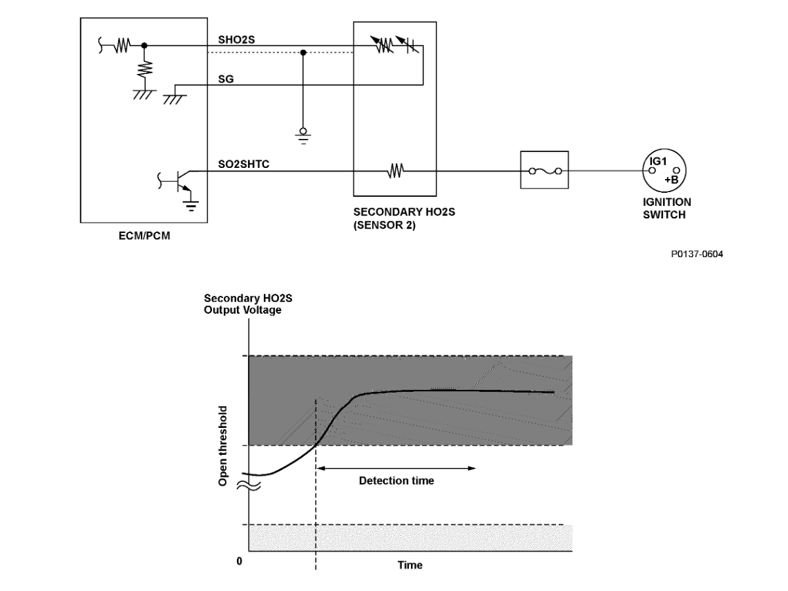

My car has posted the codes:

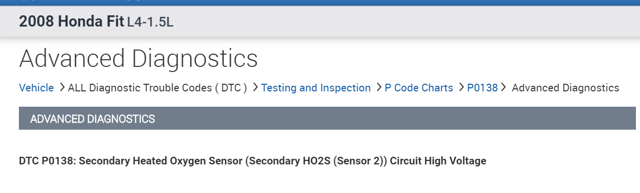

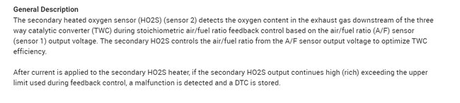

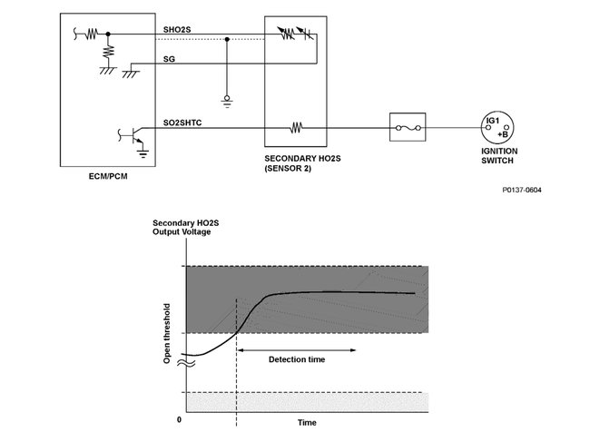

P0138, B1S2 O2 sensor high voltage
P0139, B1S2 O2 sensor slow response
P0420, catalytic convert inefficiency

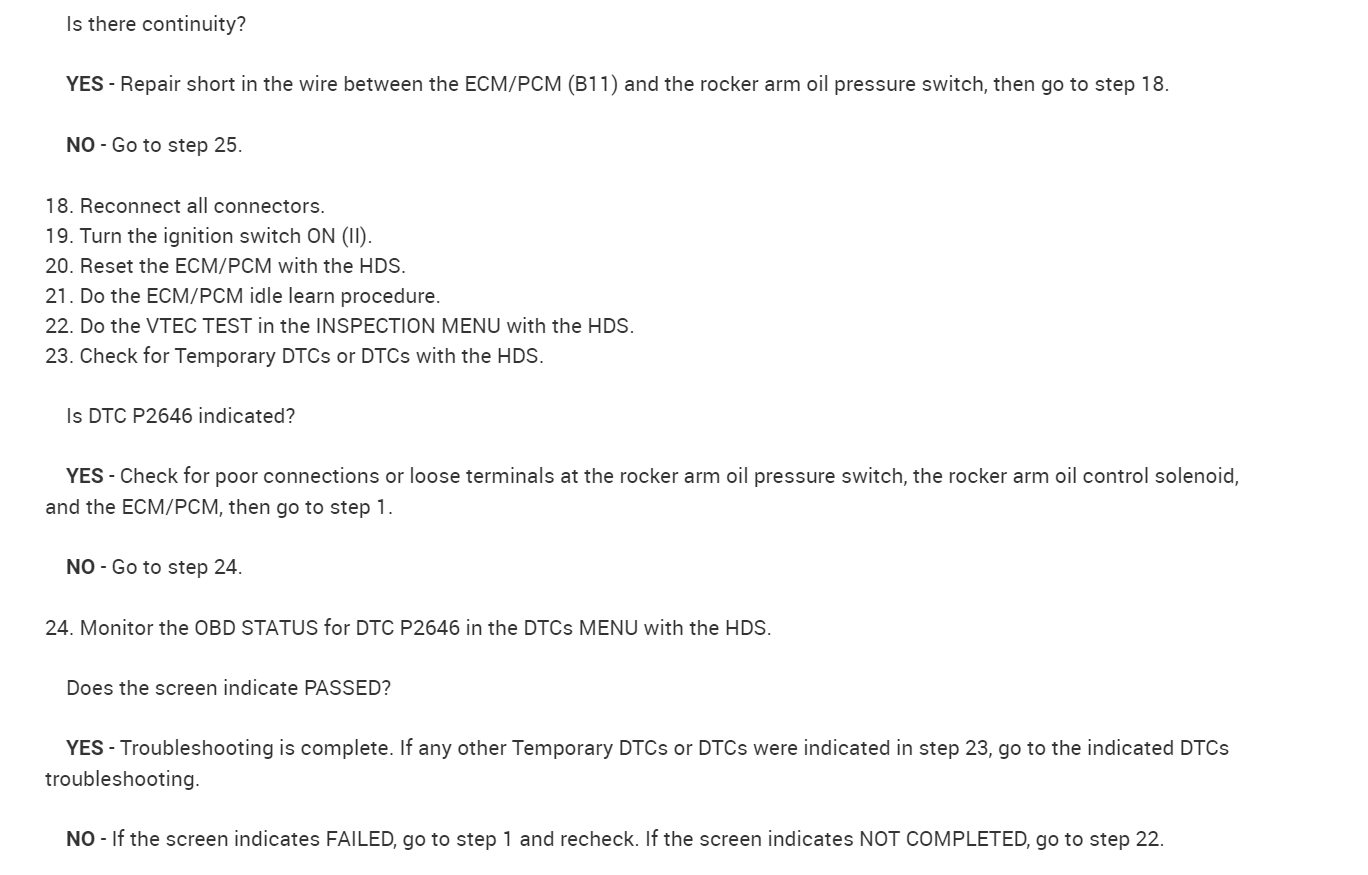

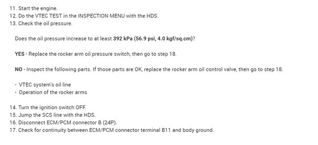

P2646, rocker arm actuator
To address the codes related to the oxygen sensor I first replaced it with a new sensor spliced into the old wires. When that didn't resolve the codes I replaced it with a direct fit OEM sensor. Still coding. I doubt that the sensors are defective, and the wiring harness appears in good shape since it is in the interior of the car and the slow response code suggests an existing connection. Could there be an issue upstream of the sensor that could be the cause? Vacuum leak? Bad computer? Where should I look? The car runs well enough in spite of the code, albeit with smelly exhaust and less mileage.
