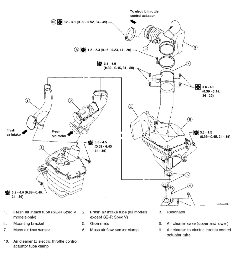

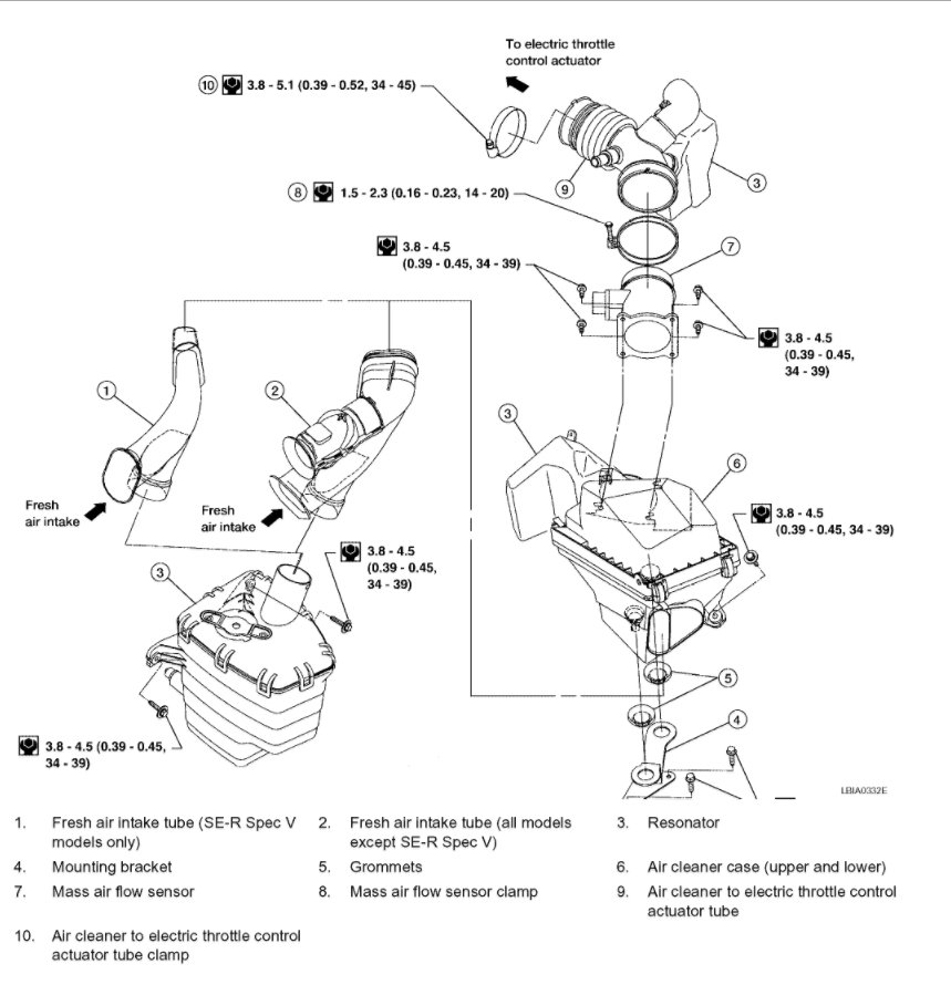

This code can be caused by a dirty MAF sensor. I suggest you clean it free and then clear the codes here is a guide to help you see what to do.
https://www.2carpros.com/articles/mass-air-flow-service
It might be too far gone and you will need to replace it.
https://www.2carpros.com/articles/how-to-replace-a-mass-air-flow-sensor-maf
Please let us know what happens. No vacuum leak?
Check out the diagrams (below).
