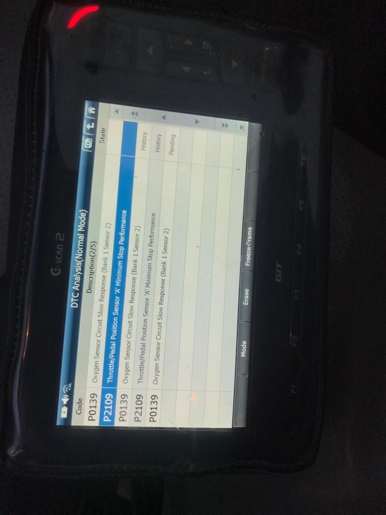

IFAM9877
This is the code:
Feb 23, 2022 at 5:24 AM
Okay, can I have the long-term trim for the sensor?
