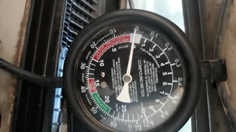

The problem with the low voltage reading of the oxygen sensor, could it be due to leakage problems in the intake or exhaust valves? Perform the test by putting a piece of paper in the exhaust, it sucks on the paper. Could you do a compression leak test?
May 12, 2020 at 10:59 AM
Yes, if you have vacuum, then you may have a compression issue.
Pull all the plugs and do a compression test.
May 12, 2020 at 11:11 AM

Okay, that is good.
Remove the oil fill cap while the engine is running and see if you feel vacuum over the hole. You should feel positive pressure coming out, not a vacuum.
May 15, 2020 at 3:11 PM
MARIOC68
  • 120 POSTS
I did the test in the oil filler hole, I feel blow and suction. I did it with a piece of paper.
May 15, 2020 at 5:47 PM
If you feel suction, you have a leaking intake manifold gasket. There should be no vacuum at the fill for the oil.

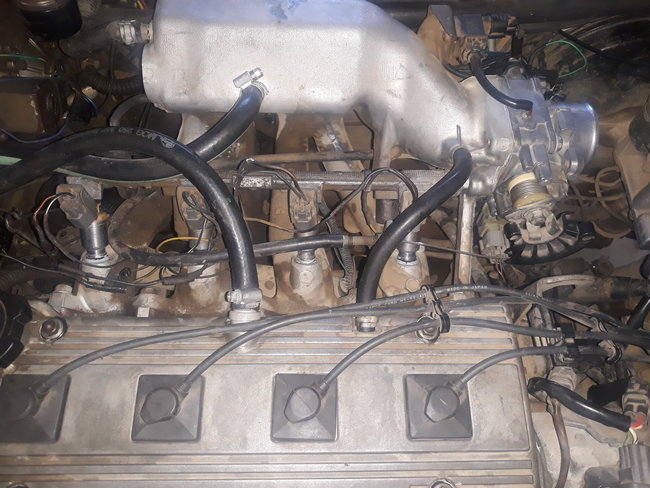

The left (thick) hose is the PCV valve and the right (thin) hose is a direct connection from the valve cover to the intake manifold. This hose is the one that made me empty in the oil filling mouth. Plug both sides of this hose. I retested with a running engine no longer generates vacuum.
May 16, 2020 at 12:18 PM
Okay, then you are good. Back to the catalytic converter testing.

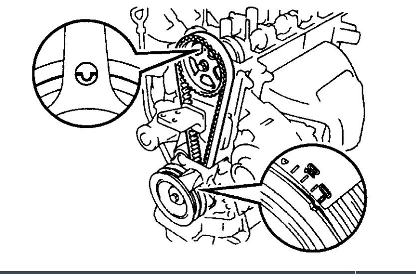

The next thing I would check is the timing. Check the valve timing on the belt and make sure the marks are correct.
I attached a diagram of the marks for you to check.
May 19, 2020 at 8:01 AM
MARIOC68
  • 120 POSTS
I check the timing of the distribution chain, it is correct.
May 19, 2020 at 12:03 PM
The reason I asked is the compression was very high. That tells me that maybe the chain is advanced from the normal setting.
