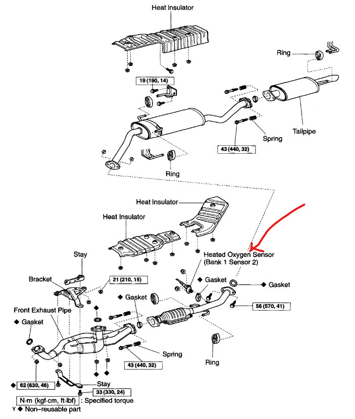

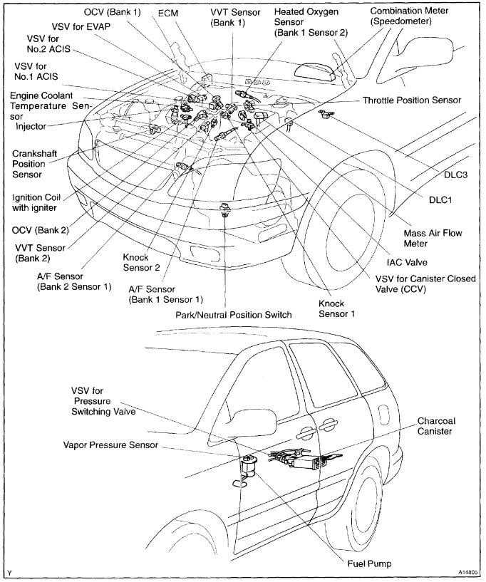

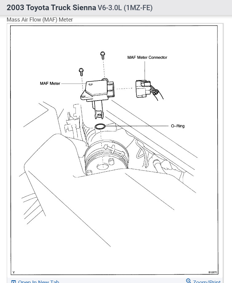

So, these codes have to do with the engine mixture, I would replace the MAF sensor and the oxygen sensor after the catalytic converter.
Code P2240: This code indicates an issue with the O2 Sensor Positive Current Control Circuit/Open (Bank 2, Sensor 1).
Code P0174: This code suggests that the engine is running too lean on bank 2.
Code P0154: This code indicates that there is no activity detected from the oxygen sensor on bank 2, sensor 1.
Here is the location of the MAF sensor and oxygen sensor so we can be on the same page. Check out the images (below). Please let us know what happens.
