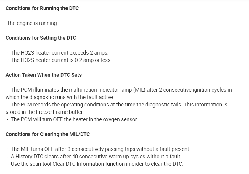

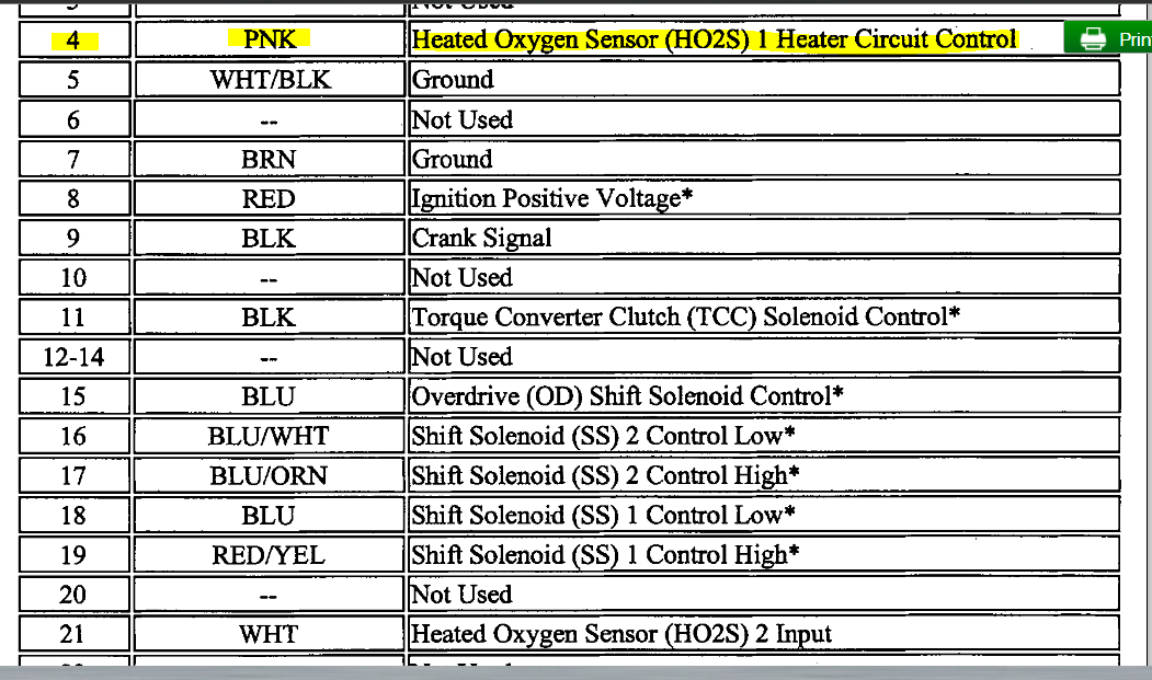

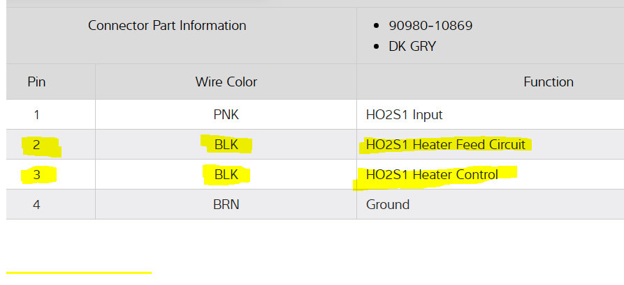

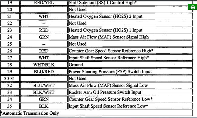

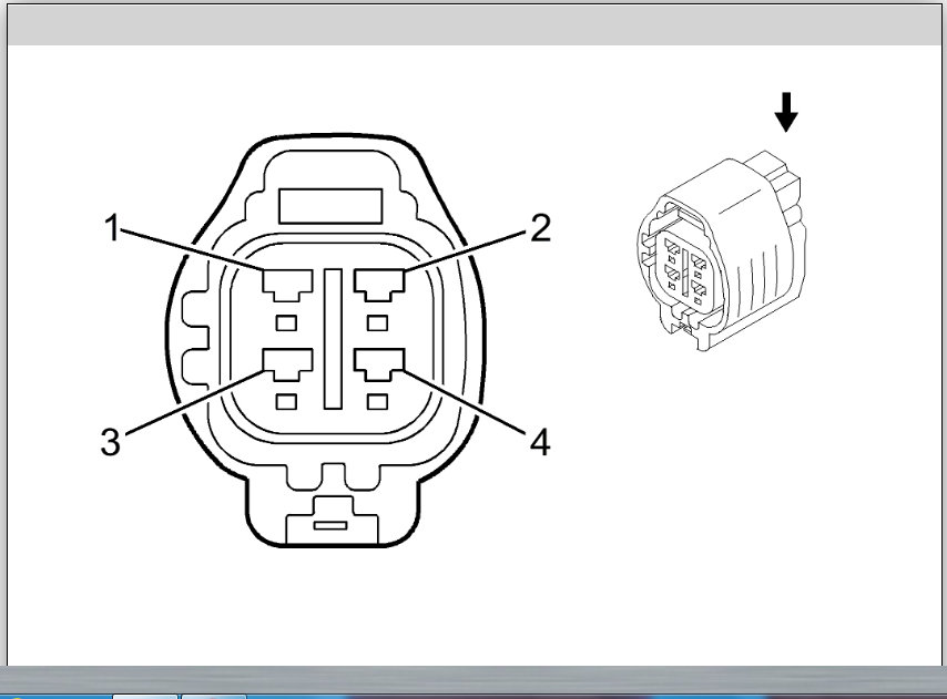

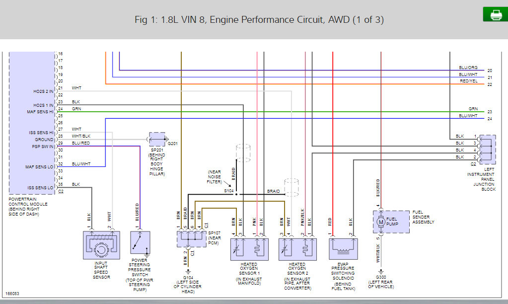

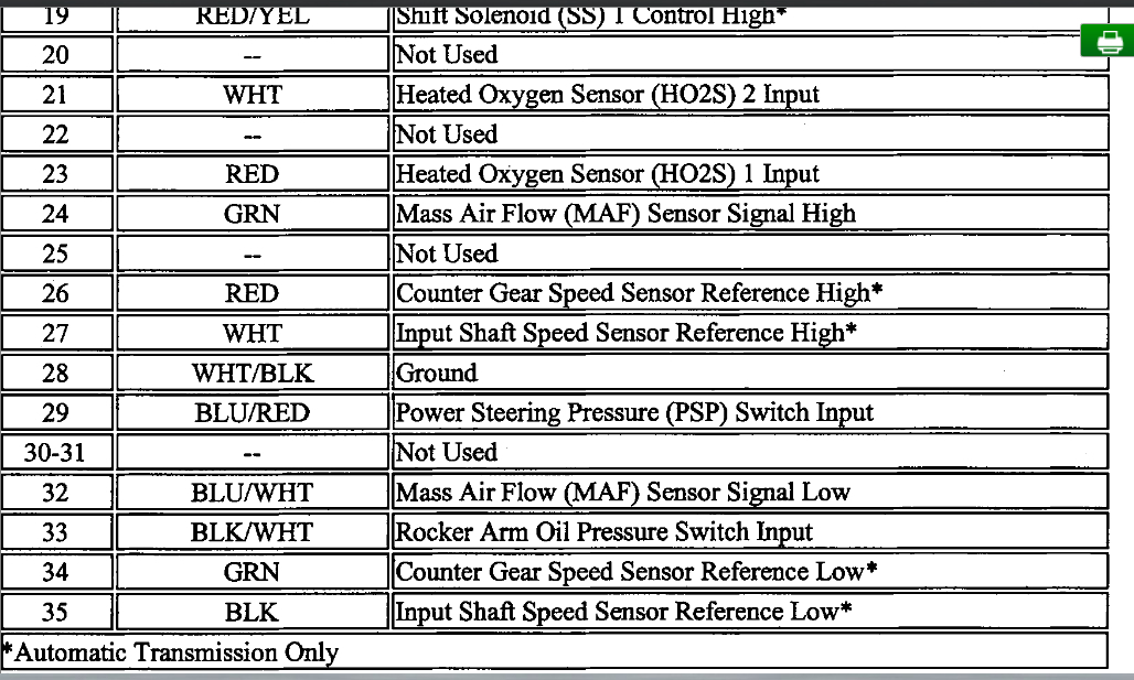

I’ve replaced my bank 1 sensor 1 twice now, cleared code both times and within twenty four hours the code is back on again. Used my multi-meter and everything is reading the correct oms and volts.
