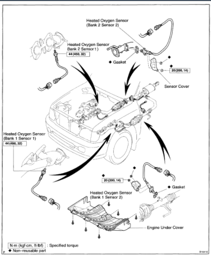

Your truck has 4 oxygen sensors 2 that are upstream left and right side and 2 downstream left and right side. You would have to provide us with the fault code that is showing which sensor is bad because it is very rare that all 4 sensor would fail at the same time. Here are tutorials showing what is involved for testing and changing oxygen sensors:
https://www.2carpros.com/articles/how-an-oxygen-sensor-works
https://www.2carpros.com/articles/how-to-test-an-oxygen-sensor-02-sensor
https://www.2carpros.com/articles/how-to-replace-an-oxygen-sensor

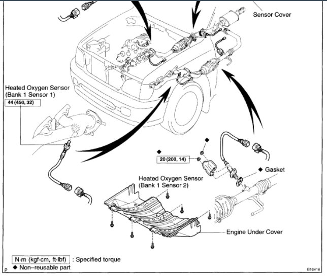

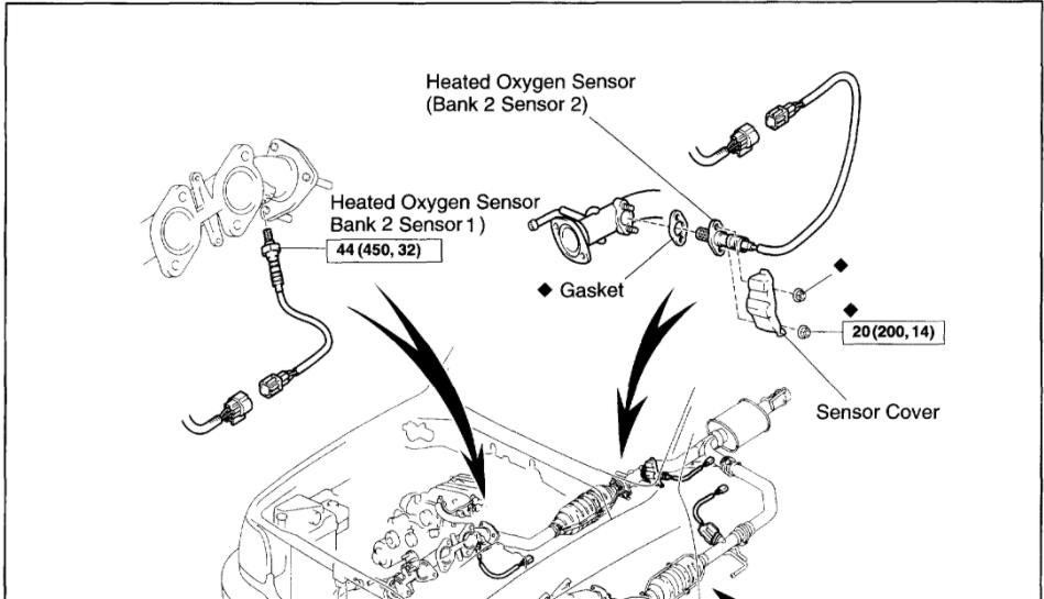

I've attached a few pictures below showing the oxygen sensor locations on your truck. Hope this helps and thanks for using 2CarPros.
