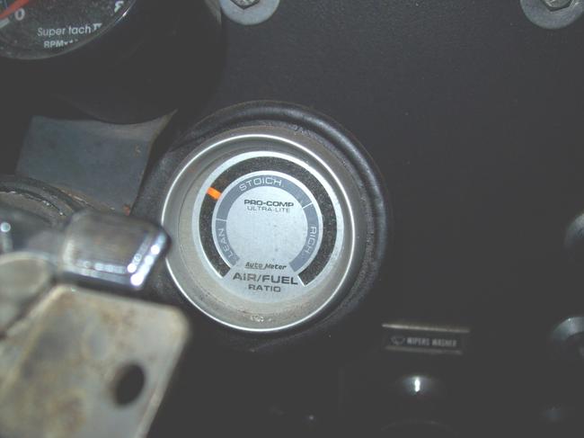

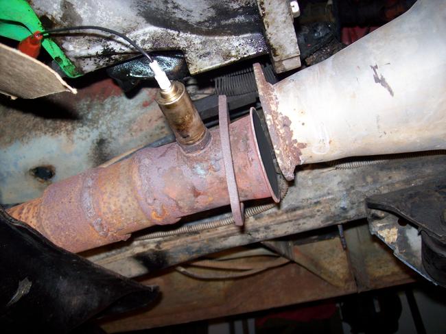

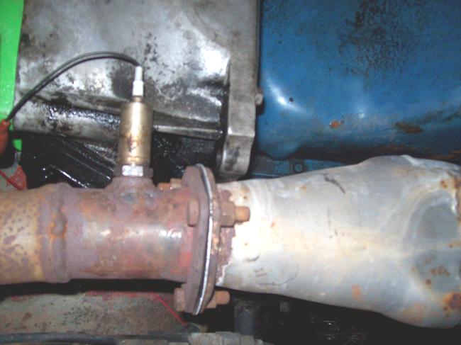

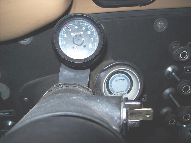

MY 1977 CJ 5 HAS AN O2 SENSOR....BUT NO COMPUTER!......IT IS INSTALLED AT THE END OF MY HEADER

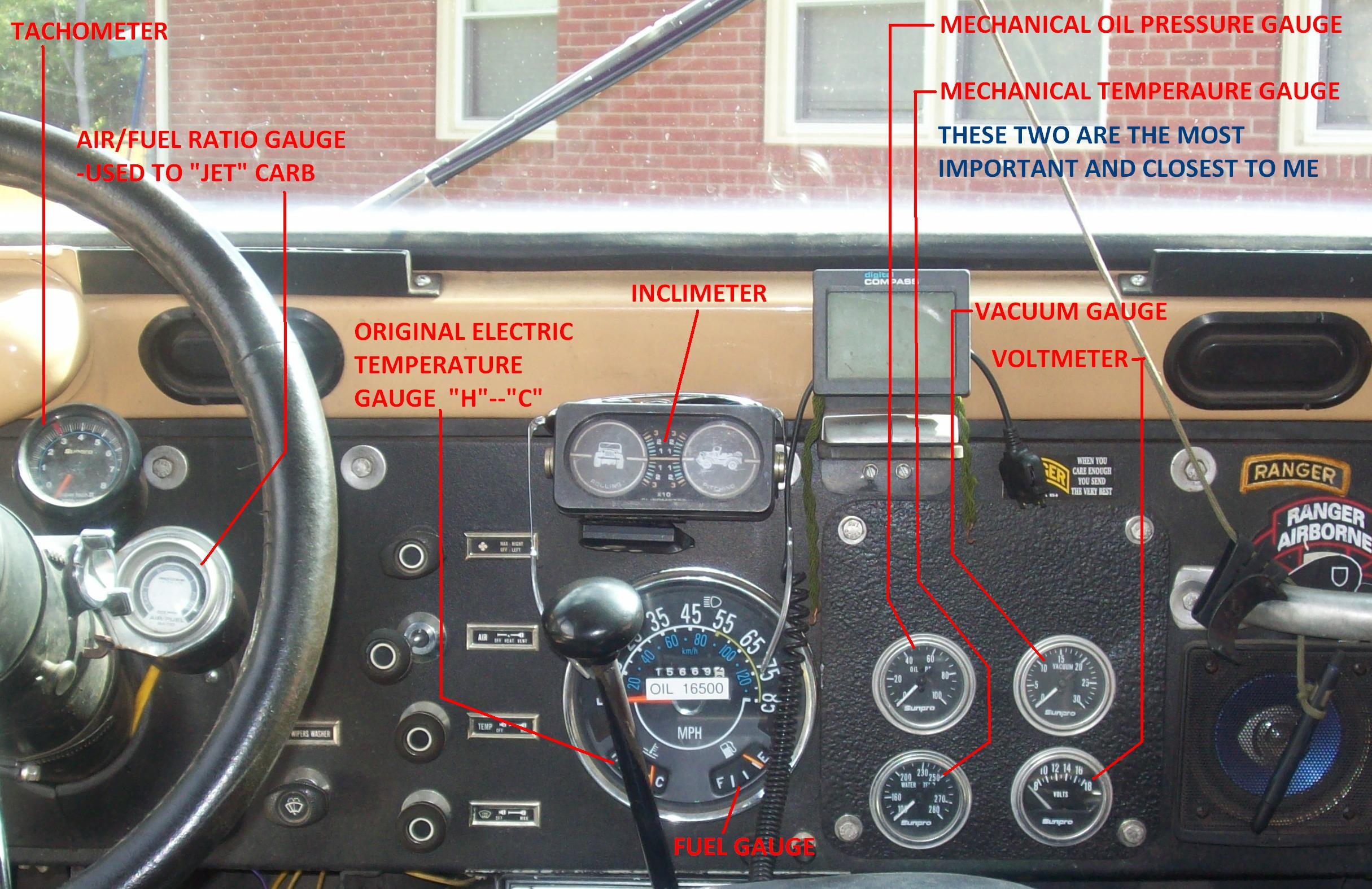

I INSTALLED AN AIR/ FUEL RATIO GAUGE ON MY STEERING COLUMN......IT IS THERE TO AID ME IN SELECTING THE CORRECT JETS FOR MY HOLLEY CARBURETOR.....A CARB CANNOT HOLD THE "PERFECT BURN" AS IN A NEWER CAR.......................BUT WE CAN DO, ALL WE "CAN", TO GET IT AS CLOSE AS WE CAN!!!!!
THE "GAUGE" IS A SERIES OF LEDs, RED (LEAN), YELLOW (STOICH), AND GREEN (RICH).........THE LIGHTS TAKE THE PLACE OF THE VOLTMETER.......THE GAUGE IS A LOT EZier TO COMPREHEND, THAN THE CONSTANT CHANGING NUMBERS ON THE VOLTMETER
MY MPGs ROSE FROM 15 WITH THE STOCK CARB, TO 18 USING THIS METHOD AND THE HOLLEY
