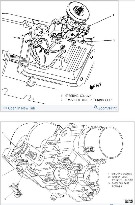

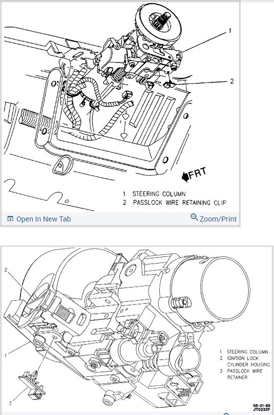

That car uses the PassLock system with a magnetic sensor inside the key cylinder housing and a magnet on the key cylinder itself to trigger a signal to the security system and activate the fuel system. There is no reliable bypass for it. As for how to repair it, that will depend on what was done to remove the ignition cylinder as there is also an anti-tamper piece in the housing that will damage the sensor depending on how the ignition cylinder was removed. If that was damaged or the housing was damaged so the key cylinder will not stay in properly the only good repair is to replace the steering column to get a good key cylinder housing. Then you can install a key cylinder and do a relearn to make it work. If the column itself isn't damaged it would be possible to replace just the housing.
Can you take some pictures of the area around the key cylinder opening so we can see if the damage is bad enough to warrant a column swap or just a housing replacement?

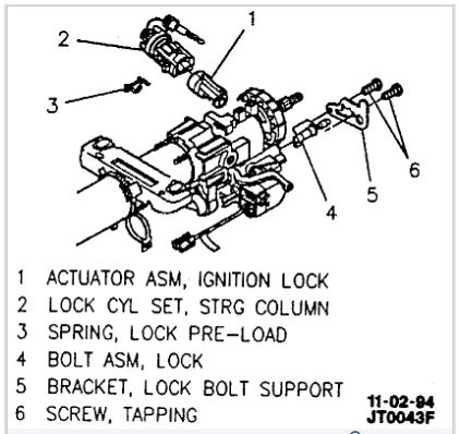

If you have minimal damage to the column it should be possible to replace just the key cylinder. For that you have a couple of options, one is to use the VIN number and order two new keys with a lock cylinder from a dealer or automotive locksmith. They will ask for the VIN, your ID and the title to prove you own the car. Then you simply install the lock cylinder and test the new cylinder to be sure it triggers the PassLock sensor. If it does the theft light will go off and the car will run. The other option is to replace the lock cylinder with a new one that comes with new keys, the catch to this option is that the rest of the locks on the car will not work with the new keys. For this method the easy relearn may work, but it may not, some of them are touchy and require a scan tool to reprogram the module. The scan tool would also tell you if the sensor was working or not.

As you have a broken cylinder you remove the two covers from the steering column.
Then to install the replacement you need to rotate the key in the housing to the run position with the ignition switch inside the column in that same position. The lock assy. should then slide in and lock in place. At that point you would do the relearn. If you needed to pull it back apart it is much easier with it already partially apart. If it works you can reattach the covers and should be all set. If the relearn doesn't work you will need a dealer level scan tool to complete the job.

Here’s how you can bypass the sensor.
Go buy a 2.2k (2200 ohm) ohm resistor at an electronics store. Go to radio shack and just get one as close to that as you can. Remove the covers on the steering column and locate three small wires at the lock cylinder. Cut the yellow wire and the orange/black wire or on some vehicles, it’s the yellow and black wires. Solder the resistor between those wires. Tape it up and put the covers back on and follow this relearn procedure. If this doesn't work you have a wiring problem in the steering column.
