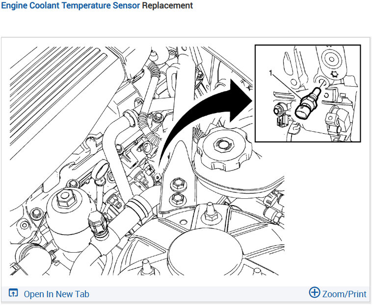

Let me know what you find. Please go over this guide and get back to us. Here is the location of the coolant temperature sensor and I will email it to you. Check out the images (below). Make sure to drain the coolant first with the engine cold.
