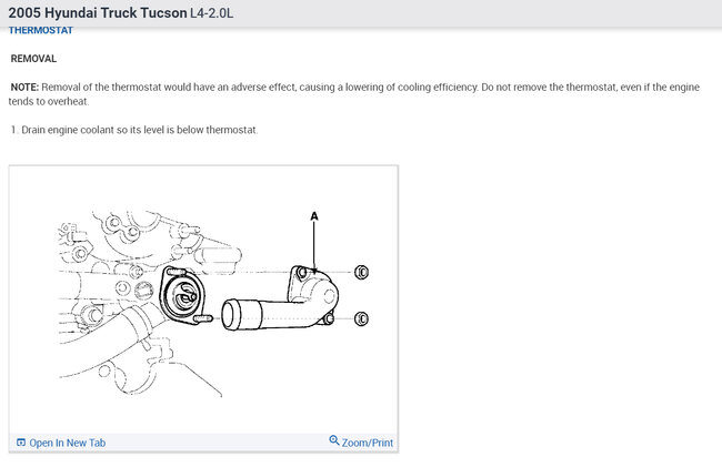

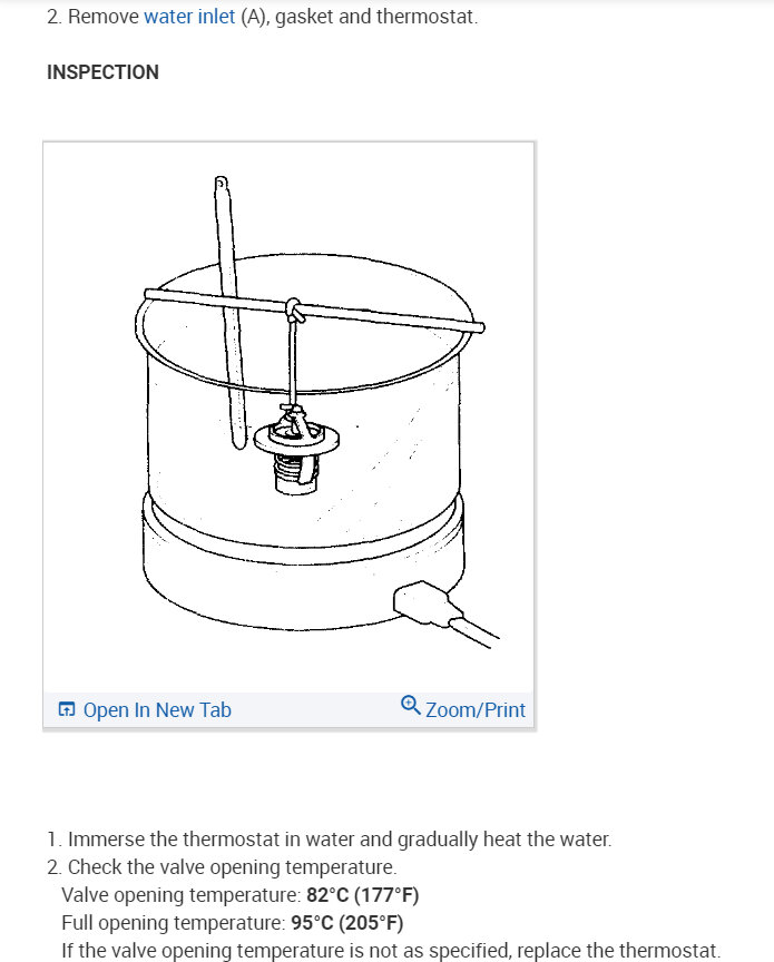

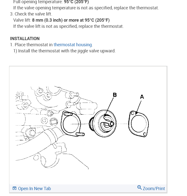

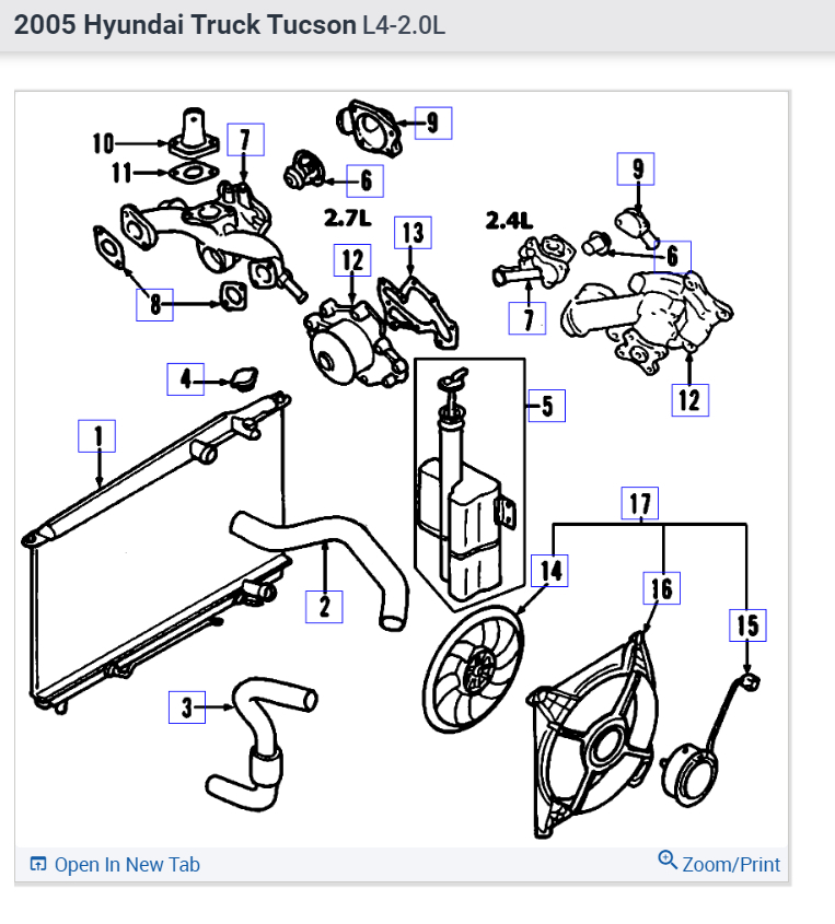

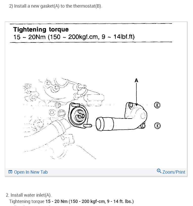

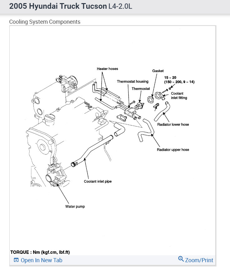

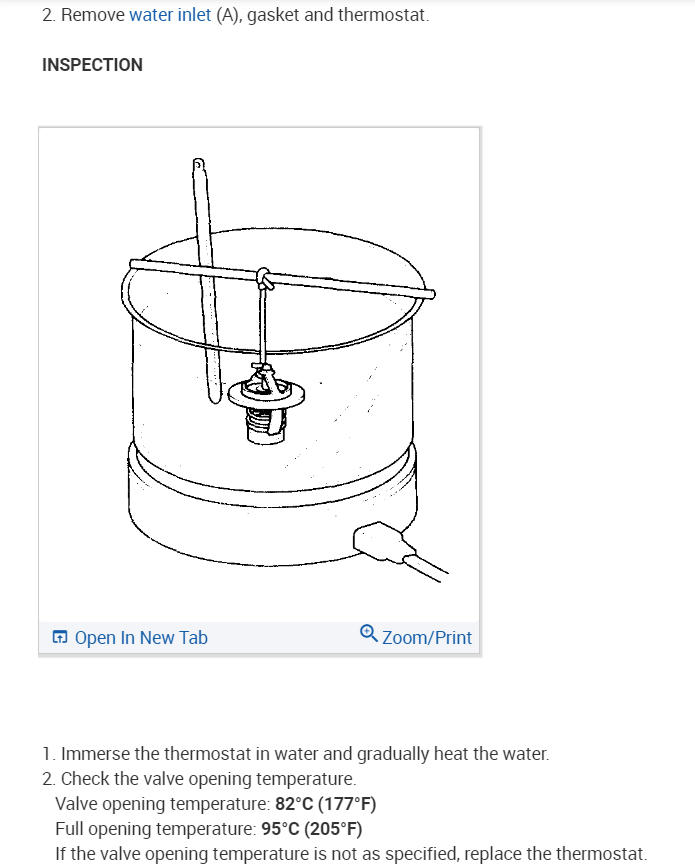

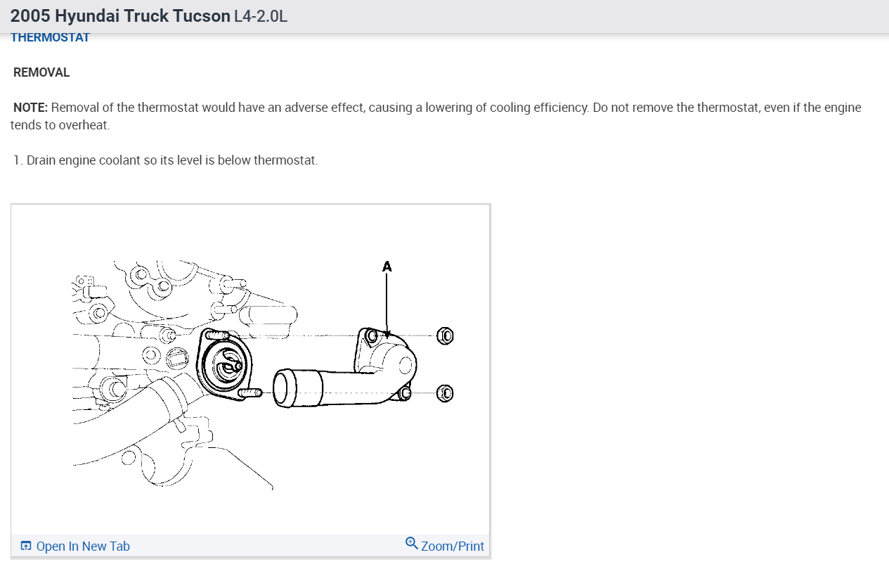

It sounds like the radiator can be clogged internally and I would replace the thermostat as well. here are two guides to help you and i have included how to change the radiator and thermostat out in the images below.
https://www.2carpros.com/articles/engine-overheating-or-running-hot
This guide will help walk you through the steps:
https://www.2carpros.com/articles/how-to-replace-a-car-radiator
and
Check out the images (below). Let us know what happens and please upload pictures or videos of the problem so we can see what's going on.
