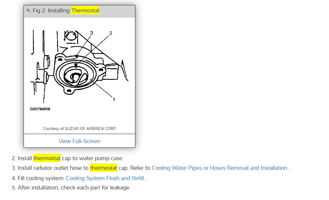

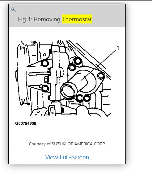

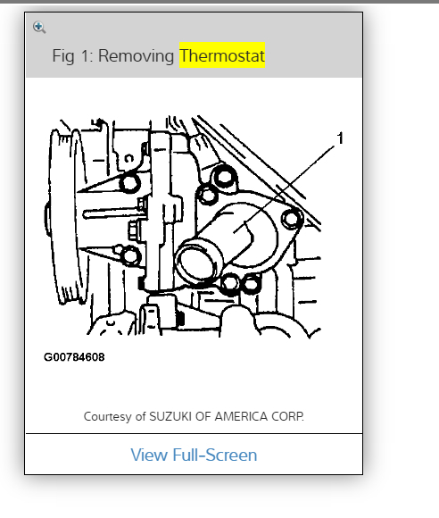

The thermostat is near the water pump. here is a generic guide to help you do the job with specific instructions in the diagrams below to help you with your car:
Check out the diagrams (below). Please let us know if you need anything else to get the problem fixed.
