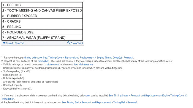

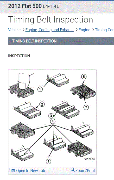

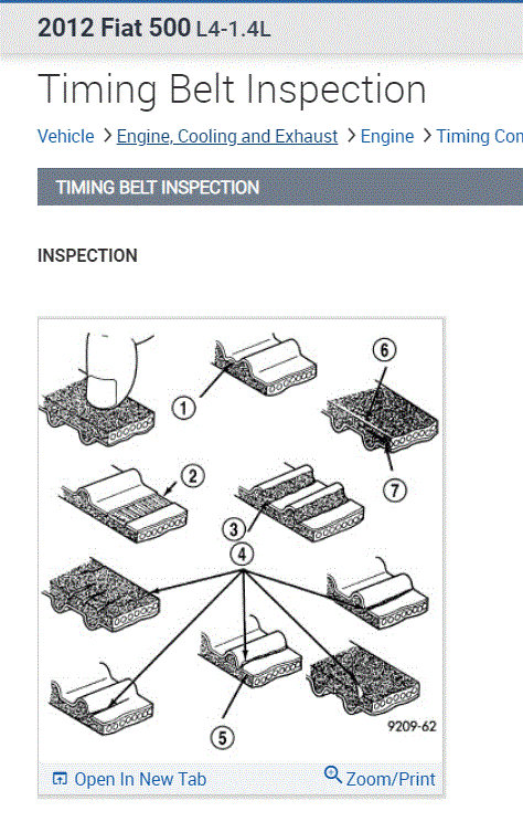

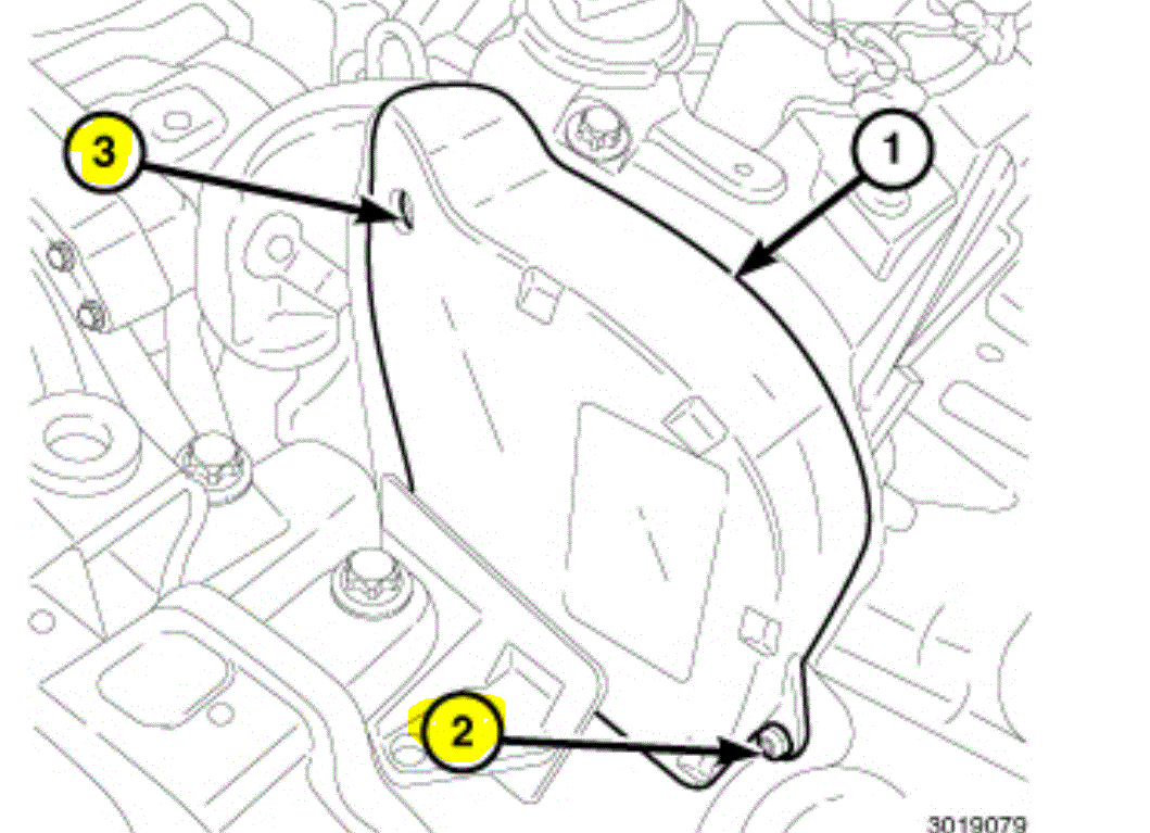

This is an interference engine. If the timing belt broke, it would likely have caused internal engine damage such as bending valves in the cylinder head. That would cause a no compression issue. With that, I recommend removing the timing belt cover and inspecting it to see if it is broken or damaged.
I attached three pics below. Pics 1 and 2 explain what to look for if the belt has not broken. Pic 3 shows the upper timing belt cover. There are two bolts that hold it in place (I think 10mm). Remove the bolts and then the plastic cover to access the belt.
See pics below.
