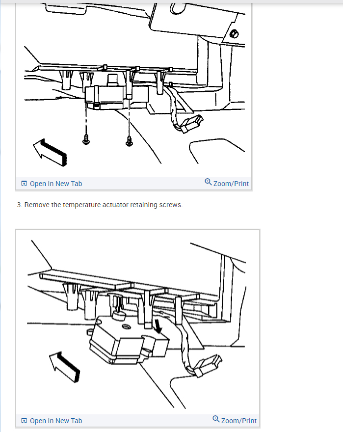

Is it the left side not getting hot?Usually the left blend door actuators go out on those trucks.
Apr 30, 2021 at 2:49 PM (Merged)

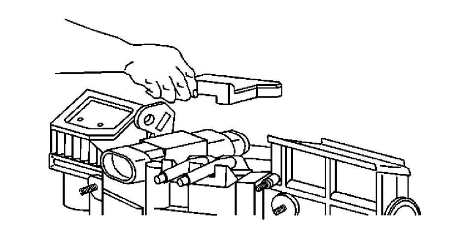

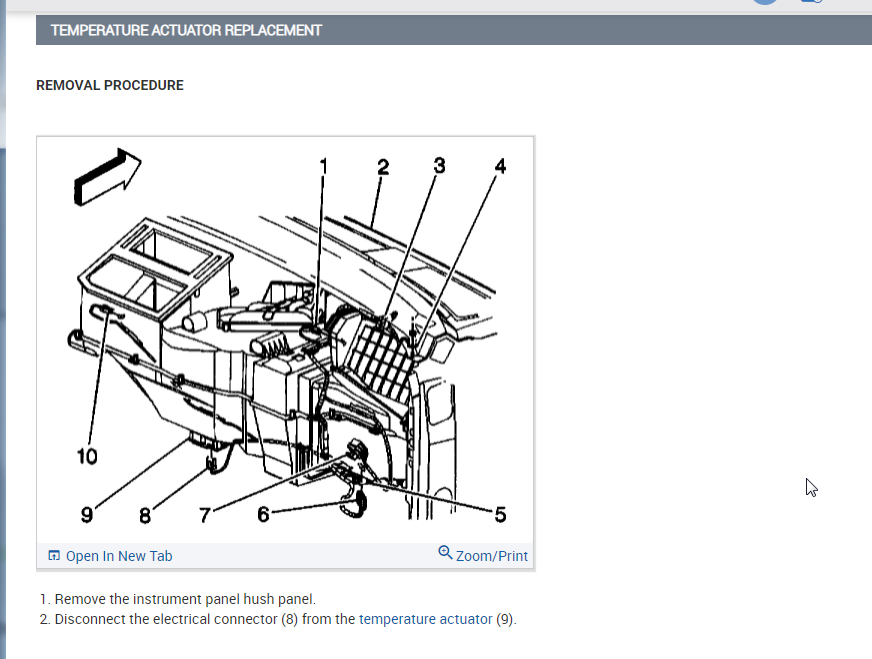

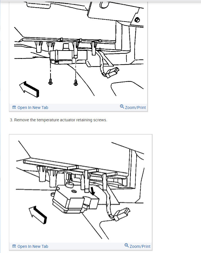

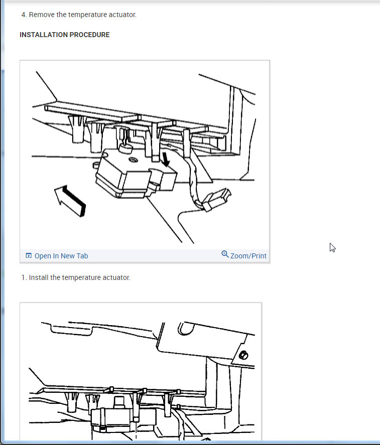

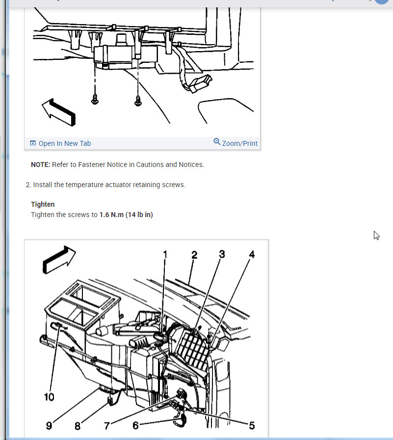

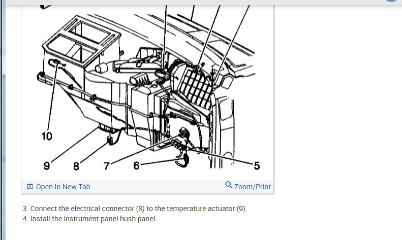

This is correct that the blend door is most likely the issue. Below is the info from the manual on how to replace this. Please run through this material and let us know if you have other questions.
Here is a guide that will help with this as well:
Below is the info from the manual. Thanks
