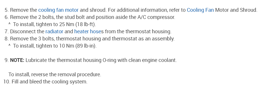

My car engine overheats on driving a short distance. The check engine light is always on when I start the engine. But I noticed a coolant leakage around the pulleys, but radiator fan is always on. On parking I find coolant splashed on the bonnet so what is the probable cause?
