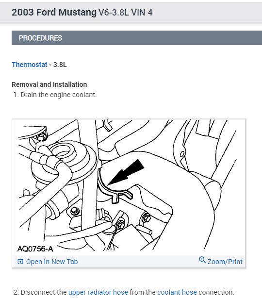

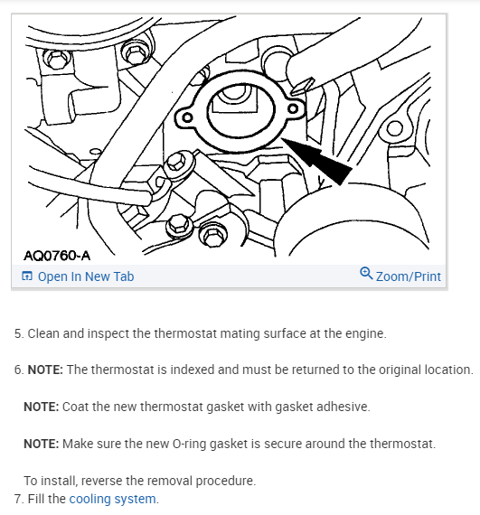

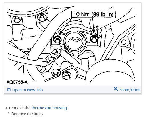

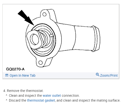

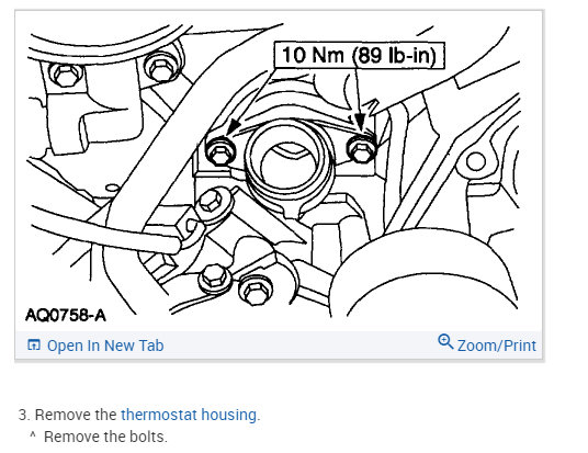

Also, I attached the directions below specific to your vehicle for replacing the thermostat. Do this at the same time you flush the radiator.
Let me know if this helps or if you have other questions. As far as the cooling fan, we will focus on that next.
See pics below.
