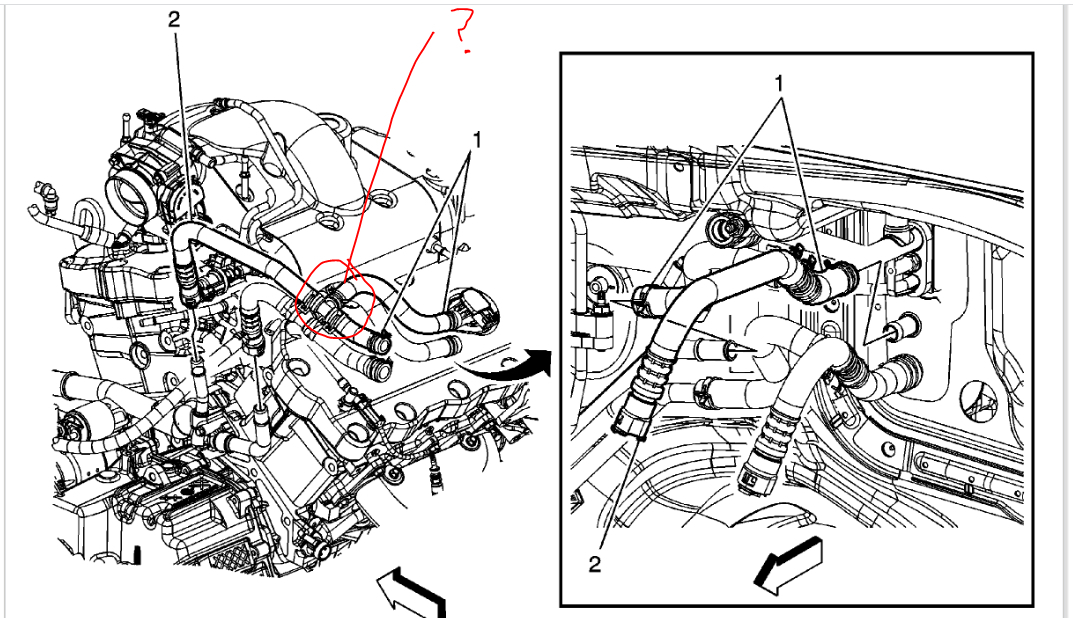

Based on what you are saying, it sounds like it could be a heater hose supply. Does the vehicle have rear heating and AC?
Do me a favor. Take a look at the pics I attached below and let me know if that is what you referring to. If you can take a pic of the damaged part and upload it for me to see, that would help.
If it is a plastic three-way connector, take it to the parts store with you and see if you can just get the connector. If you purchase the entire unit, it gets expensive.

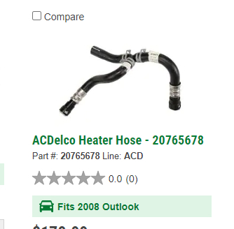

Thank you so much for your expertise. That part was exactly what I was talking about, and so yes, I took the part to O'Reilly's, and they were able to recommend a universal Tee shaped connector because I guess they don't sell just that part by itself. You either have to buy the whole Heater Core Hose Assembly, which was all 3 hoses already connected to the Tee, or just a hose. Well, thank God for universal things because the entire assembly was about $172, but I only paid $5.99 for the universal part, and it worked. No more coolant leaks, and no more overheating. My car is back to normal thanks to your excellent advice. Thanks again.
May 21, 2023 at 10:58 PM
You are very welcome. I'm glad to know it's fixed. And yep, the assembly was very expensive. Interesting that adding three dollar's worth of heater hose can cause the price to go so high. LOL
