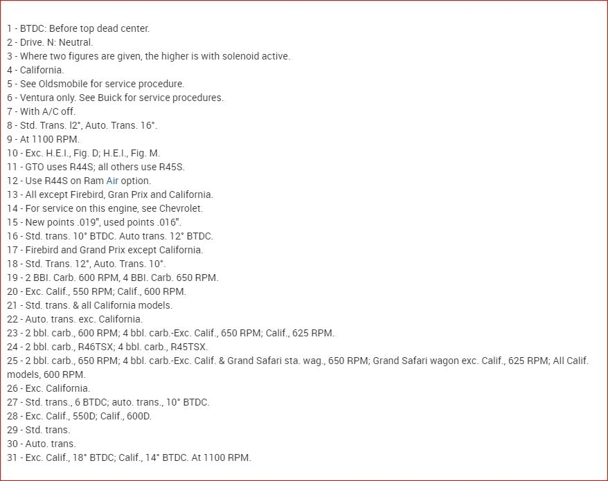

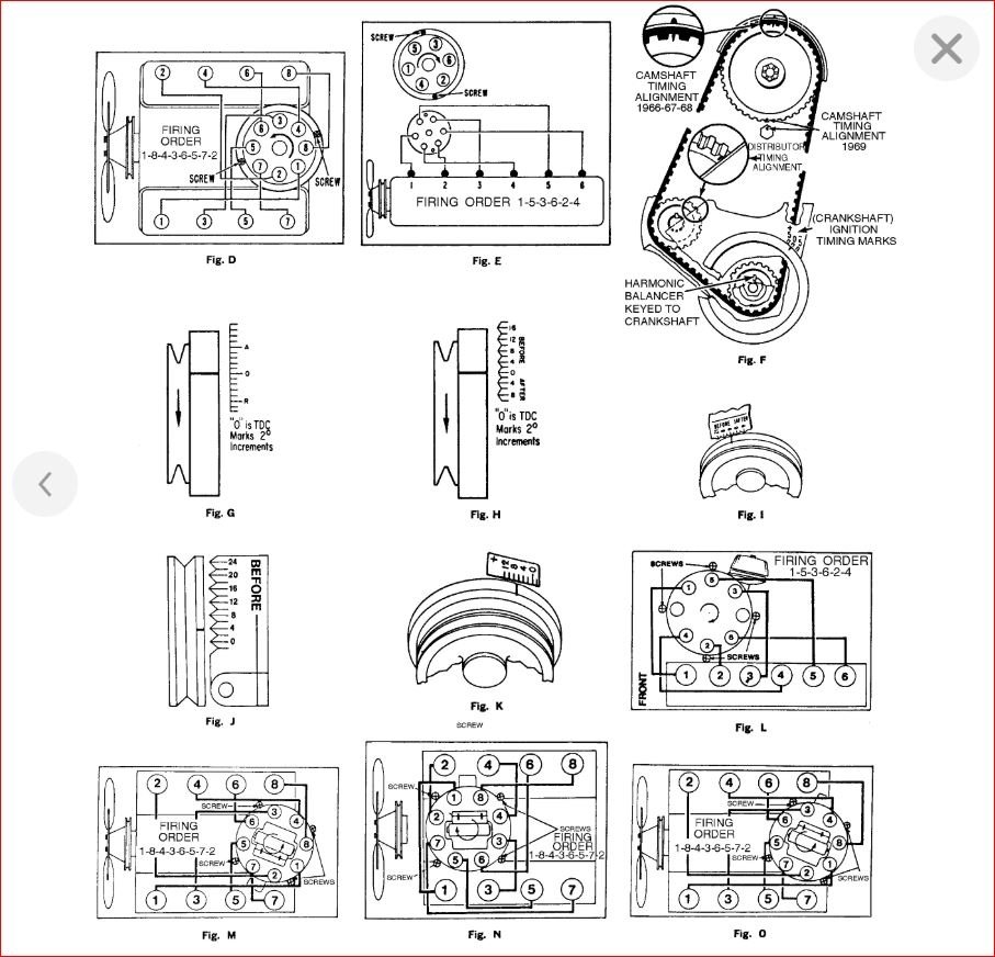

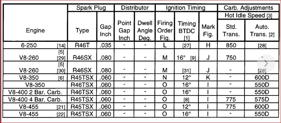

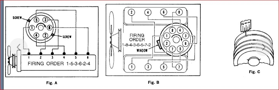

Yes. This is exactly correct.
Here is a video that takes you through the entire process. They get very detailed but the important thing you need to follow is how to set the light up, how to check the base timing (idle/initial), then how to adjust the timing by moving the distributor.
One important thing when setting your base timing is to remove your vacuum line from the distributor. This is the vacuum advance and will effect your setting so you want this unhooked.
Once you set your base timing, the advance will take care of itself. I suspect that your base timing in low which is causing your total timing to be low which is why you are overheating while driving down the road.
There are video on the internet of guys setting timing on your engine but they were pretty amateur so I didn't want to recommend them on how to do it. However, feel free to look at them to show where all these components are on your specific engine.
https://youtu.be/UYGU7mTwsZc
Hopefully this helps. Please let me know if you need more assistance with this and I will help how I can. Just a tip. If you don't feel confident doing this, then I wouldn't attempt it by yourself. You can probably find any senior mechanic and ask them to show you how to do it and I am would think they would. They may charge you to do it but I am sure they wouldn't mind teaching you if you ask. At least, I know I would and I am sure there are others that will as well.
