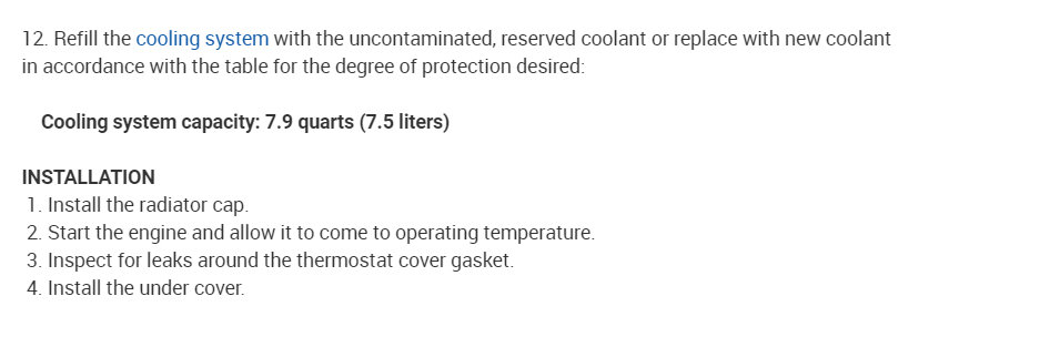

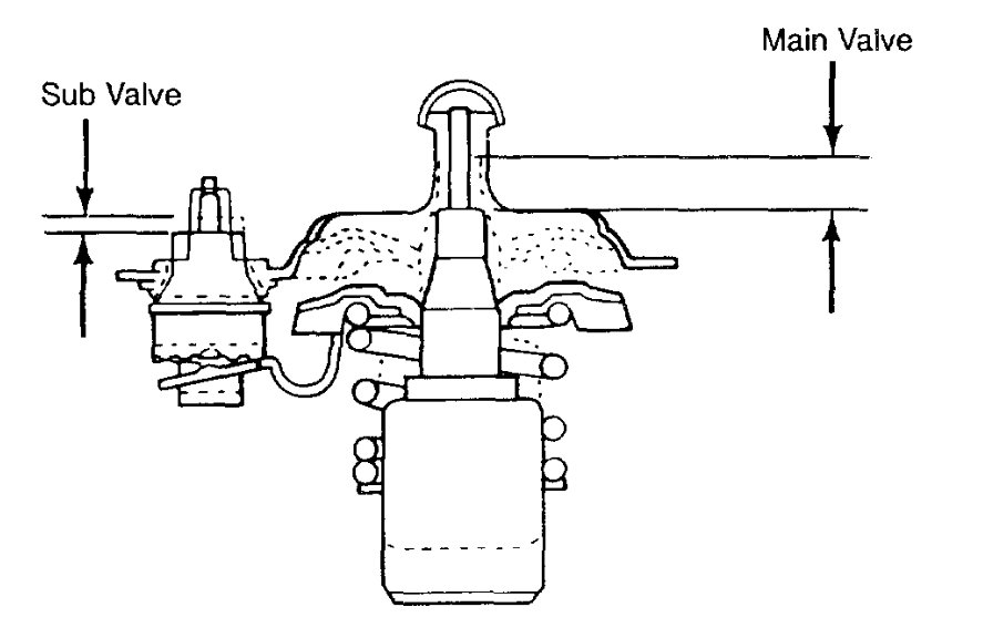

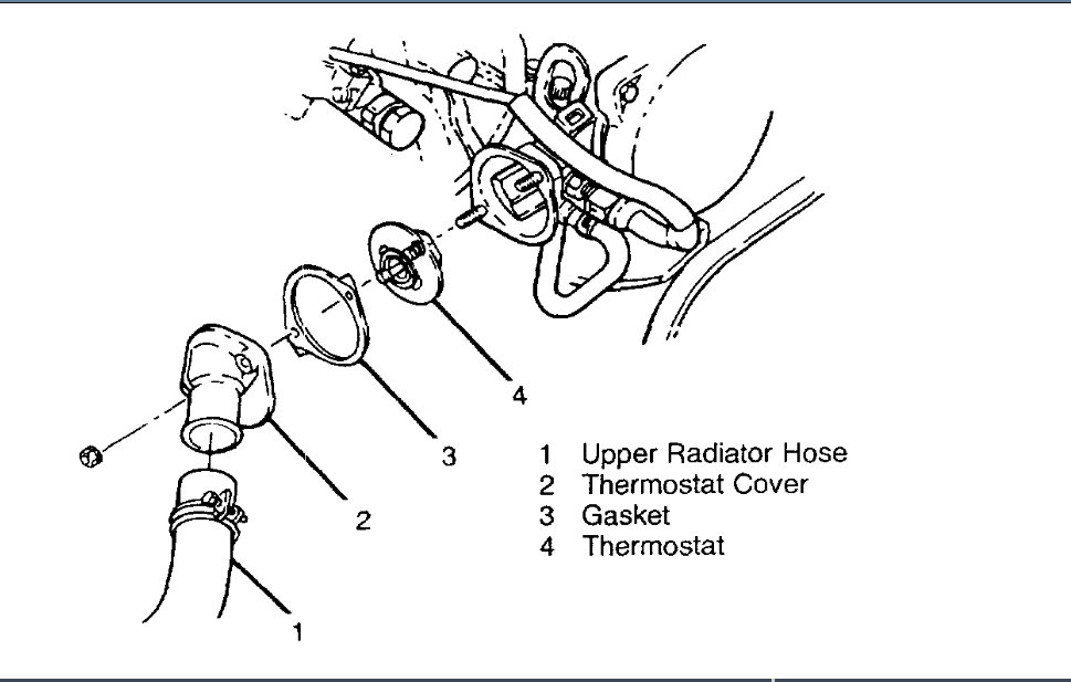

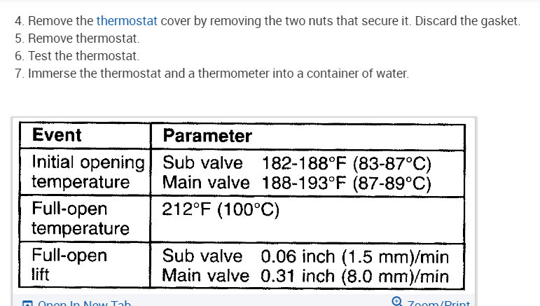

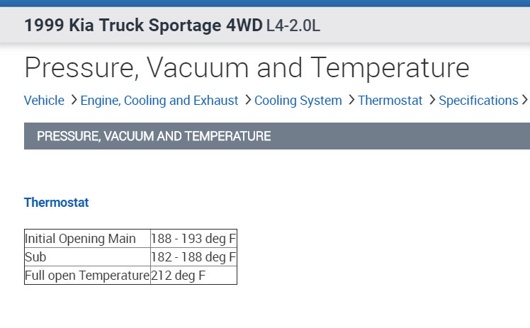

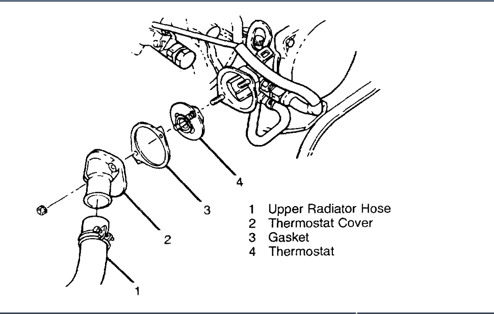

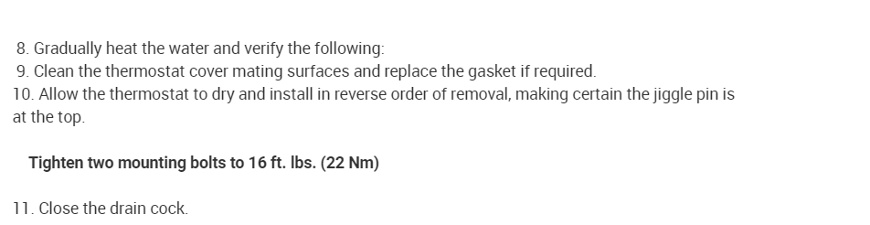

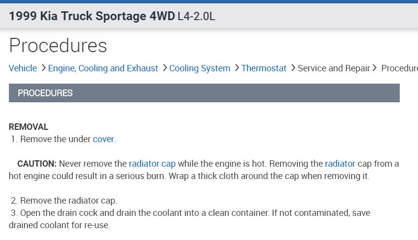

This could be a problem with your vehicle's thermostat starting to stick. Your vehicle has a thermostat in it that is designed to open at a certain temperature and let the coolant circulate to pull the heat away from your engine. If the thermostat is sticky, starting to fail, it could fail in the closed position, not opening, and causing your vehicle to overheat because it will not allow any coolant to circulate around the engine. I have included the thermostat specs and directions for the removal and installation of your vehicle's thermostat in the diagrams down below. I have also included a couple of links below for you to go to:
https://www.2carpros.com/articles/how-an-engine-thermostat-works
Please go through these guides and get back to us with what you are able to find out.
