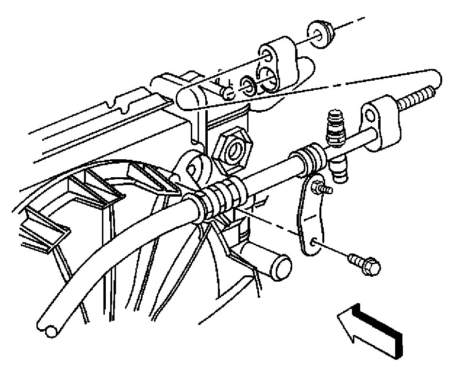

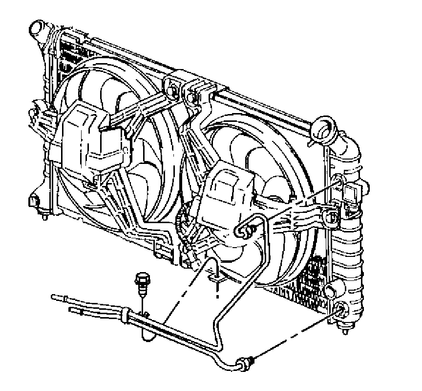

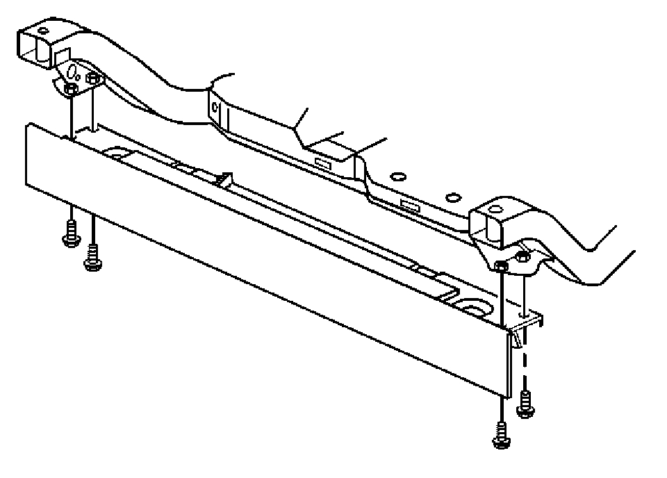

Here are the directions specific to replacing them for your vehicle. The attached pics correlate with the directions.

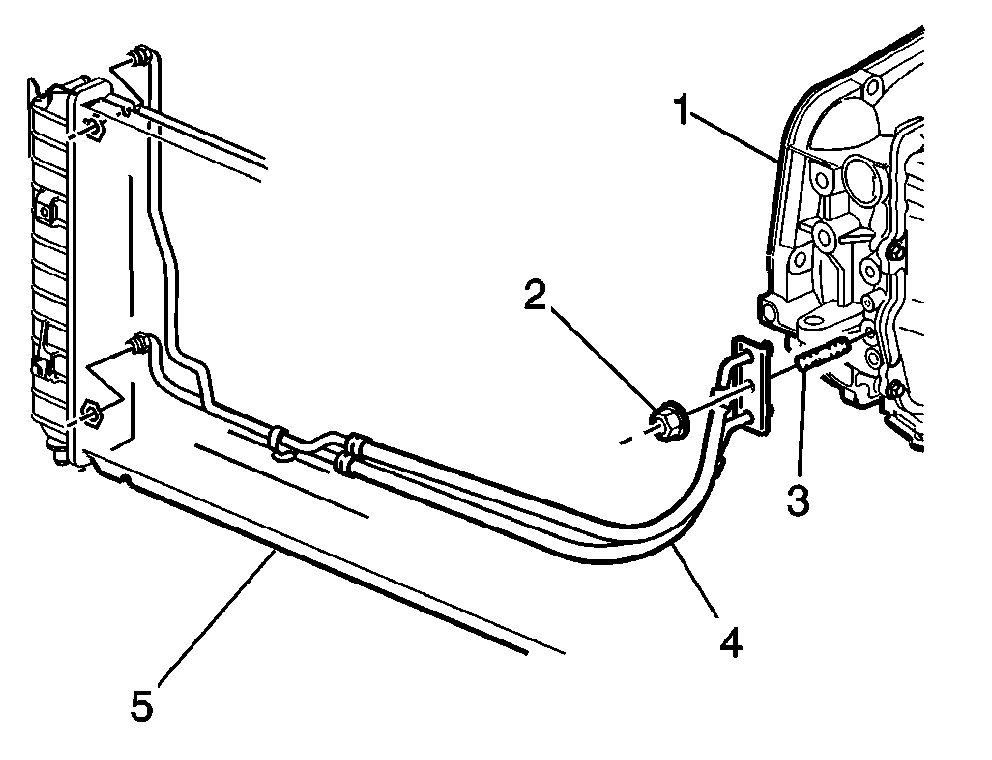

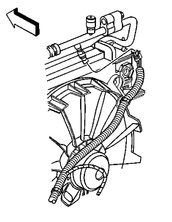

pic 1
1. Remove the upper transaxle cooler line from the radiator ONLY.

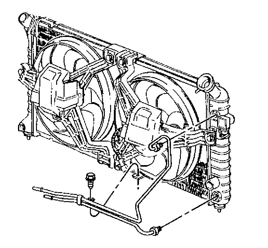

pic 2
2. Remove the discharge hose to cooling fan shroud bolt ONLY.

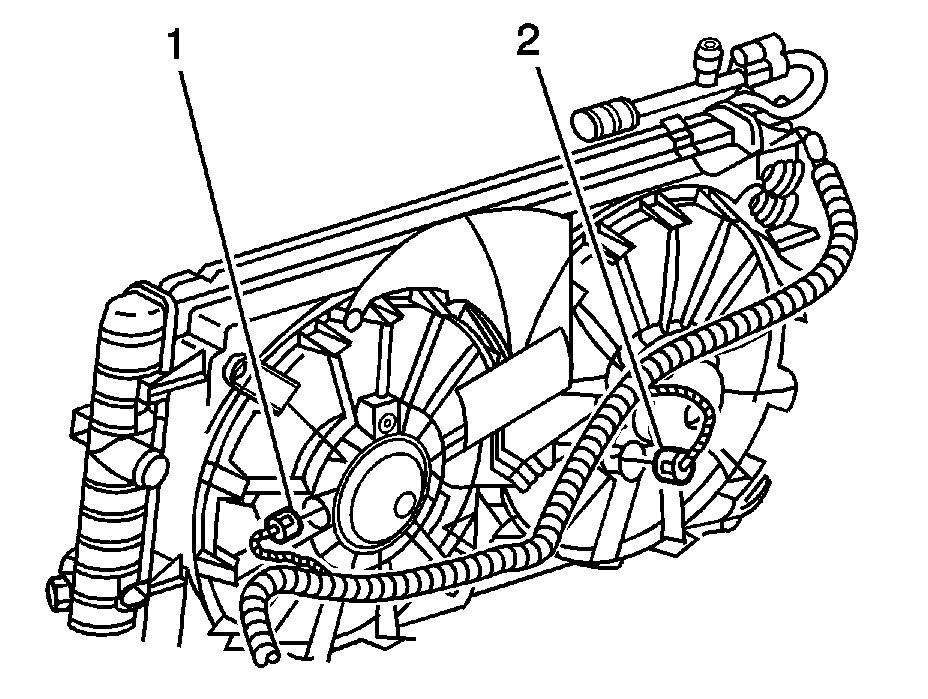

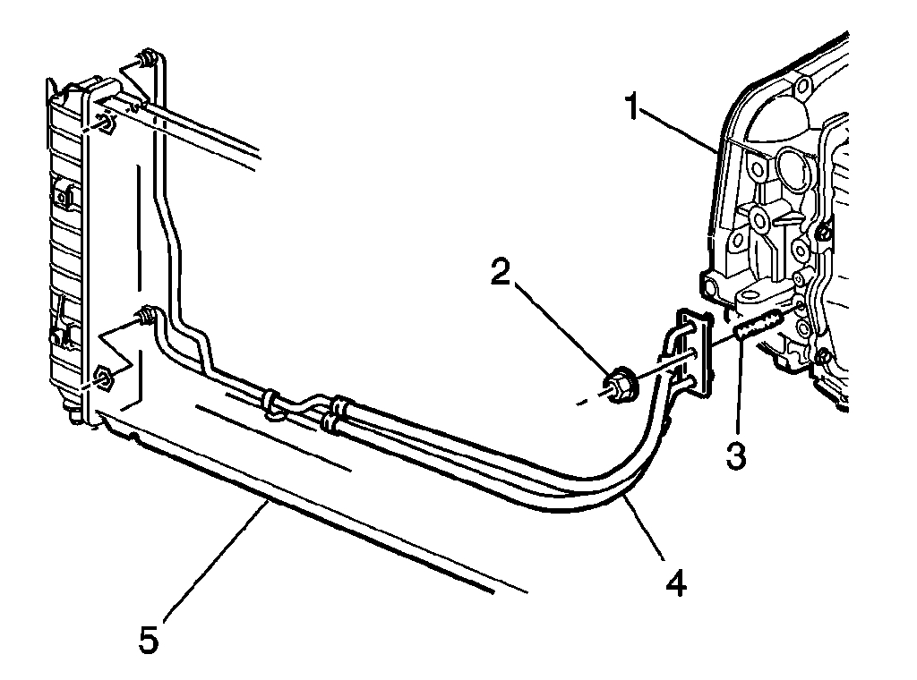

pic 3
3. Disconnect the cooling fan electrical connectors.

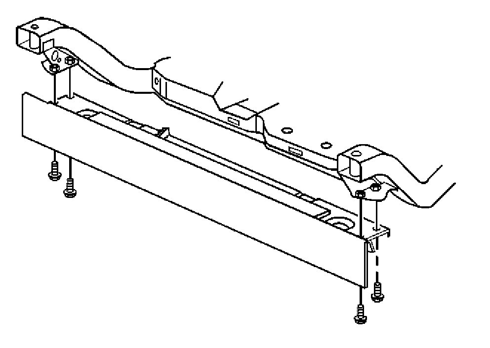

4. Raise the vehicle.
5. Remove the lower closeout panel.

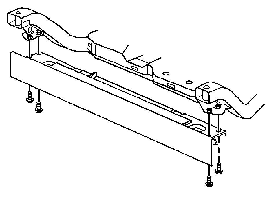

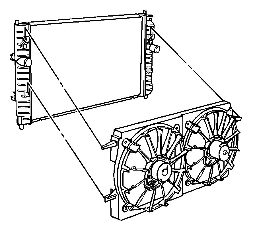

pic 4
6. Remove the lower transaxle cooler line from the radiator.

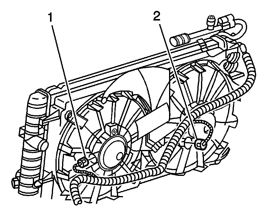

pic 5
7. Remove the lower radiator support mounting panel.

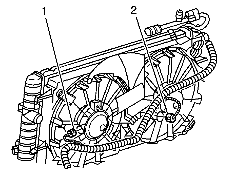

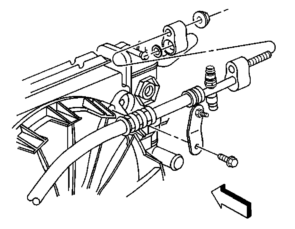

pic 6
8. Reposition the transmission oil cooler lines away from the fan shroud.

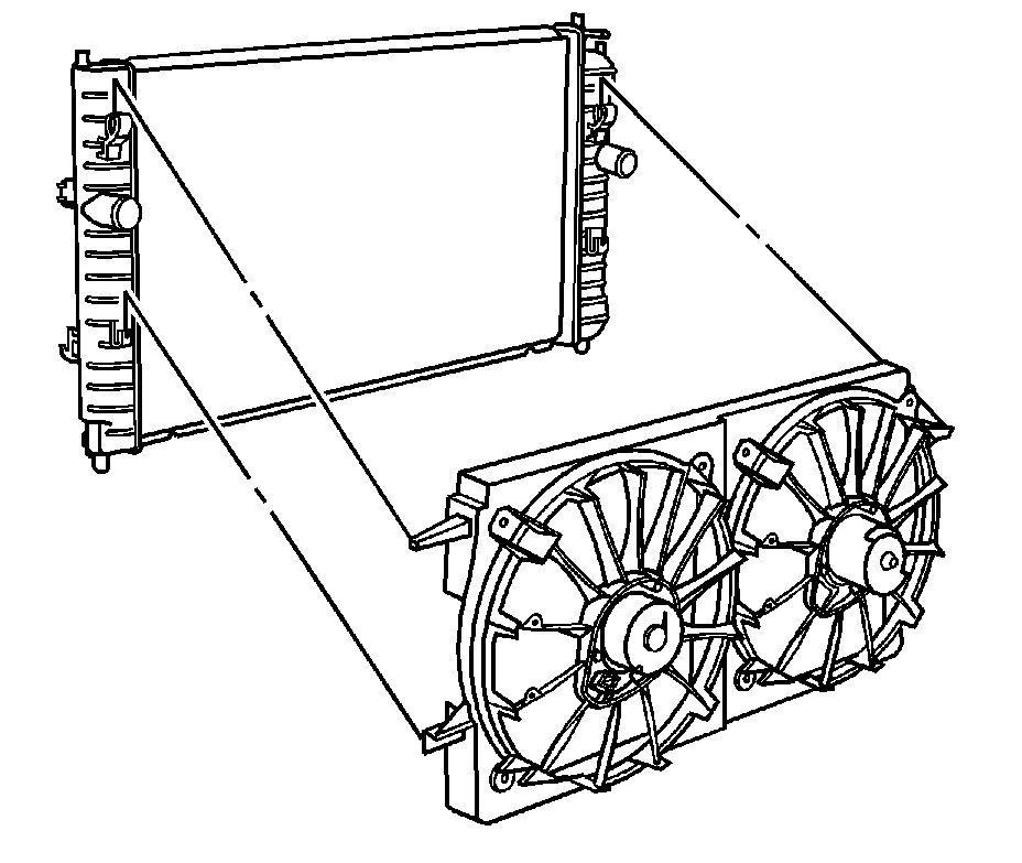

9. Push up on the cooling fan to remove the cooling fan shroud from the radiator.
10. Remove the cooling fan from the bottom of the vehicle.
