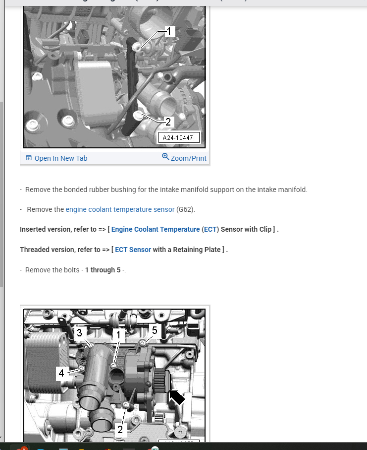

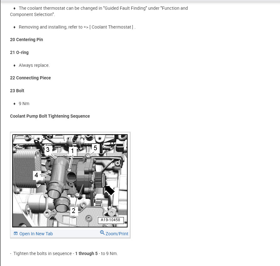

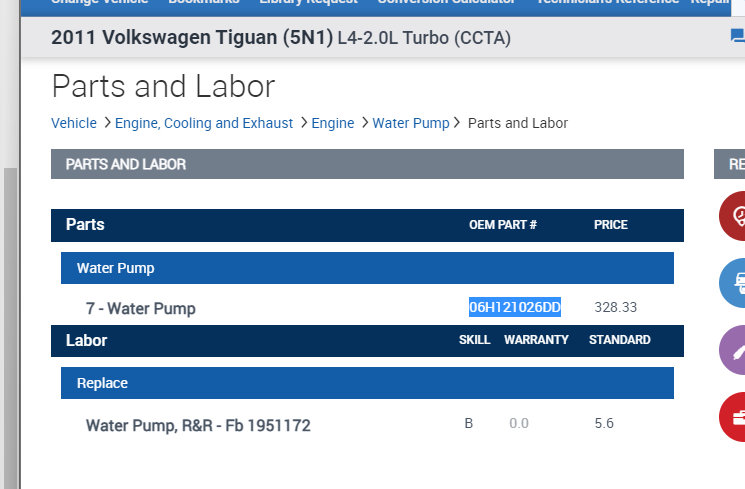

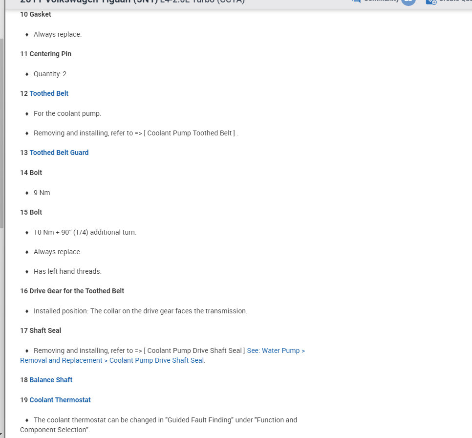

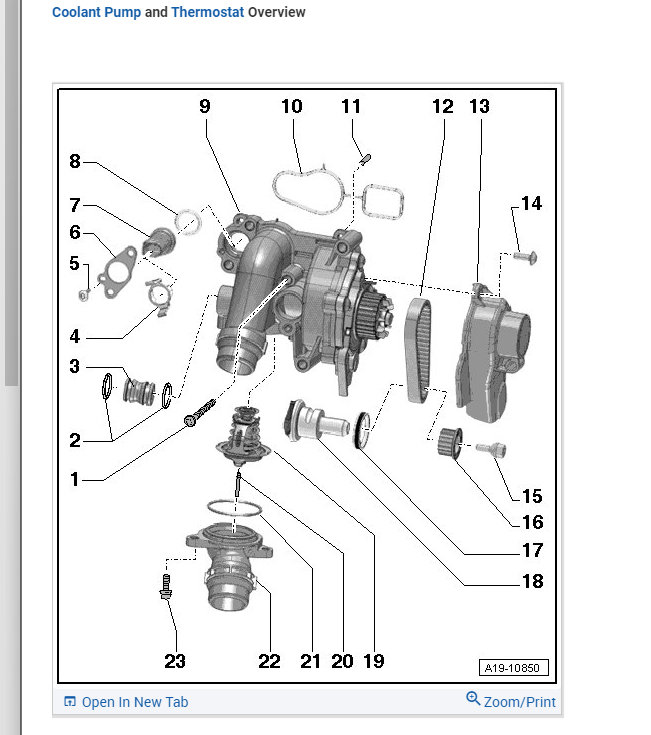

Can you take a look at this diagram? I assume you are looking at number 18.

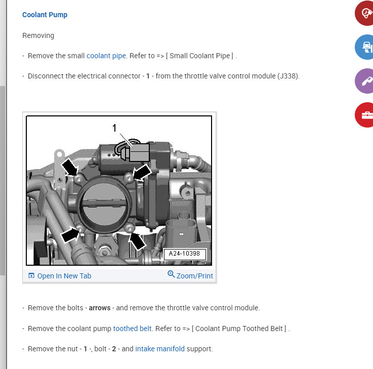

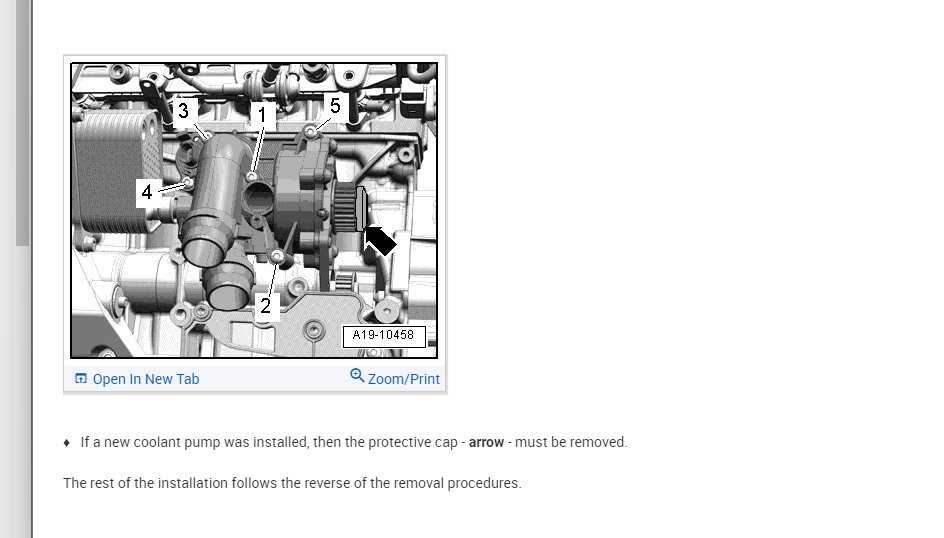

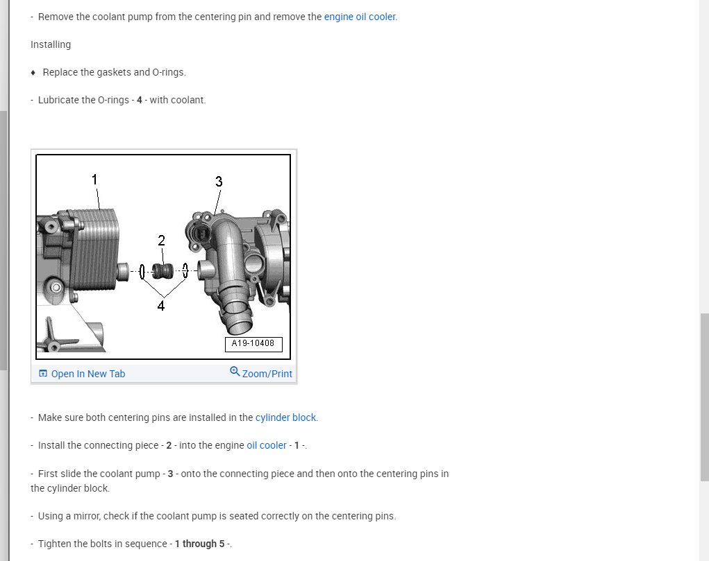

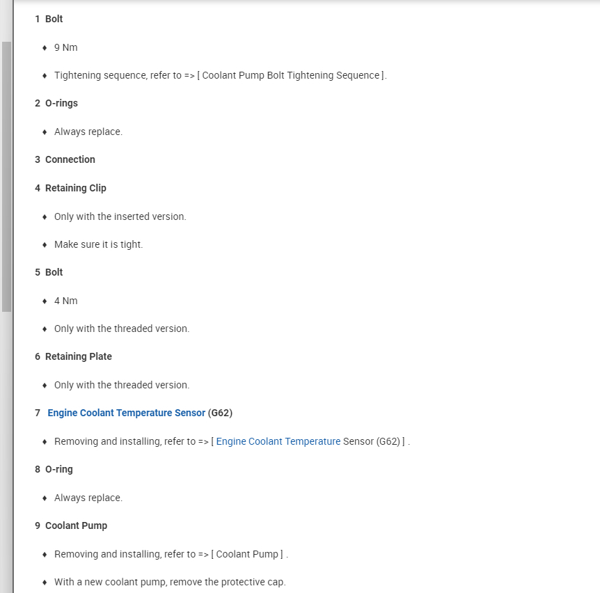

We don't have a process in the manual on how to remove this shaft specifically but instead on how to replace the pump.
I am attaching this process as well for your review.
