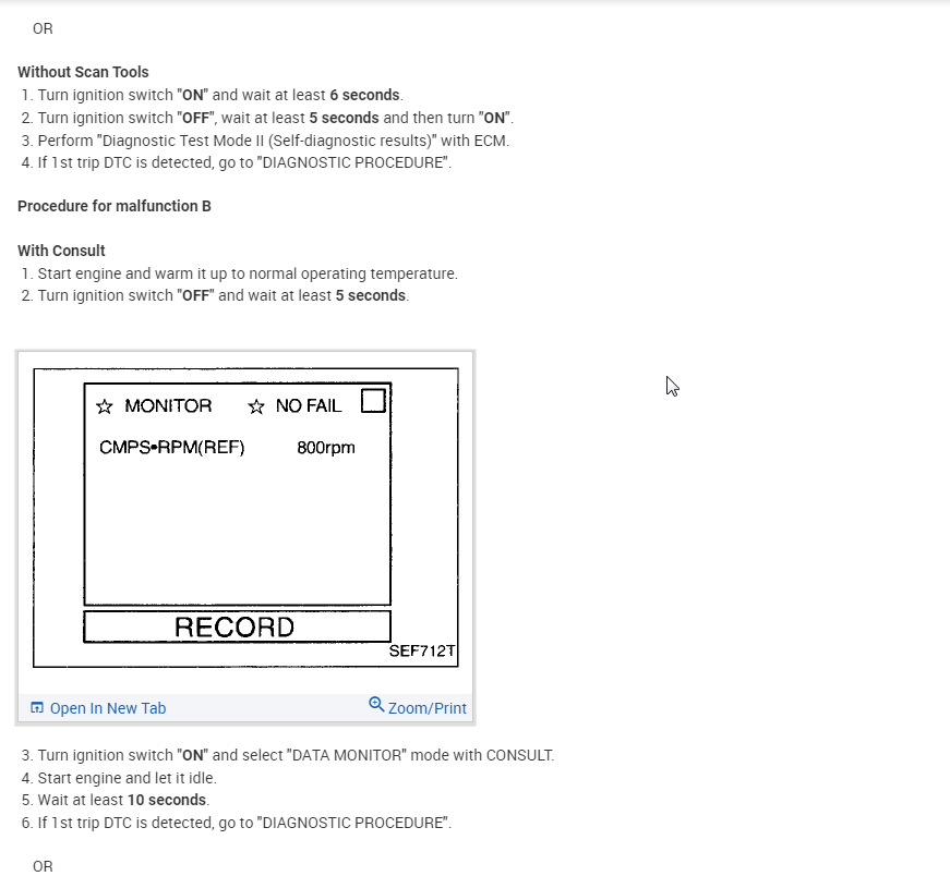

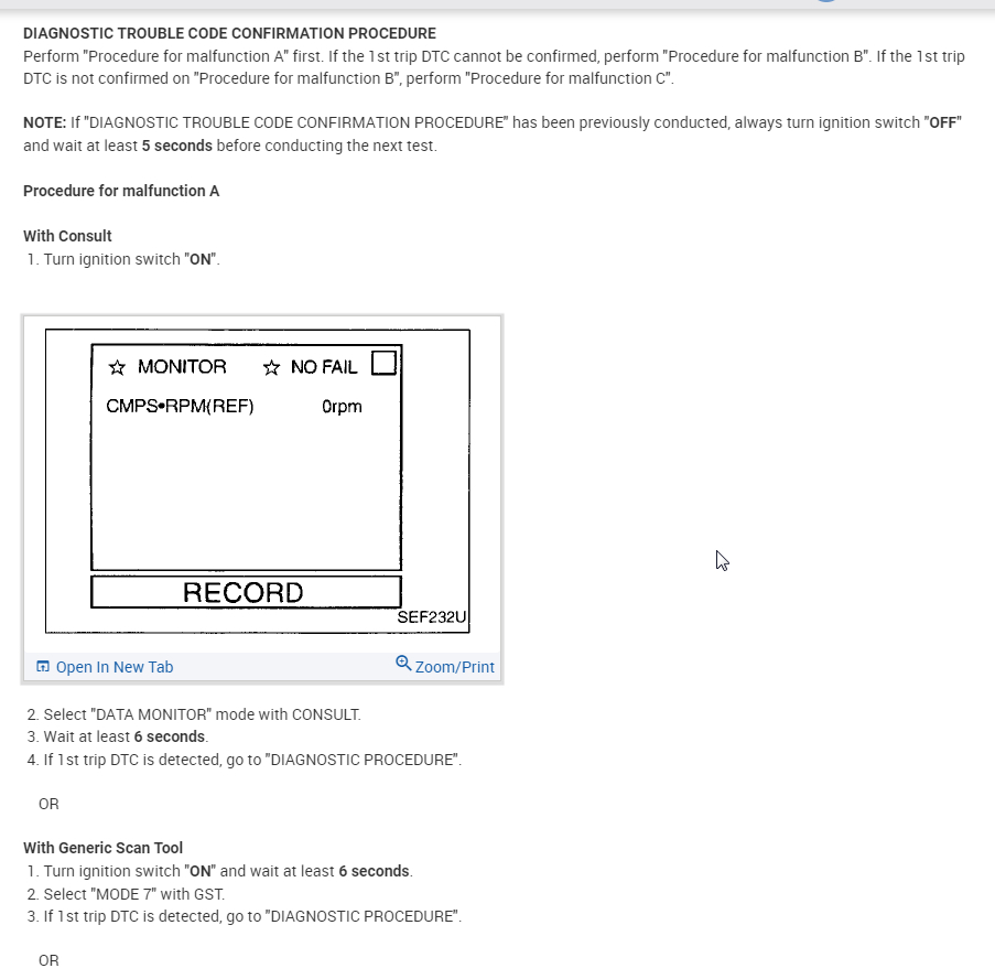

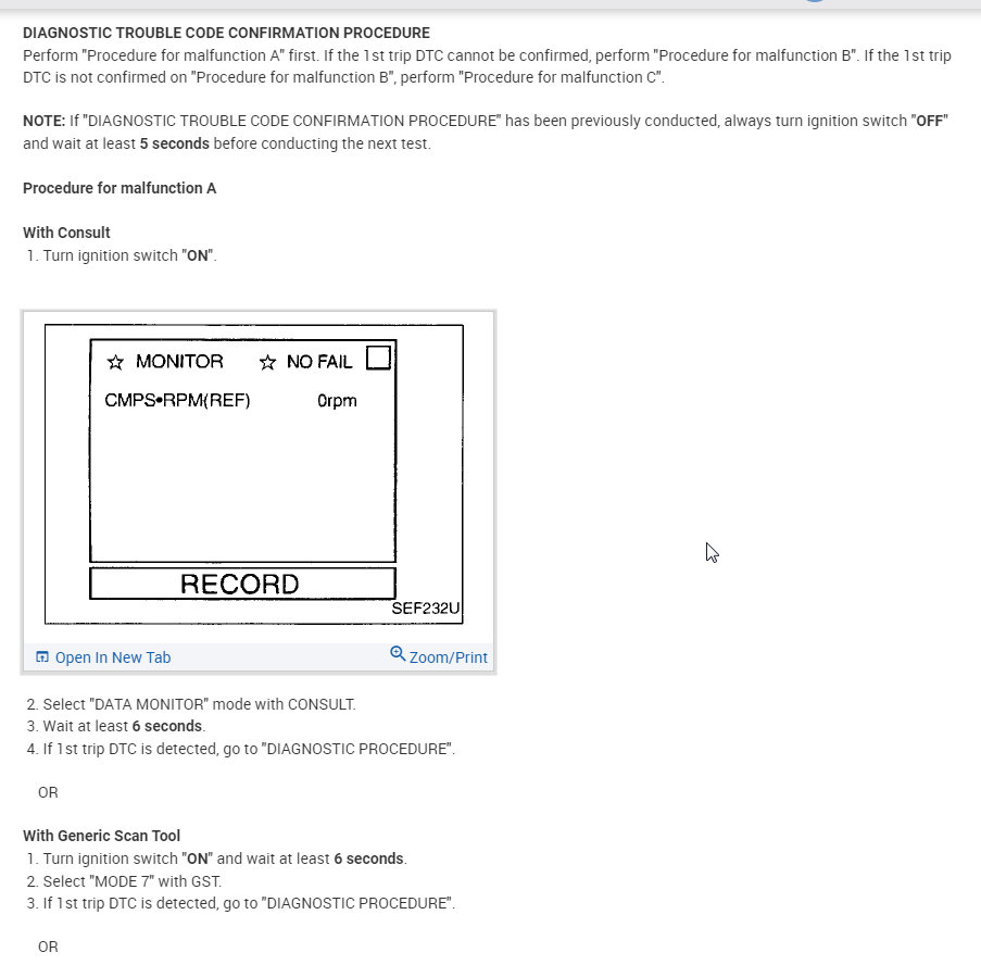

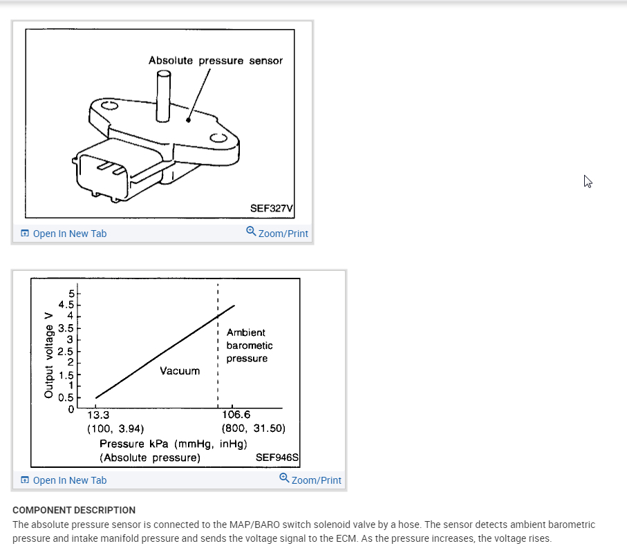

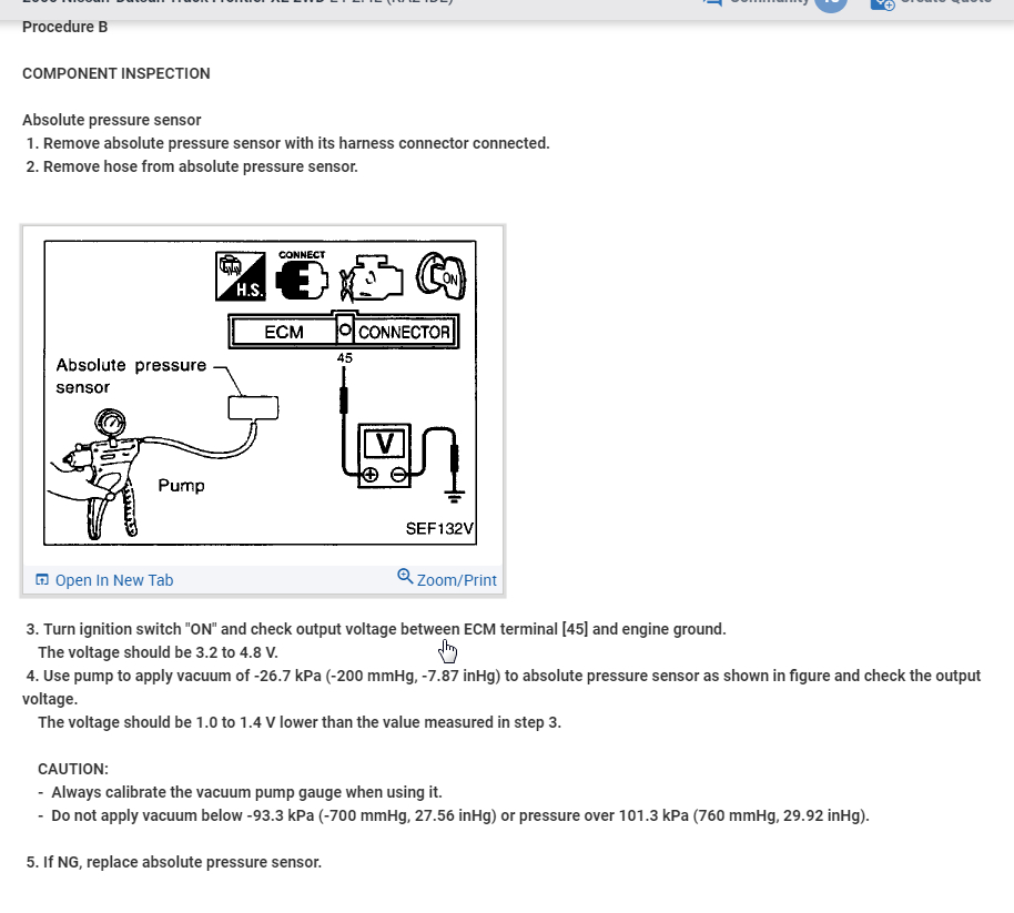

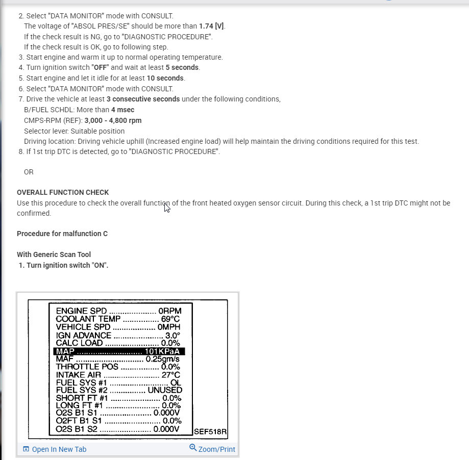

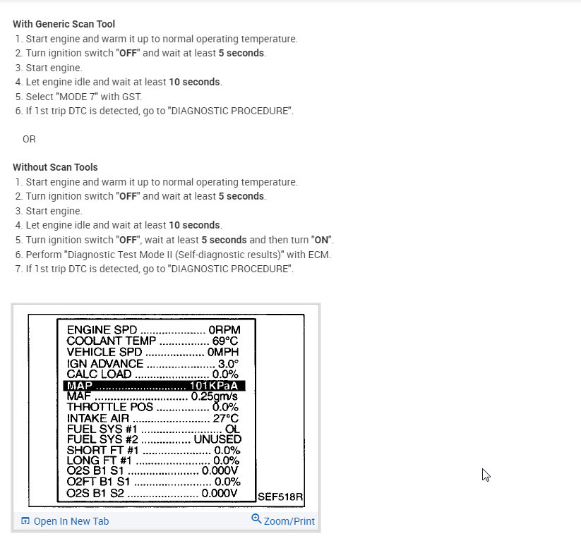

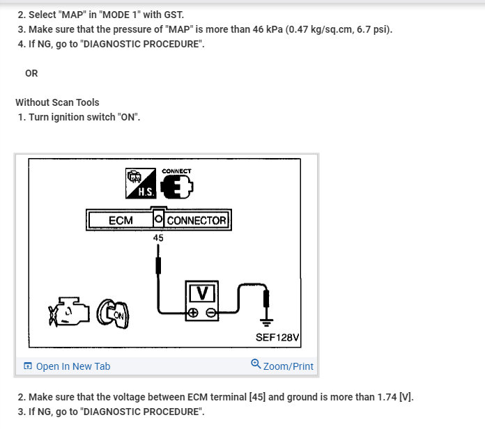

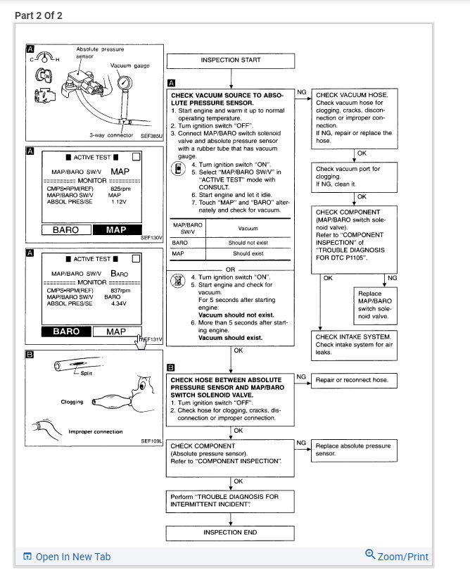

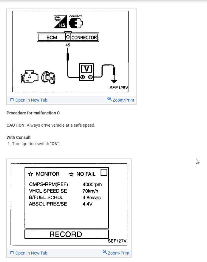

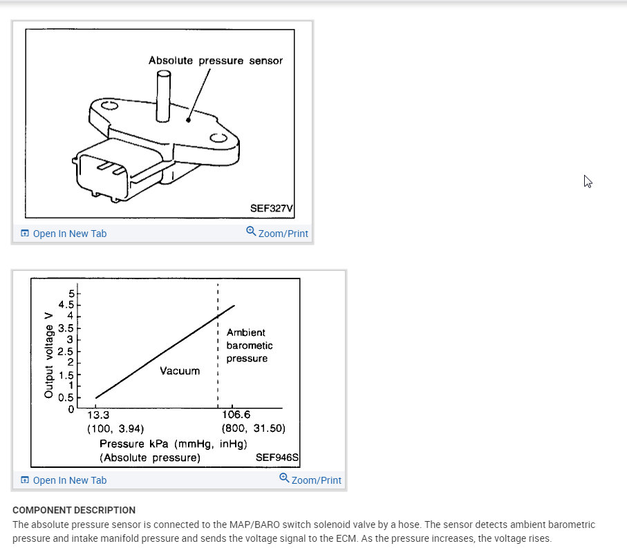

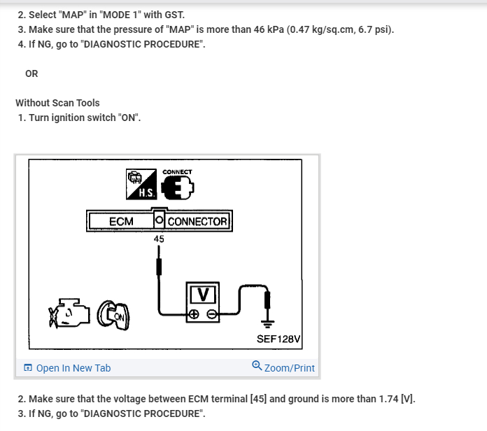

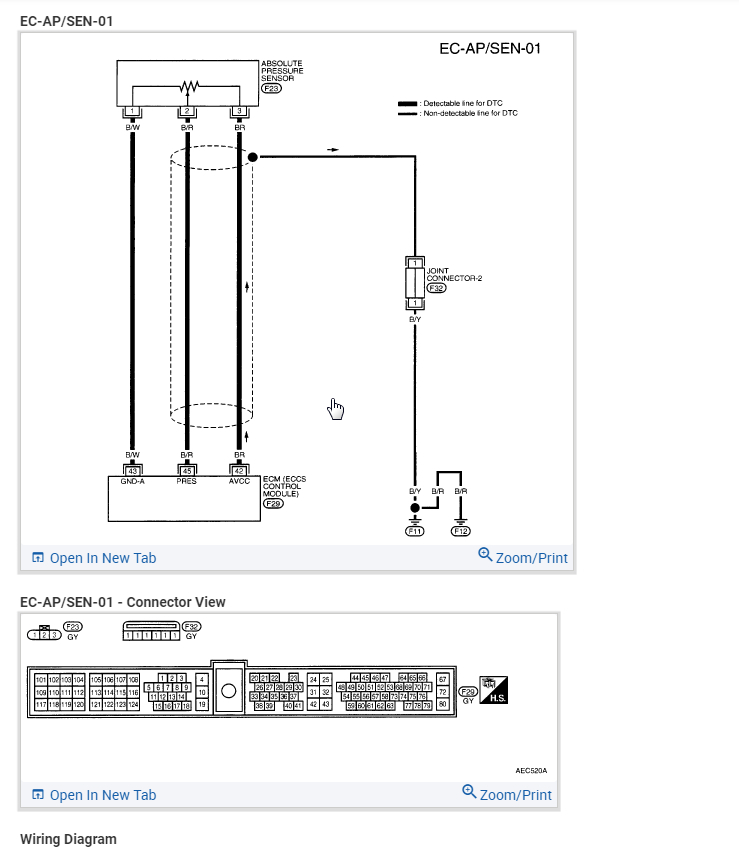

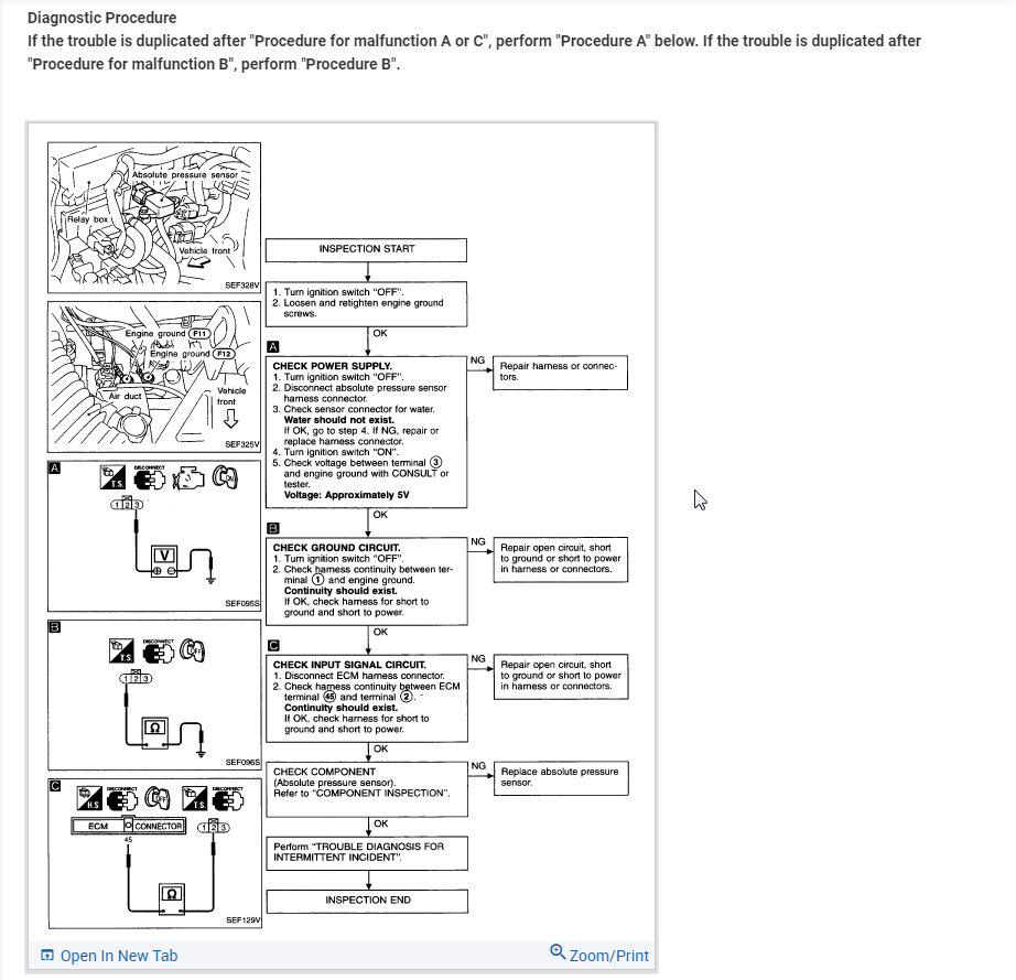

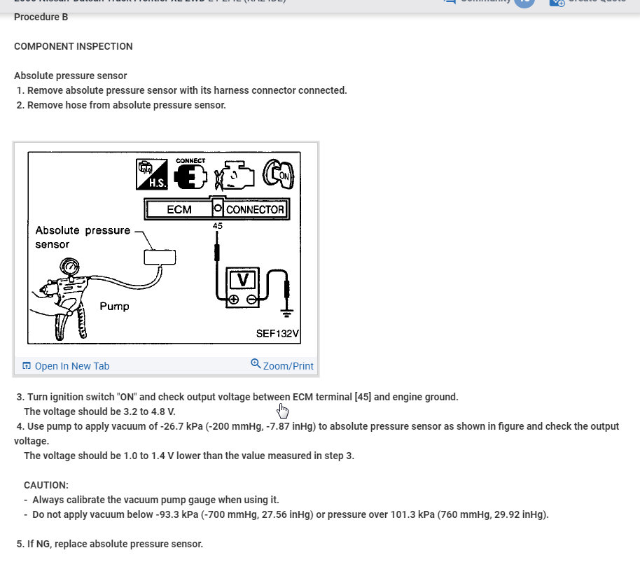

Attached is the diagrams for the MAP sensor. I suspect if you fix this one, it will fix the other codes as well. However, let's keep this post to the overheating issue. If you want to tackle these codes then let's get a new post started because we need to keep it to one topic per post so others can find any answers we come to for each issue. They won't know to look for a MAP sensor issue under an overheat heading.
