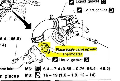

I changed or replaced the thermostat at the engine block is there more the one thermostat or just the one? my car is still running hot and not sure why. i replaced the fans, the radiator, water pump, and now the thermostat. not sure what else it cold be.
Feb 16, 2021 at 10:29 AM (Merged)
Welcome to 2CarPros.
First, when you replaced the thermostat, did you place the jiggle valve at 12 o'clock? That is the position it need to be in for air to exit the system when refilling the coolant. You may have an air blockage if that wasn't done. See pic 1
Next, since you have replaced everything, don't get mad, but are you sure it is overheating and not a faulty coolant temperature sensor?

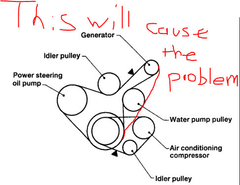

DREWINATOR69
I have this exact problem word for word. The issue ended up being the bbn previous owner had replaced the water pump. However when they put the serpentine belt they routed it outside the water pump rather than inside smooth side to smooth side belt. This causes the pump to spin backwards and basically does t circulate any water and pumps little water to the top of the radiator. Hope this helps someone.
Feb 16, 2021 at 10:30 AM (Merged)
Excellent addition to this thread! Please feel free to help out whenever you are on the site :)
DREWINATOR69
This was how my belt was put on by previous owner this causes the car to overheat in just minutes and also some very violent reverse boiling to the top radiator hose exactly as you described.
lol, yep that would cause a problem for sure, thanks for the input.
