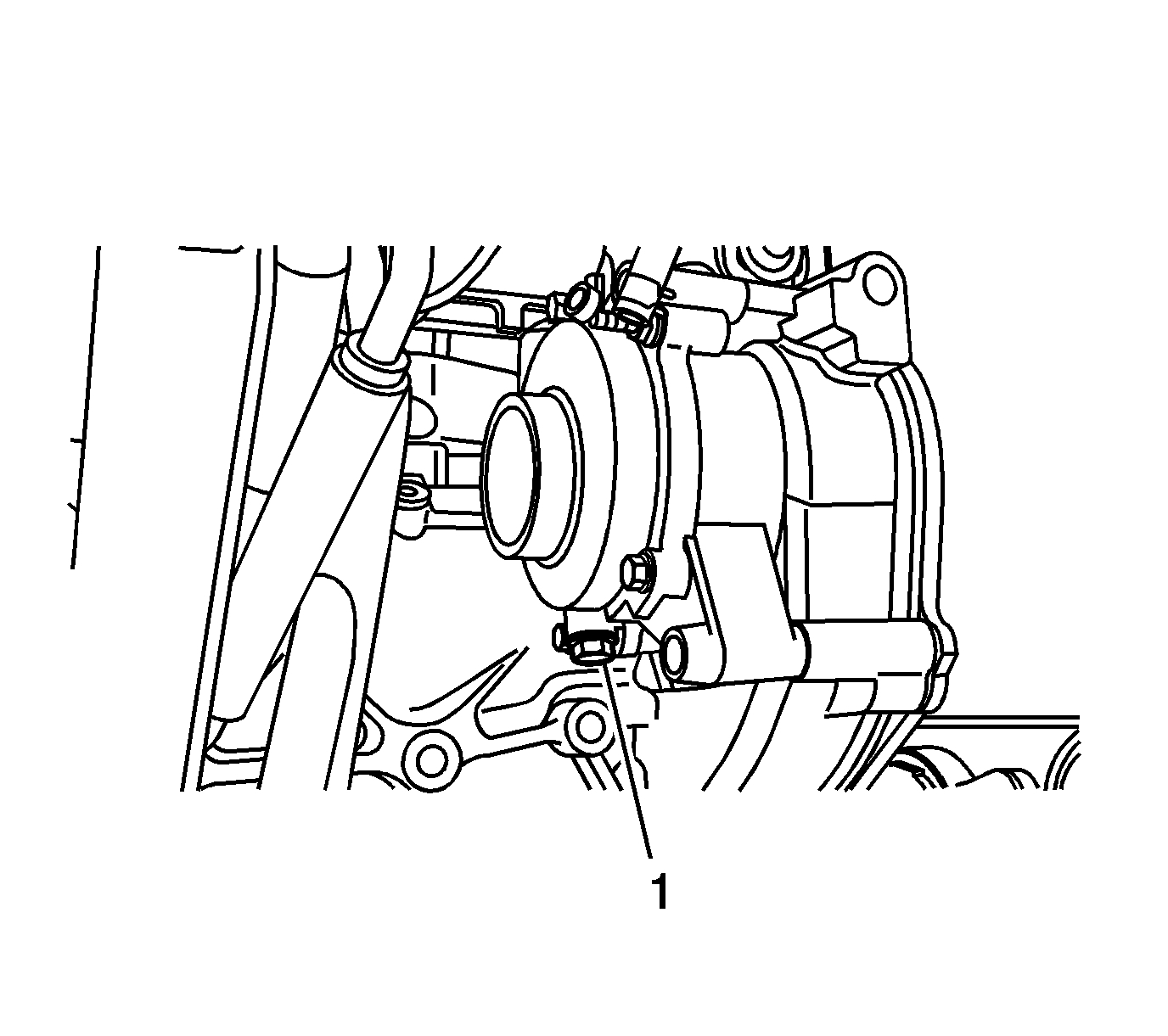

What you described with the heater makes me question if there is air in the system. Do me a favor, take a look at this portion of the coolant refill procedure, and see if it helps.
_____________________
Caution:
Refer to Fastener Caution See: Vehicle > Technician Safety Information > Fastener Caution.
1. Tighten the radiator drain cock to 2 Nm (18 lb in).
pic 1
2. Install the water pump drain plug and tighten to 10 Nm (89 lb in) if removed during the draining process.
3. Lower the vehicle.
4. Remove radiator inlet hose at the engine. Refer to Radiator Inlet Hose Replacement (LEA) See: Radiator Hose > Removal and Replacement Radiator Inlet Hose Replacement (LF1 or LFW) See: Radiator Hose > Removal and Replacement
