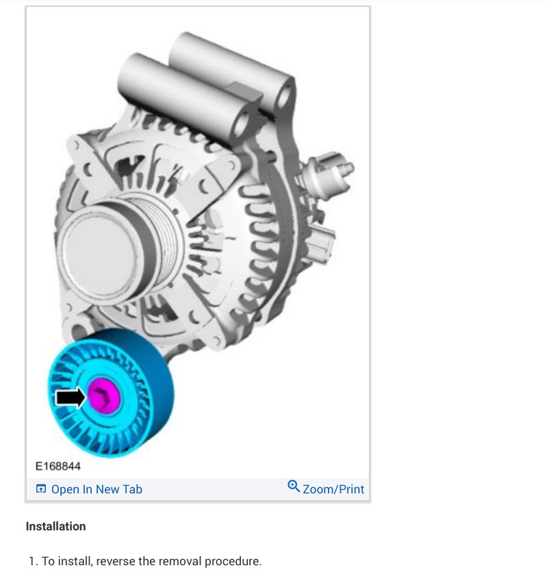

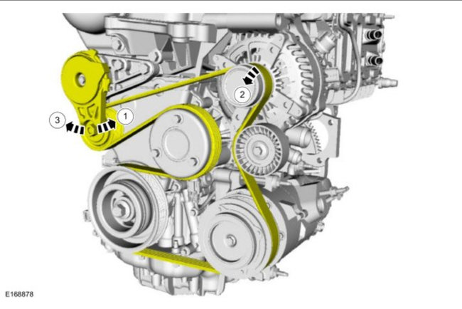

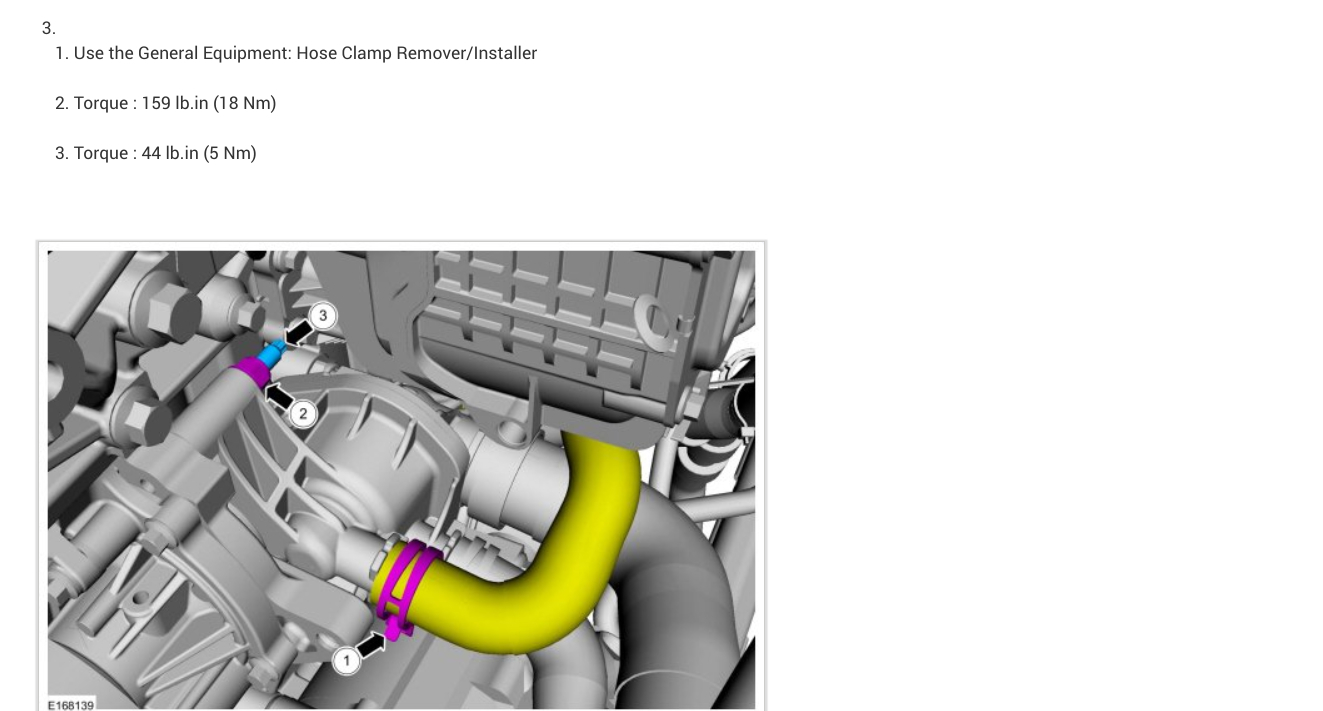

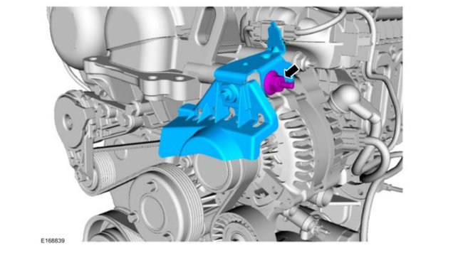

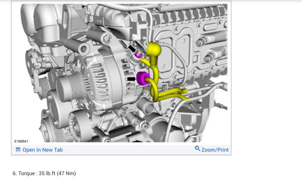

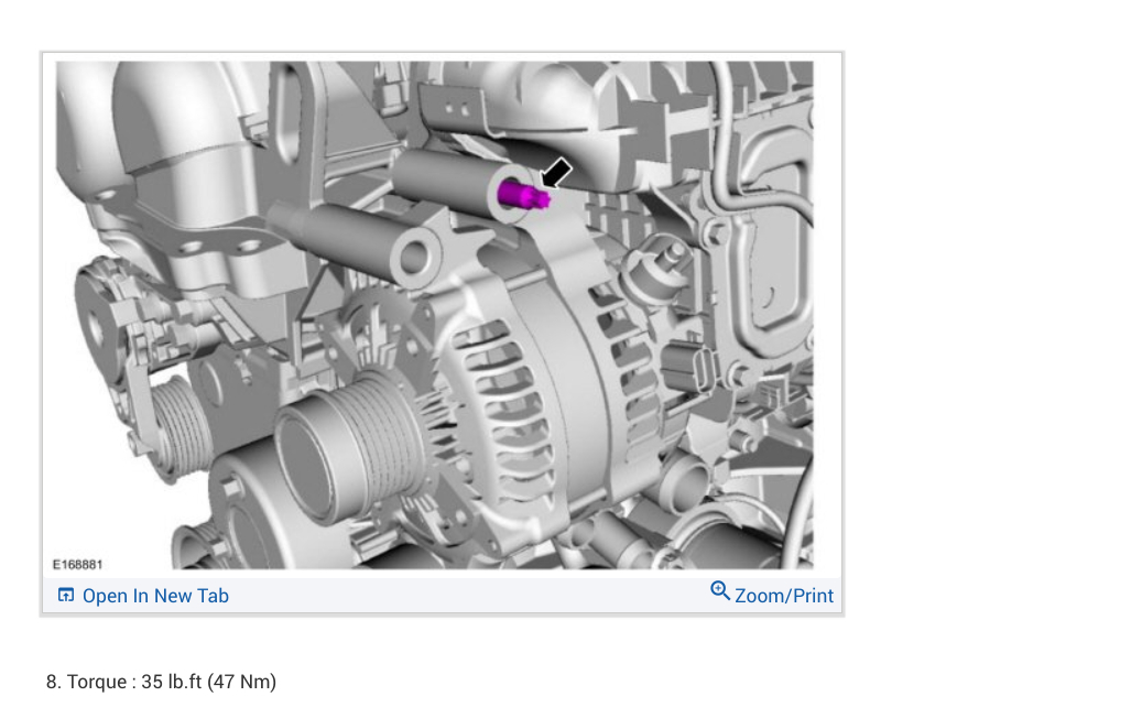

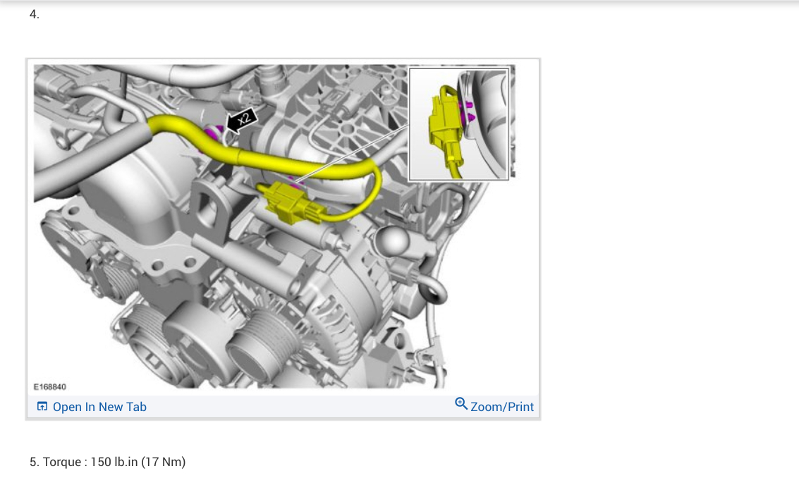

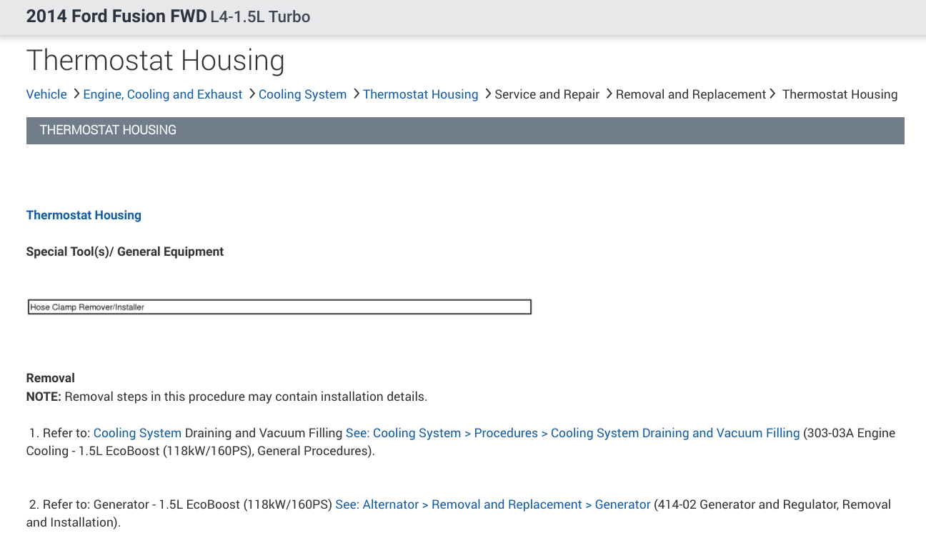

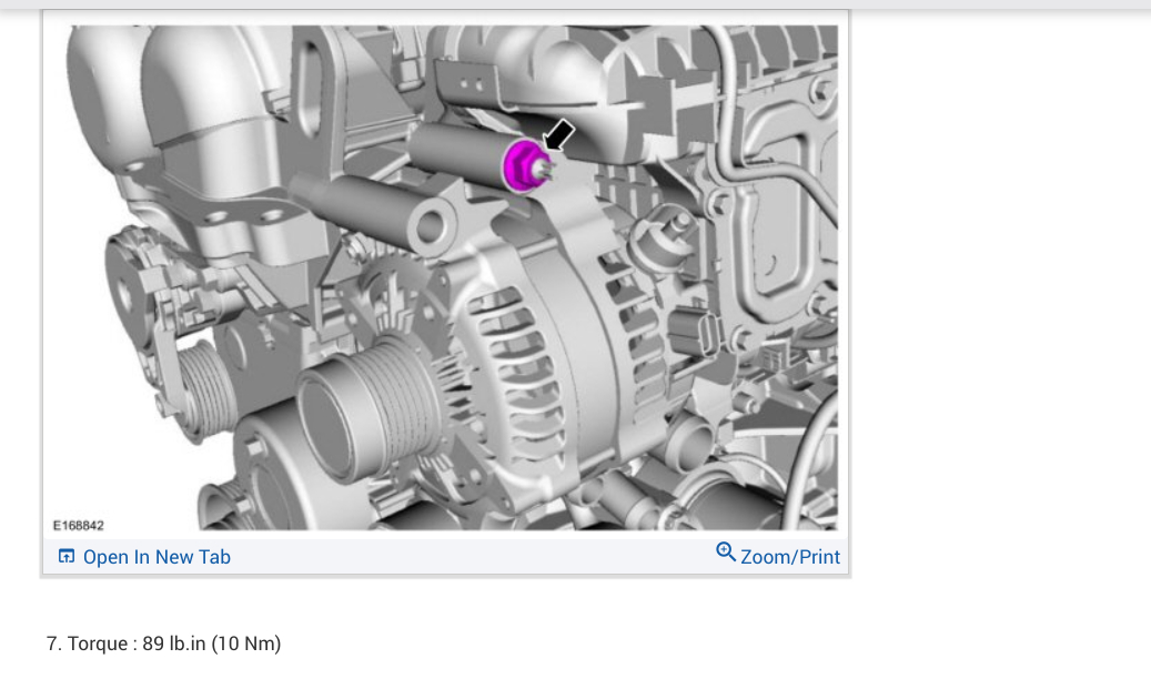

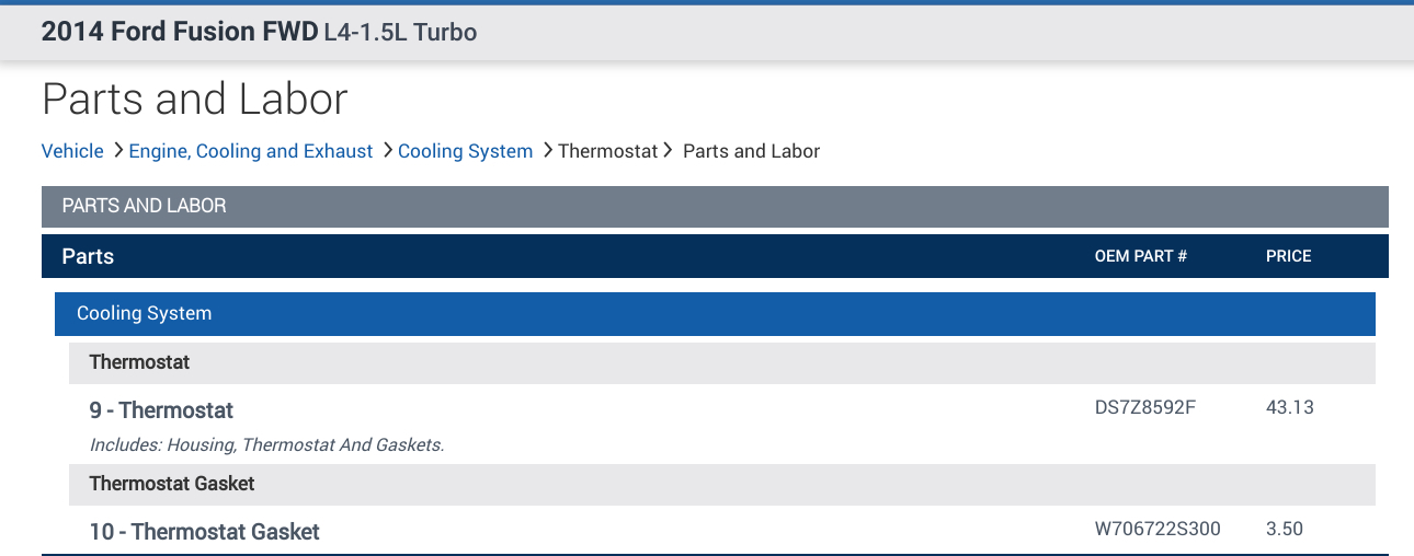

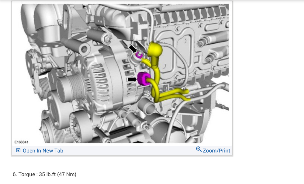

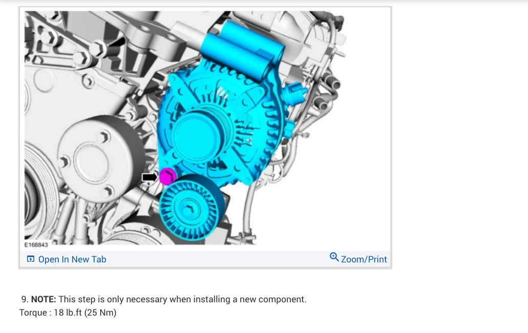

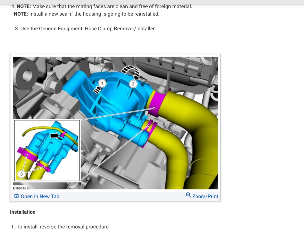

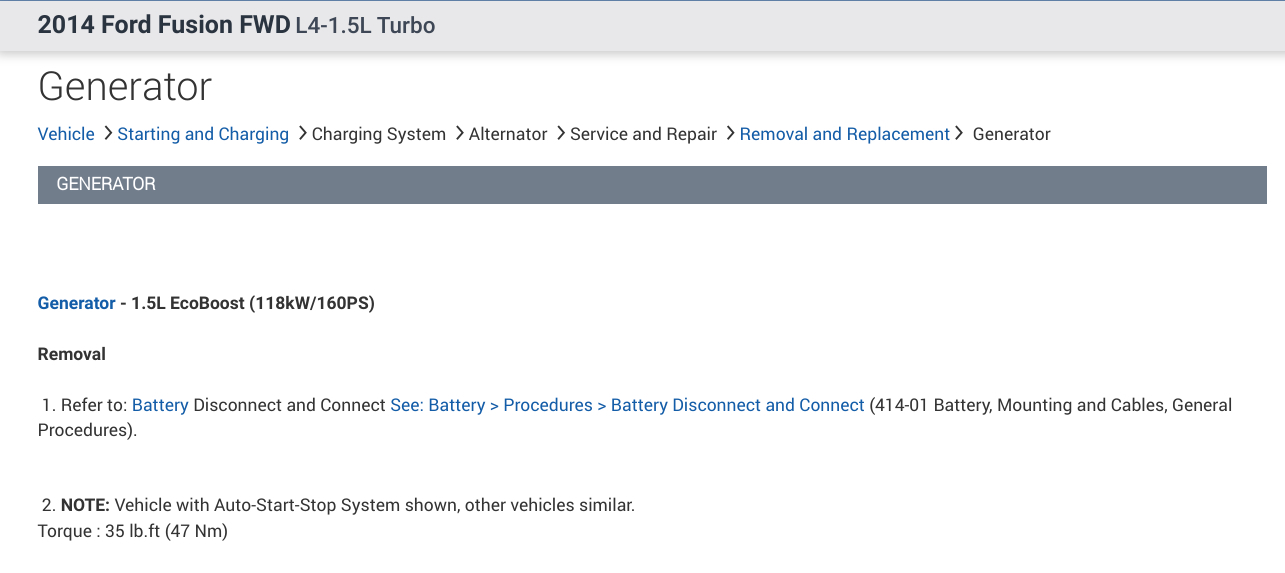

This sounds like you could be having a problem with your vehicle's thermostat. In the diagrams down below I have included the instructions from the vehicle manufacturer for the removal and installation of the thermostat for your vehicle as well as the Original Equipment Manufacturer[OEM] part number for the thermostat. Please go through these guides and get back to us with how everything turns out.
Thanks,
Alex
2CarPros
