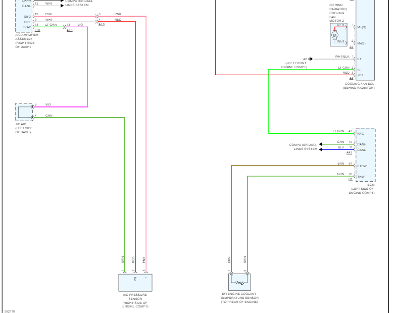

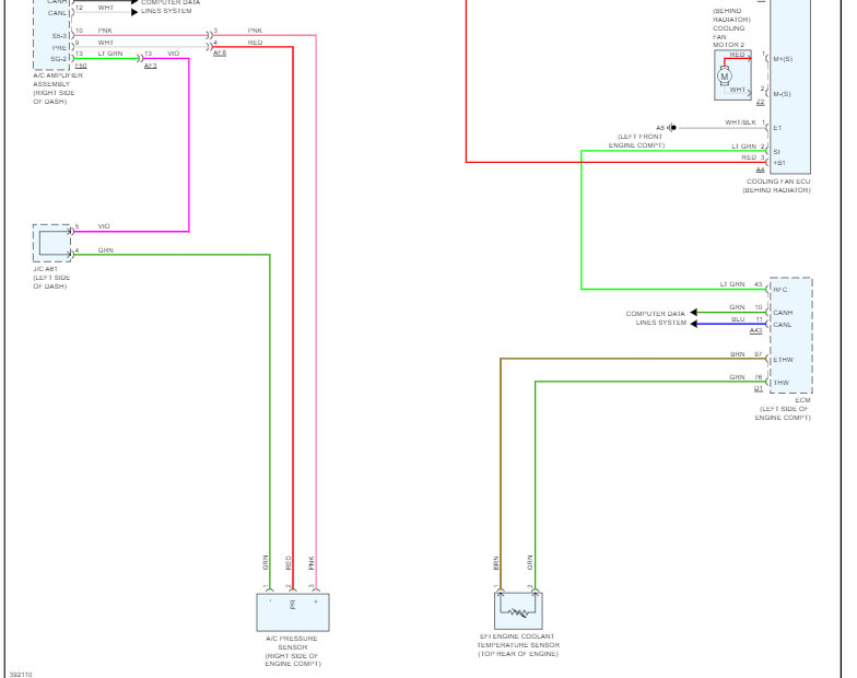

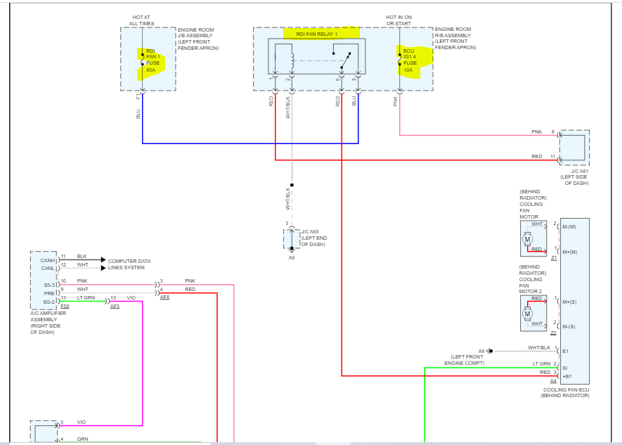

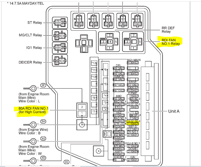

If you look below, I attached the wiring schematic for the fans. Also, pic 3 shows the fuses and relay to test. When you check the fuses, make sure there is power to them. Here is a link you may find helpful.
As far as the relay is concerned, switch it with a different relay in the box having the same part number. If there isn't one, here is a link that explains how to test a relay:
Let me know what you find.
