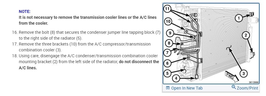

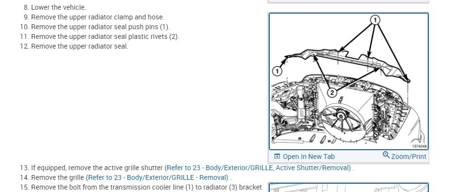

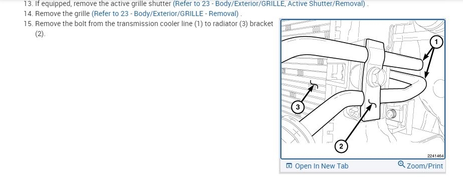

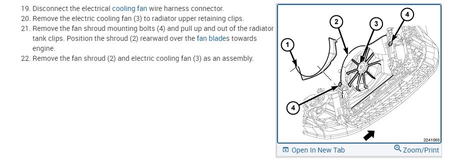

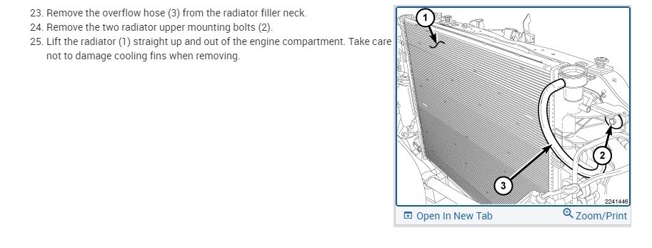

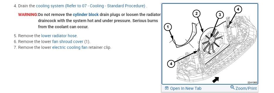

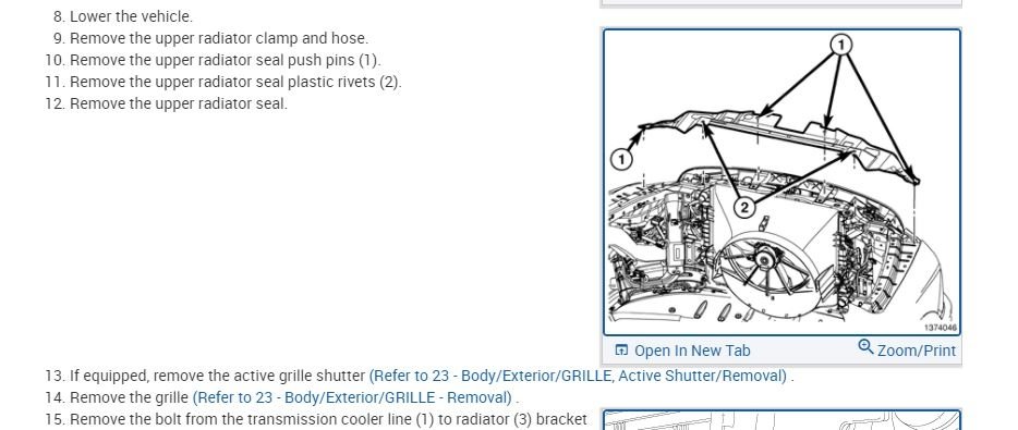

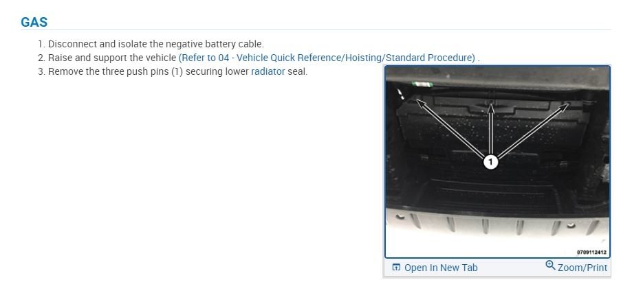

This sounds like a radiator being clogged with debris. The debris prevents the circulation of the coolant from proper cooling.
https://www.2carpros.com/articles/engine-overheating-or-running-hot
https://www.2carpros.com/articles/how-to-replace-a-car-radiator
I attached the procedure below for you for the repair.
Let me know if you have any other questions.
