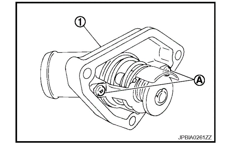

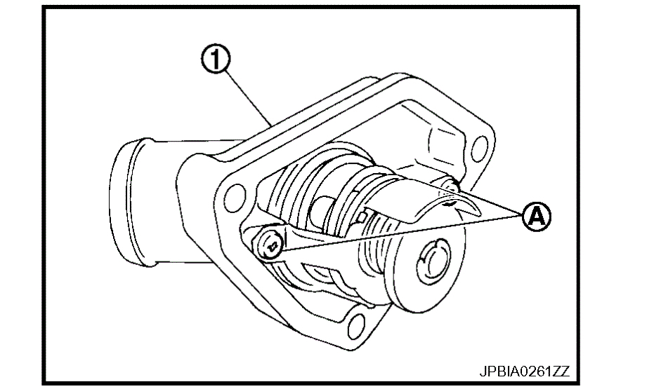

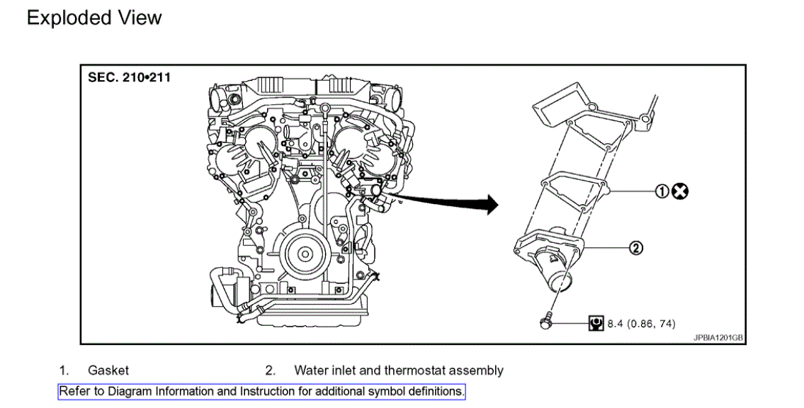

Removal and Installation
REMOVAL
1. Remove engine cover.
2. Remove air duct and air cleaner case assembly (LH).
3. Remove reservoir tank.
4. Remove oil cooler water pipe mounting bolt, and move aside water pipe.
5. Remove engine undercover with power tool.
6. Drain engine coolant from radiator drain plug at the bottom of radiator.
CAUTION:
Perform this step when the engine is cold.
Never spill engine coolant on drive belts.
7. Disconnect radiator hose (lower).
8. Disconnect intake valve timing control valve harness connector (LH), and remove intake valve timing control solenoid.
9. Remove water inlet and thermostat assembly (1).
CAUTION:
Never disassemble water inlet and thermostat assembly.
Replace them as a unit, if necessary.
A: Do not loosen these screw.
