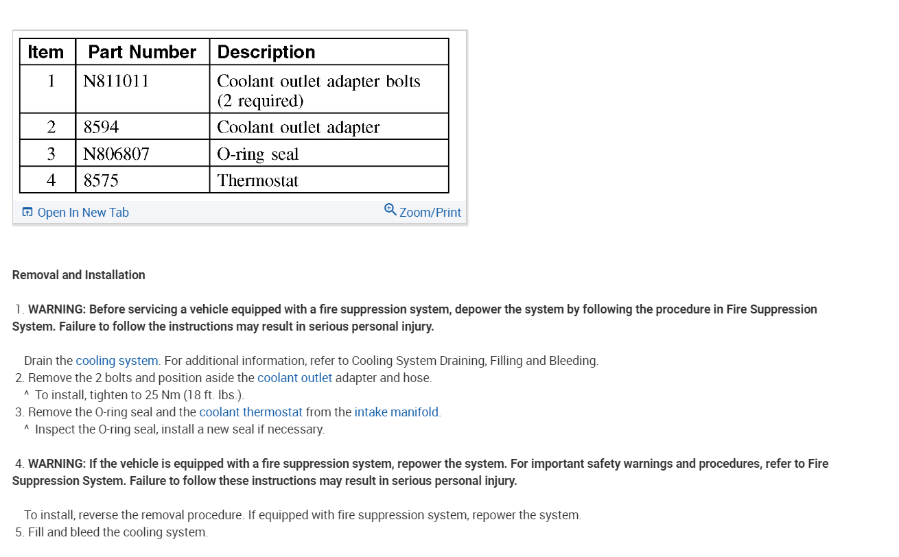

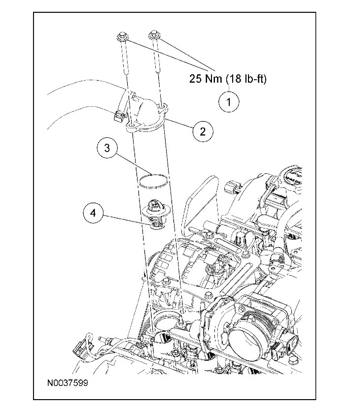

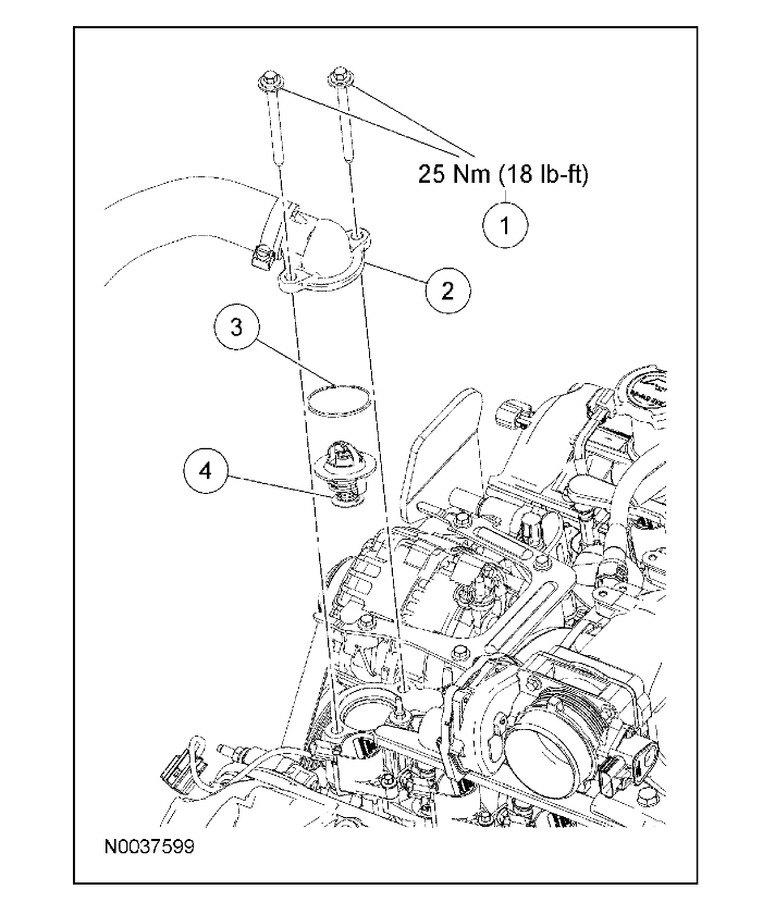

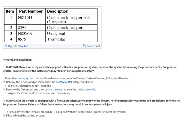

It sounds like you have a defective thermostat, or it is installed backwards which will make the engine overheat. Here are two guides to help and I have included instructions on how to change the thermostat out:
and
https://www.2carpros.com/articles/engine-overheating-or-running-hot
Check out the images (below). Please let us know what you find.
