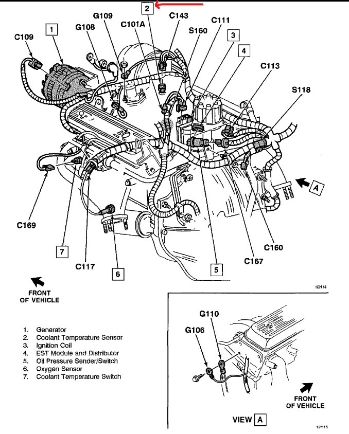

It sounds like the engine coolant temperature sensor has gone out. But to be sure can I ask if the engine is full of coolant? If so, here is the location of the sensor so you can swap it out. This guide can help as well:
https://www.2carpros.com/articles/engine-overheating-or-running-hot
This guide can help walk you through the job with the location in the images below for your truck:
https://www.2carpros.com/articles/coolant-temperature-sensor-cts-replacement
Check out the images (below). Let us know how it goes.

The coolant was fine but then I noticed it was lower in the reservoir than usual and it didn’t go up to the hot fill line even after driving it. I also heard a hissing noise coming from the inlet radiator hose. So, I topped off the radiator then added water to the reservoir and now the coolant is staying at the same level in the reservoir. Also, I found that the coolant temperature switch which is number 7 on the image you provided was broken off. So, I am going to replace that one.
