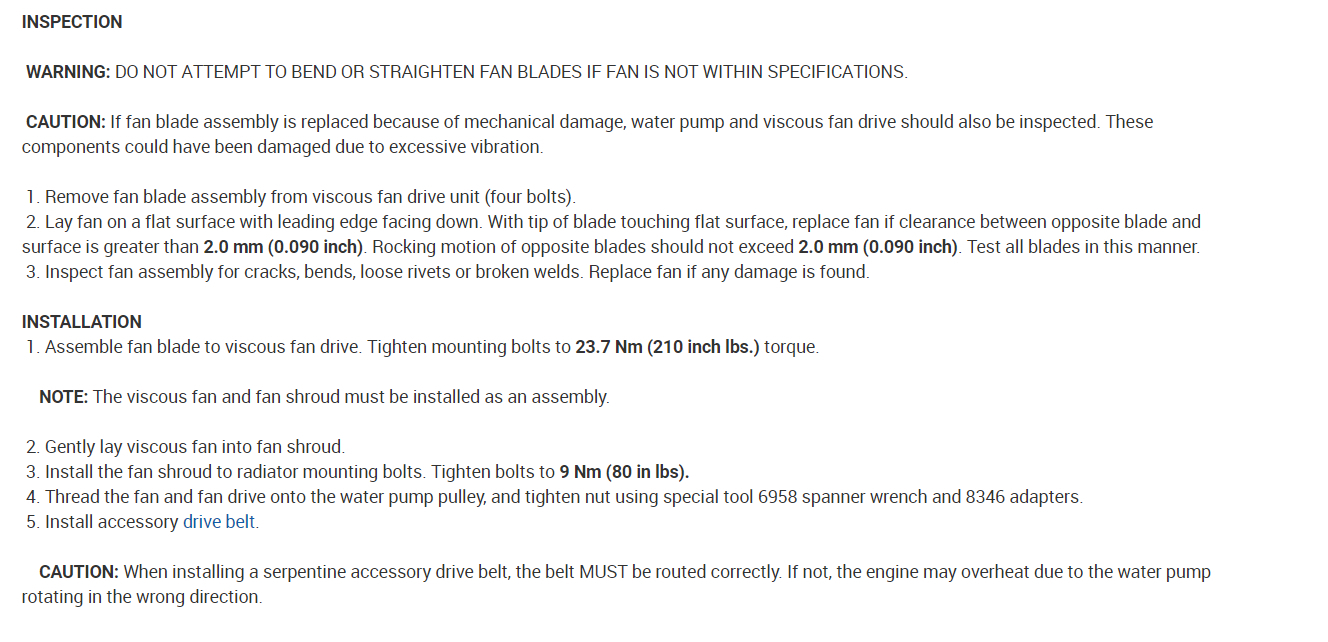

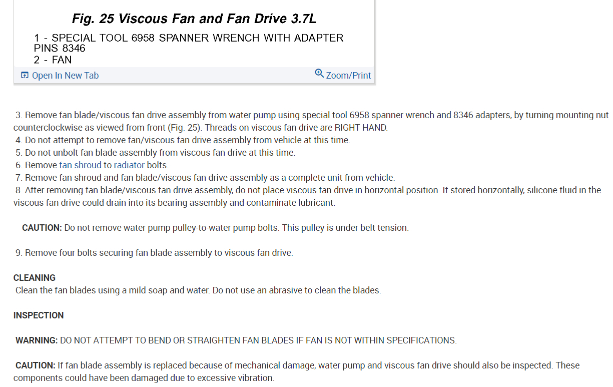

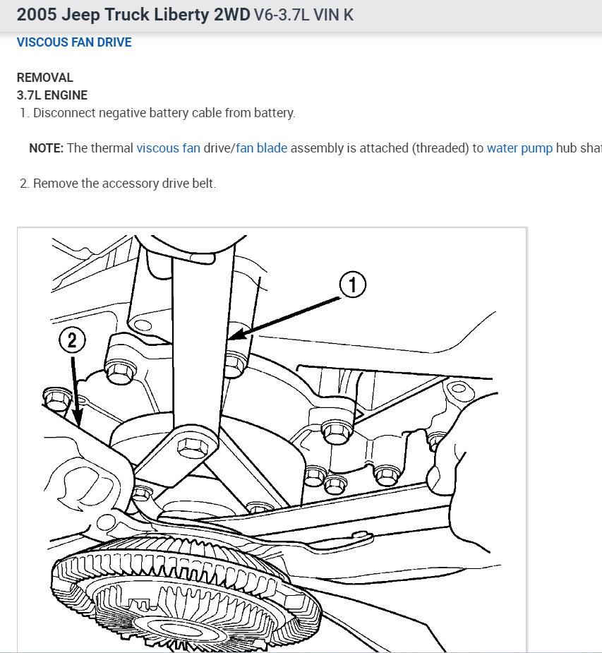

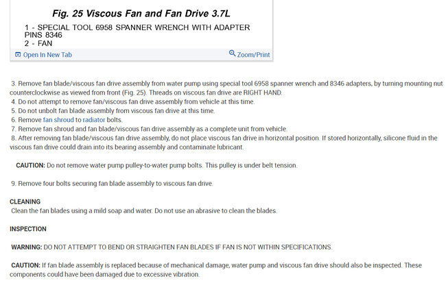

When the engine is getting hot, can you hear the fan clutch kick in? If not, I would replace the fan clutch. please check out these two guides and the instructions on how to change the fan clutch out in the images below.
https://www.2carpros.com/articles/fan-clutch-removal
and
https://www.2carpros.com/articles/fan-clutch-symptoms
