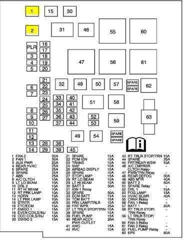

Also, check fuses 1 and 2 in the under hood fuse box. Both are 30 amp and power the cooling fan. See pic 1

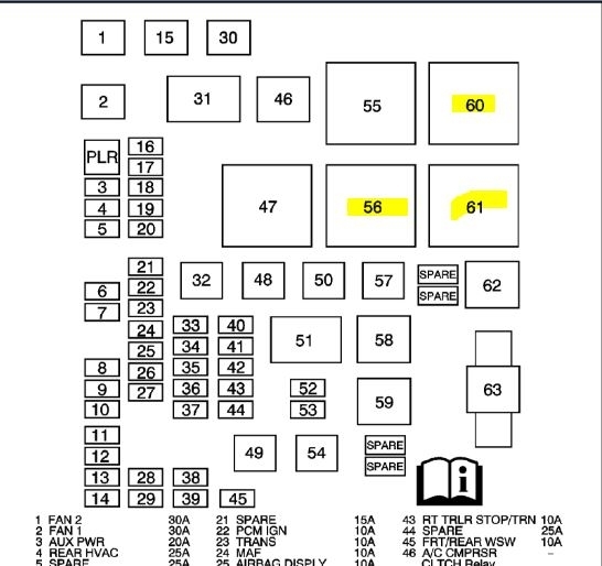

Also, check relays 56, 60, 61 in the under hood fuse / relay box. See pic 2
