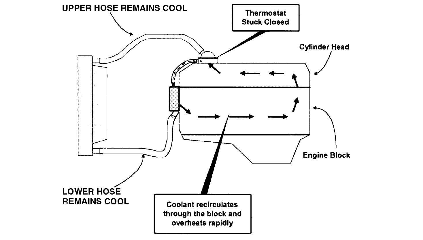

Recently the lower radiator hose busted, after replacing hose and adding antifreeze back I started truck and everything seemed to run the same as in past. Within 5 miles however notice the truck began to overheat. Checked to make sure hose stayed on and it did however after let truck cool down it seem to not want to start acting like it wasn’t getting fuel it needed. After finally starting yet again within few miles the truck continued to overheat. I’m not very mechanically inclined and need to know what I can do myself to try solving problem.
Dec 10, 2019 at 9:37 PM
SCGRANTURISMO
  • 4,897 POSTS

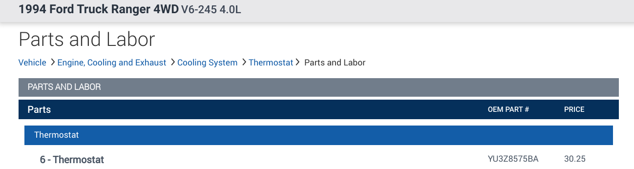

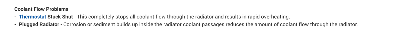

This sounds like your vehicle's thermostat may have stuck shut. Every vehicle has a thermostat in it that allows the coolant to heat up and then it opens at a predetermined temperature to let the coolant flow through the radiator, which cools it. Then the thermostat closes again and the whole process starts over. This allows the coolant to get hot enough so your vehicle has a heater and a defroster. When a thermostat fails it either sticks open or sticks closed depending on how it was when it failed, usually closed. Thermostats are very easy to change and can be done with usually with just a wrench and a screwdriver. In the diagrams down below I have included the Original Equipment Manufacturer [OEM] part number for your reference, a guide explaining all the possible ways your vehicle could overheat for your reference, and instructions for the removal and installation of your vehicle's thermostat. Please go through these guides and get back to us with what you are able to find out. I hope that this helps.

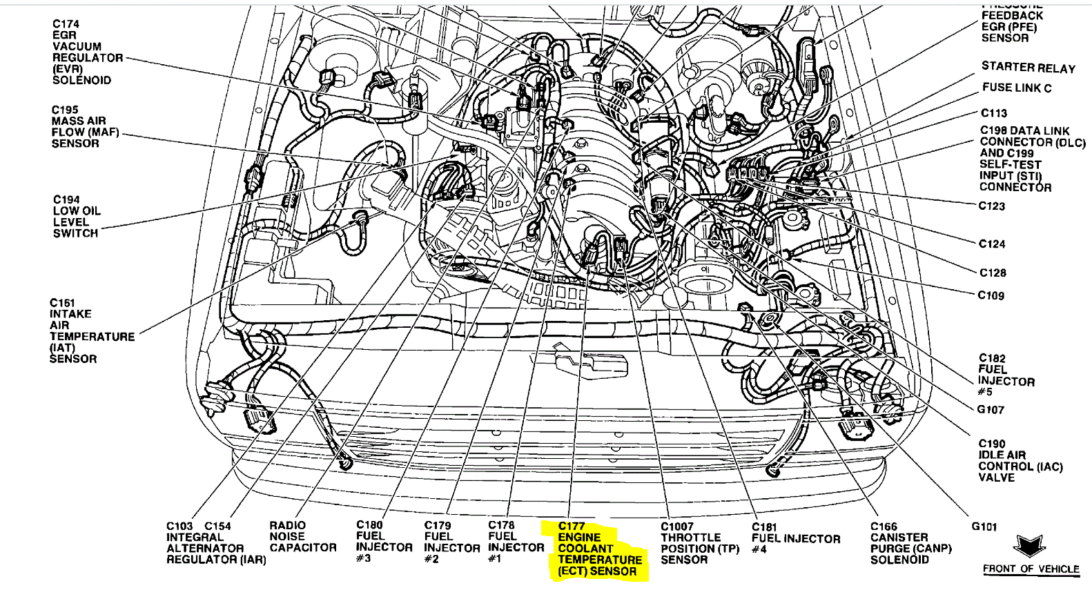

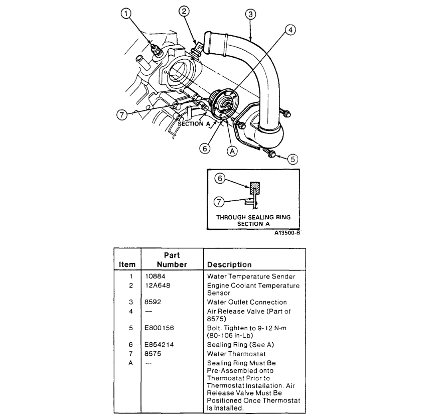

I read through you description of what is happening. I have a couple ideas that could be causing this. First, you mentioned that within 2 minutes, the vehicle reaches the 3/4 point. That is hard to believe it would happen that quickly. Have you checked the coolant temperature sensor? It may be sending random signals.
The first thing I would check for are diagnostic trouble codes. Here is a link that explains how to retrieve codes on a Ford OBD1 system:
https://www.2carpros.com/articles/ford-lincoln-mercury-obd1-1995-and-earlier-diagnostic-trouble-code-definition-and-retrieval
There is a list of OBD1 codes with definitions at the end of the link.

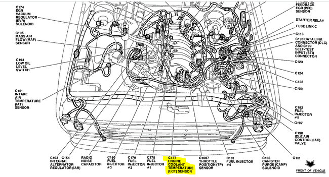

Next, I would first check the sensor. Here are the directions. Pic 1 below shows the sensor location.
_________________________
1994 Ford Truck Ranger 2WD V6-182 3.0L
DA3 - Check Resistance of Temperature Sensor - Engine Off
Vehicle Powertrain Management Computers and Control Systems Testing and Inspection Pinpoint Tests With EEC IV (OBD I-A System) Pinpoint Tests DA - Intake Air and Engine Coolant Temperature Sensors DA3 - Check Resistance of Temperature Sensor - Engine Off
DA3 - CHECK RESISTANCE OF TEMPERATURE SENSOR - ENGINE OFF
- Key "OFF".
- Disconnect suspect temperature sensor.
- Measure resistance between sensor signal circuit and SIG RTN circuit at the temperature sensor. Refer to the corresponding chart for resistance specifications.
- Is resistance within specifications?
Yes -- For Engine Coolant Temperature (ECT) sensor with a No Start: Do not service Diagnostic Trouble Code (DTC) 116 at this time.
Go to pinpoint test step AA1. See: Computers and Control Systems > Pinpoint Tests > AA1 - Identify Type of No Start
No -- Replace suspect sensor. Reconnect vehicle harness. Rerun quick test. See: Computers and Control Systems > Reading and Clearing Diagnostic Trouble Codes > Quick Test Appendix (Detailed Testing Instructions)
If the sensor checks good and there are no codes, my next concern is the idea that coolant shoots from the radiator after about 45 seconds. That quickly leads me to believe it could be the result of pressure from the combustion chamber via a head gasket. Do a couple checks on this idea. Here is a link that explains how to check for a head gasket issue:
Let me know what you find or if you have other questions. Also, keep in mind that the reason I'm suspecting one of the two things above is simply because it happens at highway speeds and you have already done all the basics.

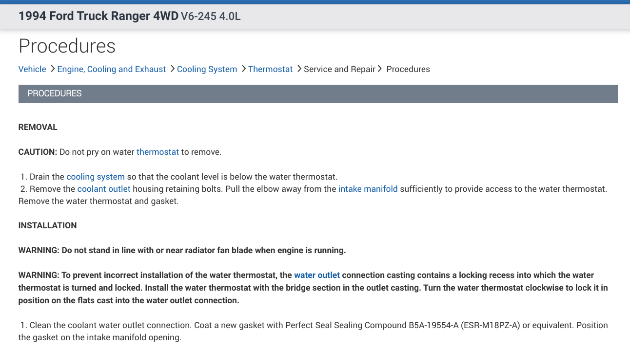

If the coolant isn't low and you can find no evidence of leaks, my next suspect is a bad or stuck thermostat. The first link discusses a thermostat, it's general location, and how to check one.
https://www.2carpros.com/articles/how-an-engine-thermostat-works
Here is a link that shows in general how one is replaced:
Once you review the aforementioned links, let me know what you find so I can further help.
