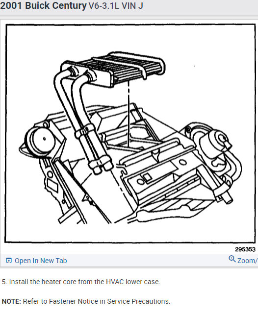

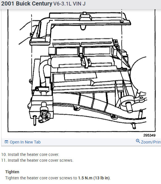

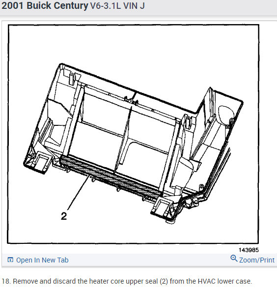

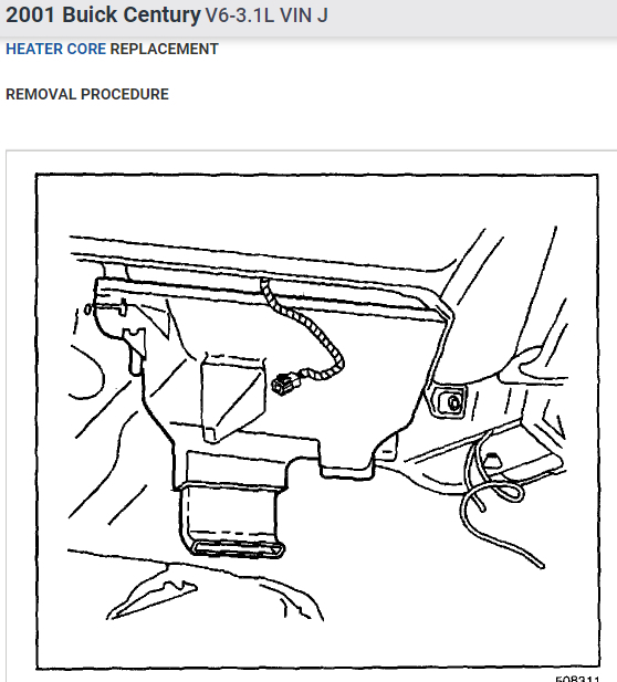

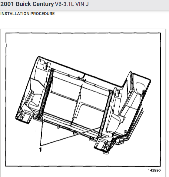

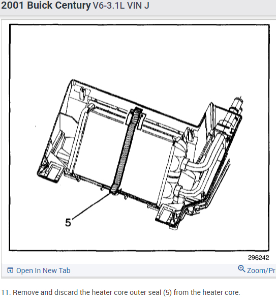

As for not getting heat, you might have a clogged heater core. You can try flushing the system, which can clear out the system.
And if it still does not fix the heater issue then the next step would be change out the heater core.
