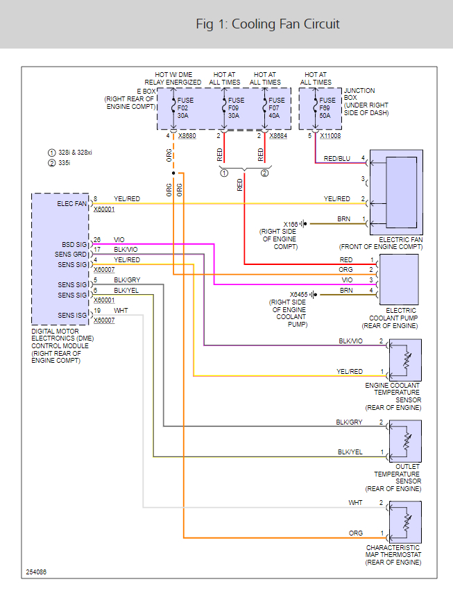

Here is the wiring diagrams for the cooling fans. (below)
