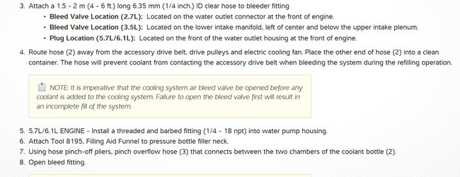

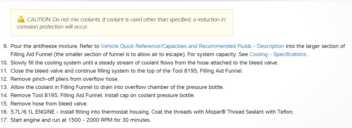

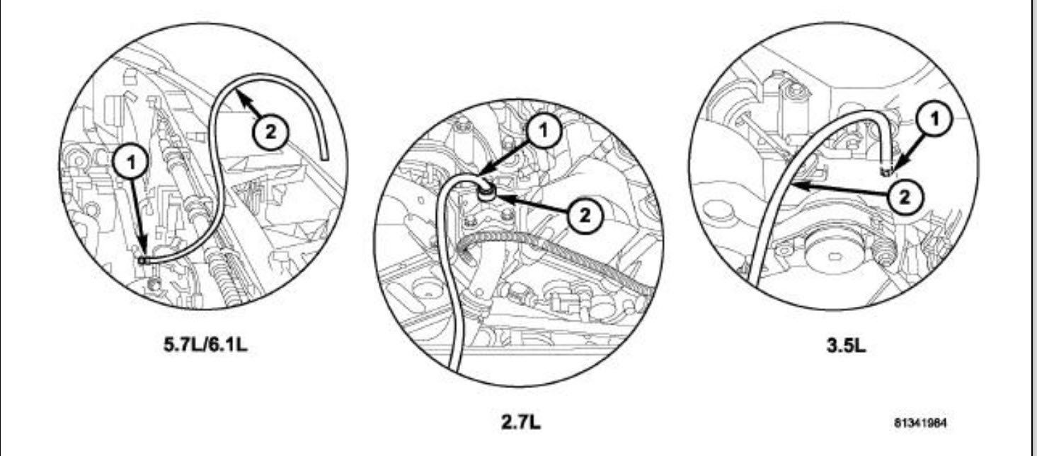

it has to have an air pocket in heater or similar both hoses should be hot if one is the other should be as well. try bleeding system once more to instructions in pic, make sure coolant cap is in good shape

Or your heater core is plugged/restricted if it's not overheating then I wouldn't think there was a air pocket but try bleeding it as instructions provided.
