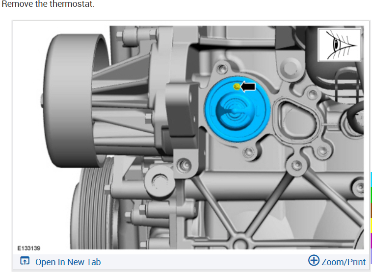

When they did the water pump, did they replace the cooling system thermostat? If not, that is what I would do for the next step, at the same time I would do a chemical test for the cooling system. Here is the location for the thermostat and a guide to show you what needs to be done for the test.
Jun 2, 2025 at 5:04 PM

That would be the first thing I do, along with a chemical test.
Jun 5, 2025 at 11:52 AM
