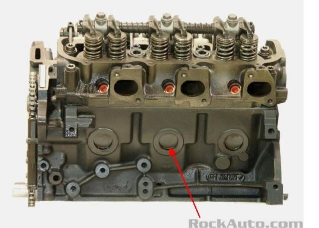

Take a flashlight and a small mirror with a swivel head down there with you. If you do not see coolant running at this time, loosen the radiator cap, then search again. Vacuum can build up in the radiator that keeps more coolant from running out. Look at both sides of the engine block for multiple "core plugs" that could be corroded though and leaking. Those are about 1 1/2" in diameter and are pressed into matching holes in the block. If the antifreeze is not replaced every two years, the additives wear out, then acids form in the coolant that attacks metal parts. GM has a real big problem with that with their heater cores and radiators, but this can occur on all car brands. If you find seepage from a core plug, the repair is going to be real inexpensive, but the hardest part can be gaining access to it to pound the new one in. Auto parts stores that rent or borrow tools will have a tool kit that makes the job pretty easy. I will describe that if that becomes necessary.

Below is a photo of one side of your engine. I added a nifty red arrow pointing to one of the core plugs, (aka "freeze plugs"). There are three on the other side too. When you have a slow, elusive leak that leaves a puddle half way between the radiator and the firewall, and a little to one side of the engine, these are the best suspects. They leak from a hole corroding through them. That is much more common when the antifreeze is not replaced every two years. Look for rust-colored stains, or a crusty build-up on those plugs. If you see that, irritate the area with a screwdriver. If one is leaking, you will usually be able to poke the screwdriver through it, then coolant will come gushing out. I can describe how to replace them if necessary.

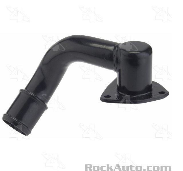

A leaking head gasket will let combustion gases sneak into the cooling system. From there, it can pool under the thermostat, preventing it from opening. That is what causes the rapid overheating. Thermostats open in response to being hit with hot liquid. Hot air will not do it.
To find the thermostat, follow the upper radiator hose to the housing. It is shown in the second photo. If the engine is overheating because of a leaking cylinder head gasket, you are likely to find lots of pressure when you remove the radiator cap, but the coolant will be cold, not hot, and it will not be steaming. The upper radiator hose will be cold too. If you find the coolant is hot, verify the radiator fan is spinning the correct direction. There are many Ford applications where the serpentine belt can be installed incorrectly, causing the water pump and fan to spin backward. Check that the ribbed side of the belt runs on the ribbed pulleys, and the smooth back side runs on the smooth pulleys.
