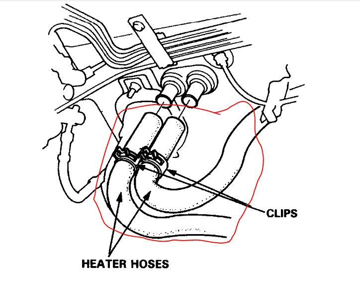

The heater hoses attach to the heater core at the firewall. There are two of them. See pic below. Check to see if they are wet.
Also, you may want to pressure test the system once the coolant is full. This allows you to check for leaks under pressure without the engine running or hot.

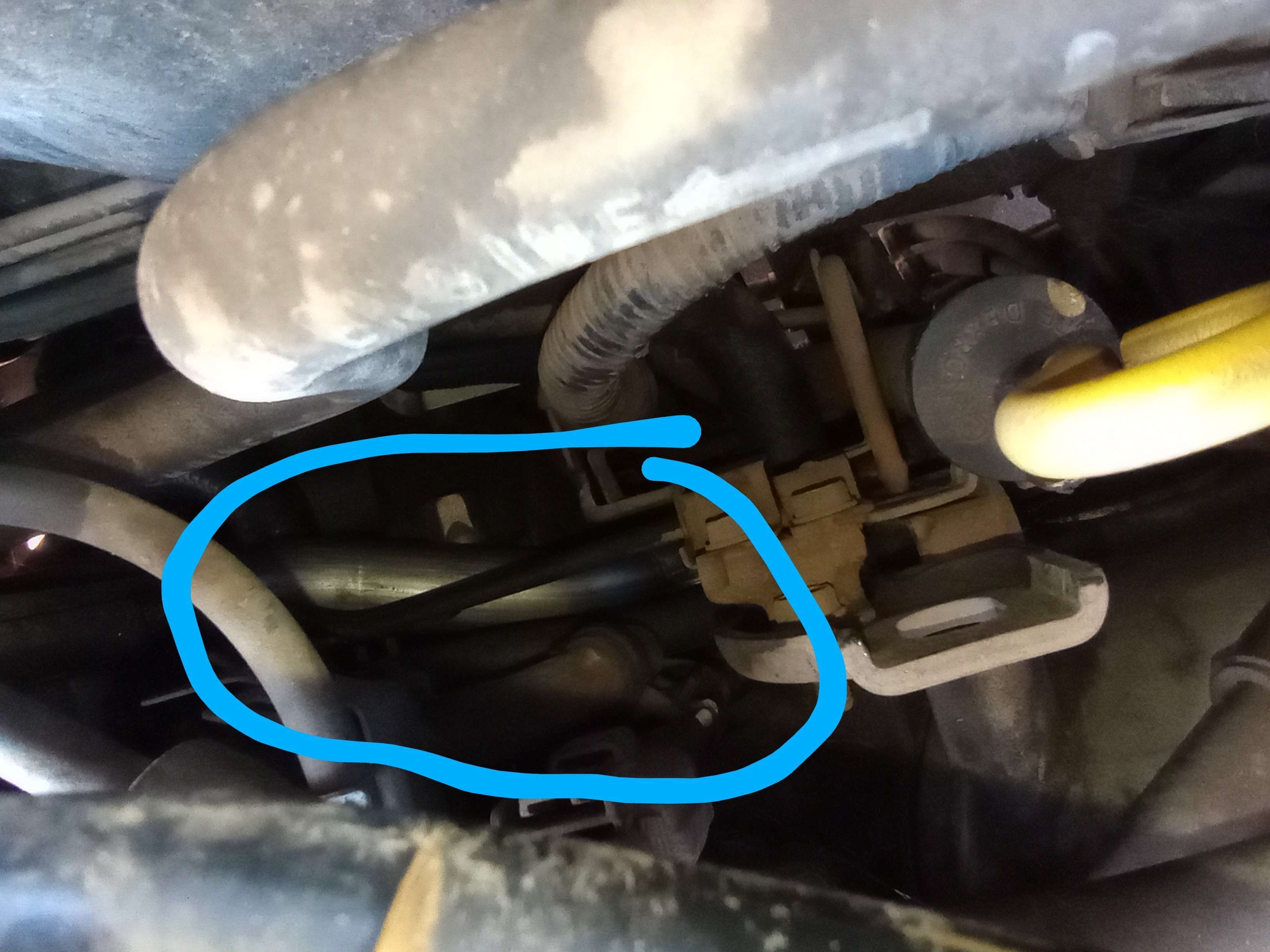

Hi Joe. I ordered a cooling system pressure testing kit from Amazon and did the pressure test yesterday. There is definitely a break in the system. It's located behind the intake manifold. What does the shiny pipe go to? There is a hose right beside it. That is the general area where the leak is occurring. It's either the pipe or the hose that's broken. Even with my small hands, it's hard to get to, so I'll have to do some dismantling to get to it. I'm including a photo. The blue circle shows the general area where the leak is occurring.
Feb 1, 2024 at 8:09 AM
Don't you love how much room you have to work with? It is frustrating at times.
It's hard for me to see anything in the picture. If you don't have one, get yourself a mechanic mirror at the local parts store. They aren't expensive. Then, you can fish it down between things to help locate the leak. I usually put the mirror where I want it and then shine my light on the mirror so that it reflects off the engine. That way I can see things.
I don't know if there is an AutoZone near you, but they have one that is very inexpensive. See pic below.
See pic below.
Feb 1, 2024 at 6:09 PM

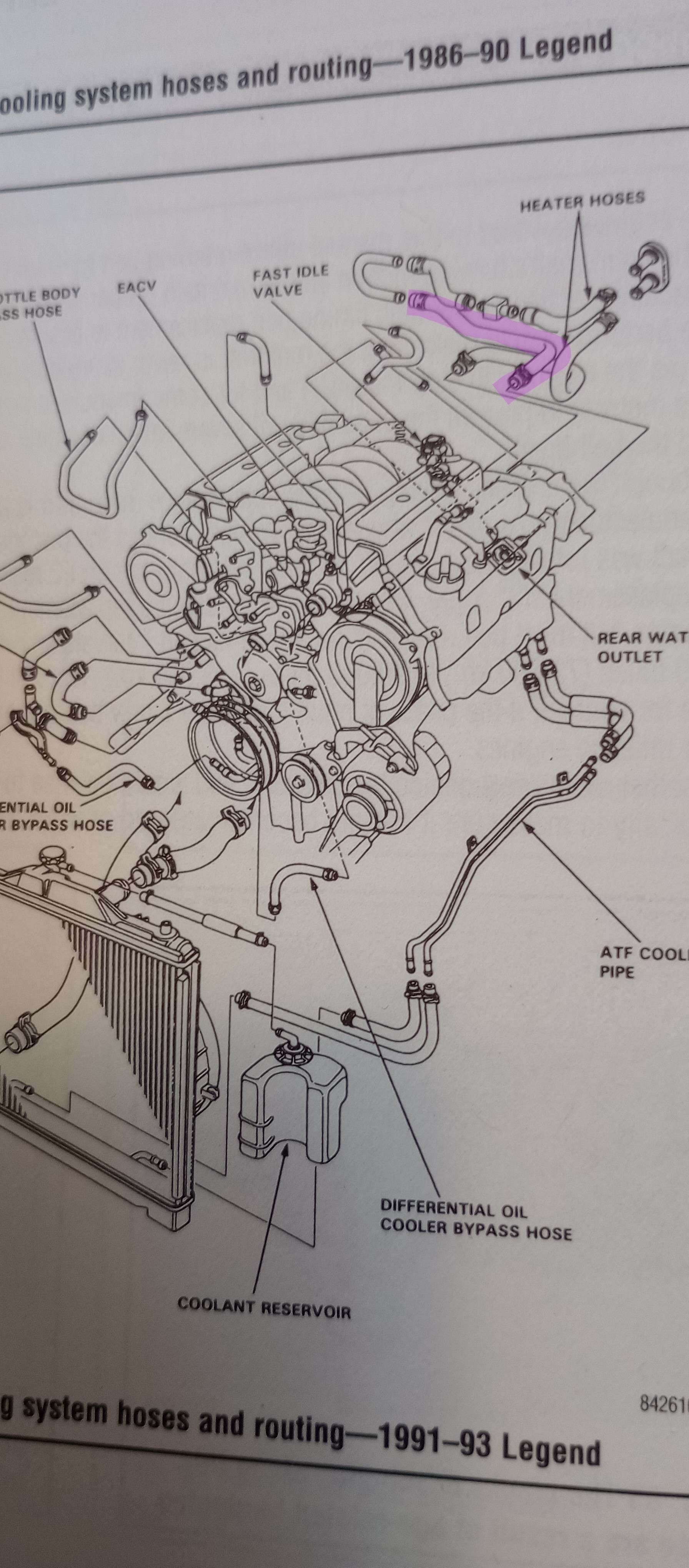

Hi Joe, I have some more info for you about my Acura. I just came from outside. I removed, what I am going to call, a body brace. It's a bent bar with a diameter of approximately 1". It spans from fender-well to fender-well and is attached to the back firewall. Anyway, that allowed me to get a better look at things down there, that and removing the fuel injection cover on the driver side. I purchased a diagnostic mirror from Walmart for $4.98, which also helped me to see things better.
There is a hose, about the diameter of a heater hose, coming out of the back of the motor from the driver's side. With the mirror and a flashlight, I could see that the hose was wet. It's positioned just below the driver's side fuel rail. With my hand, I was able to trace the hose to see where it led. It goes directly behind the intake manifold and plugs into something else, which I couldn't see very well, so I don't know what it is. I was able to tell approximately how long the hose was as I could feel the hose clamps on each end. I think it is between 2 - 3 feet long.
However, to be able to remove the hose, I will have to take part of the fuel rail off as well as some kind of canister that the fuel rail plugs into. The canister is attached to the firewall. There is also some other junk back there that is in the way, I have no clue what it is. It looks like some kind of linkage, but I don't know what it goes to. Maybe it's for the transmission.
Even though it's a front-wheel drive, the engine isn't transverse. Being that it's a Japanese-built car I haven't got a clue what they were thinking when the engineers designed this thing. I wish I could get the wiring done on my 85 Dodge D150 Ram Truck. It's so much simpler than this Japanese thing. No prejudice intended against the Japanese, I'm just not much for foreign cars. I'll drive'em but I don't like fixin'em. I'd be focusing on the wiring on my truck if the Acura would quit breaking itself.
I look forward to your reply,
Althea
PS. I was looking in my Haynes Manual last night, page by page, and I finally found something that made sense. I'm including a photo. The hose that is highlighted I believe is the culprit.

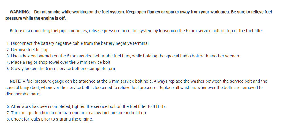

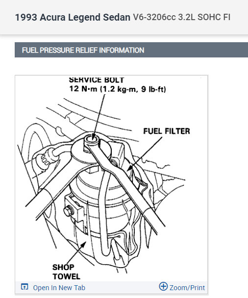

Hello again Joe. I also need to know where to relieve the pressure on the fuel rail. To get to the hose I need to replace, I have to take off the part of the fuel rail that follows along the back of the engine. Can you get me a photo of the pressure release so I will know where it is? If you can, I'd be most grateful.
Feb 8, 2024 at 1:51 PM
The pressure release is done at the fuel filter. Basically, you would wrap a shop towel around it and loosen the service bolt on it.
I attached the directions below.
Let me know if this helps.
See pics below.

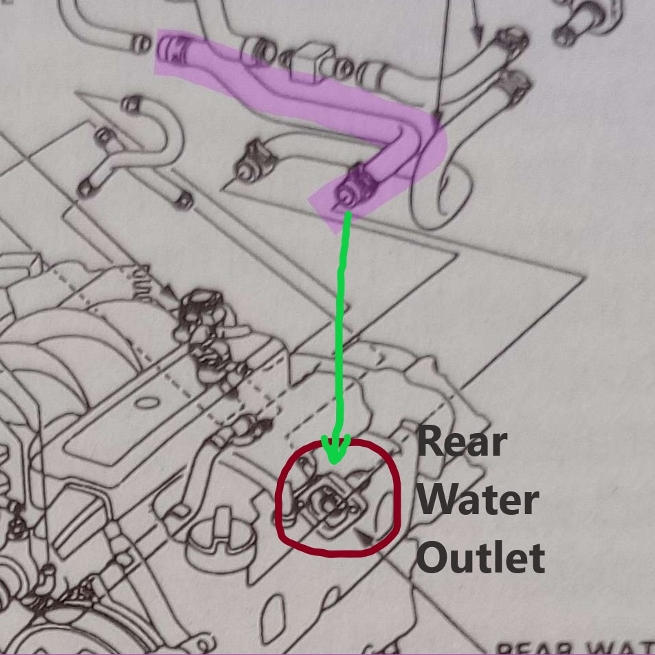

Anyway, I finally got enough stuff out of the way that I can see the hose I'm trying to get to better. Now my big problem is the transmission dipstick tube is in my way. I've been examining how to get the tube out of my way all day long. I even jacked up the car and tried looking at it from beneath. There is a bracket just above the end of the hose, highlighted pink, that attaches to the rear water outlet in the attached photo. I thought that the transmission linkage was connected to this bracket, but it turned out to be some hard-line vacuum tubes, and the transmission dipstick tube.
I loosened the lines and dipstick tube from the bracket. The lines are out of the way, but I can't get the dipstick tube to move more than .25 inches in any direction. The main bracket is attached to the top of the back of the head. I am prevented from getting to the bolt that holds the main bracket to the head until the dipstick tube is out of the way. If I can get that bracket and the tube out of the way, then I can reach the hose clamp.
As you can see, I have circled in red the rear water outlet, which I thought was under the intake manifold, but it turns out that it's attached directly to the back of the head. It looks as though the outlet can be removed. All I know is this is the area where the coolant is leaking from. However, with the way the parts in the photo are set up, I can't figure out where the inlet and outlet hoses attach to the firewall. This car makes no sense to me.
The main thing is getting the transmission dipstick tube out of the way. Then I can get to the house.

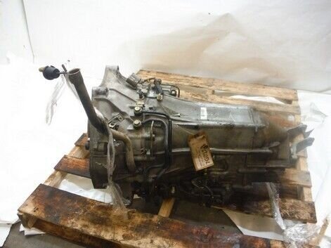

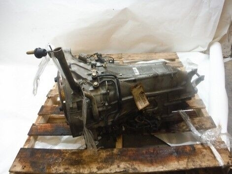

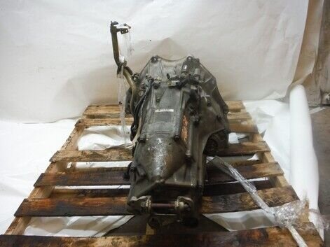

I'm sorry, it's way too tight in there and I can barely make heads or tails of it with a flashlight so I couldn't get a pic. However, I found a 91 Acura Legend transmission on eBay and plenty of photos. I downloaded the three best photos to my computer and am uploading them to here. I'll also supply the link where I found it in case you want to see the rest of the photos. The seller tried to do a 360 photo shoot. Here's the link: https://www.ebay.com/itm/332346229881
I hope this helps. I'm so sick of this car, I'm ready to stick a for sale sign on it and let it be someone else's pain in the back side. The only foreign vehicles I ever had that I liked were my 2 89 Isuzu Pickups. I wish I still had one of them.

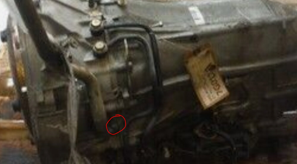

I looked at the pics and the ones on Ebay. It is somewhat difficult for me to see, but it does appear there is a bolt at the base of the tube where it attaches to the engine block. Are you able to access that one?
See pic below.

Yes. There is a bolt there, but the question is how do I get to it? I jacked up the car, crawled under it, and literally had to squeeze my hand and arm up to my elbow just to feel for the bolt. It feels like a 10 mm. It's going to be loads of fun getting to it. Also, there is some kind of wiring harness attached at two different places on the tube, which is another thing making it difficult to get to it. I guess all I can do is try. Thanks for all your help. I'll let you know what happens.
