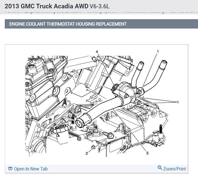

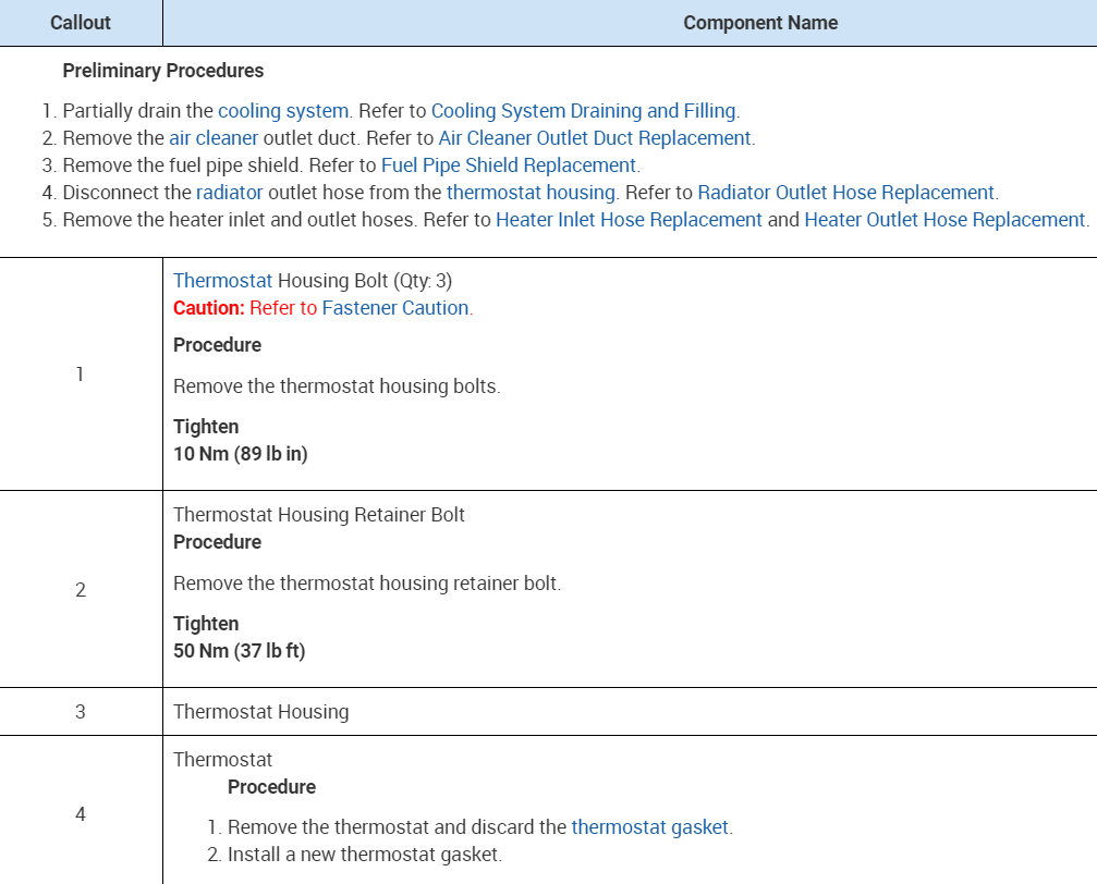

To be clear you fixed the "heater hose line connecting to the thermostat housing" correct? If so, it sounds like the thermostat is stuck closed, here is a guide to help, please go over it:
https://www.2carpros.com/articles/engine-overheating-or-running-hot
Here is how to change the thermostat out. Check out the images (below). Please let us know what you find.

Thank you for the response. Yes, I did fix the heater hose line. I have a new thermostat and housing that I bought before I saw the broken connector. I am hoping it is the thermostat and not the water pump.
Does it sound like coincidence that the connector broke? Or that it was just brittle, and the lack of flow pushed it to the brink?

I put the new thermostat and housing on. No bubbles in the coolant from the radiator. Heat blowing again in the car. Mind you, it is 50 degrees outside, so I will take it for a drive in the morning.
Oct 16, 2023 at 8:37 PM
It sounds like it fatigued and broke, but to be safe you can replace your radiator cap to ensure the cooling system pressure stays within spec. Let me know what happens.
