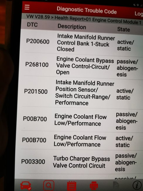

When start engine, the temperature gauge raise to 120 c and at this temperature the radiator fan start to work with high rotation only and temperature remains same, the upper hose of radiator is very hot and the lower is cold.
