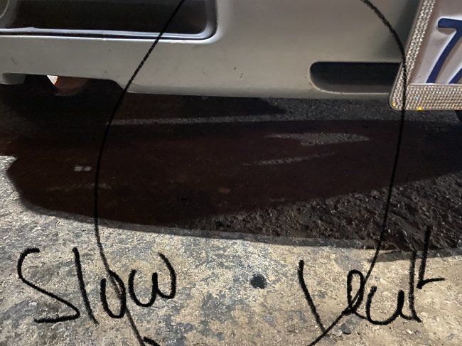

Well, i see water coming out from the front bottom passenger side but towards the radiator the drain plug and also the water reservoir tank.

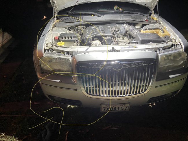

If you like i can take pictures of my car.

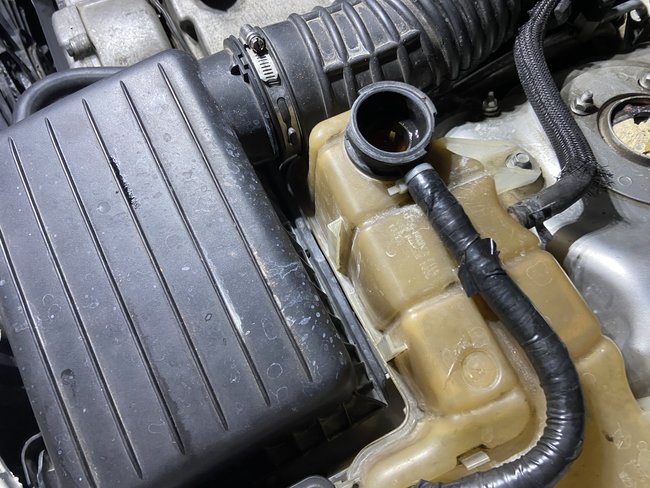

I did my best to take the pictures but maybe you can get an idea where the leak is coming from. If you can see the white stuff splashed on the water tank, I do not know what that is.

So, did you put a new cap on the overflow tank?
The white residue is likely just coolant.

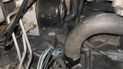

So, my car started to do this it wasn't overheating, it was half ways the normal i popped the hood and this was the best i could get. so please try to watch it and hope fully you can tell me I'm thinking maybe the upper radiator hose and the radiator itself.

From the video it does appear to be leaking from the upper radiator hose.
So, the first step would be to remove the hose and inspect that end. It could have a split or hole on the end there.
Keep in mind to only work on it when the engine is cool.

So, i did check the hose and i didn't see no damage but i did felt the radiator with 2 little holes i can't see it but i felt it so I am going to have to buy a new radiator and hose and hopefully that can solve my problems .

Yes, from the video it appears either from the base of the hose or just below. Small hole that coolant comes out.
