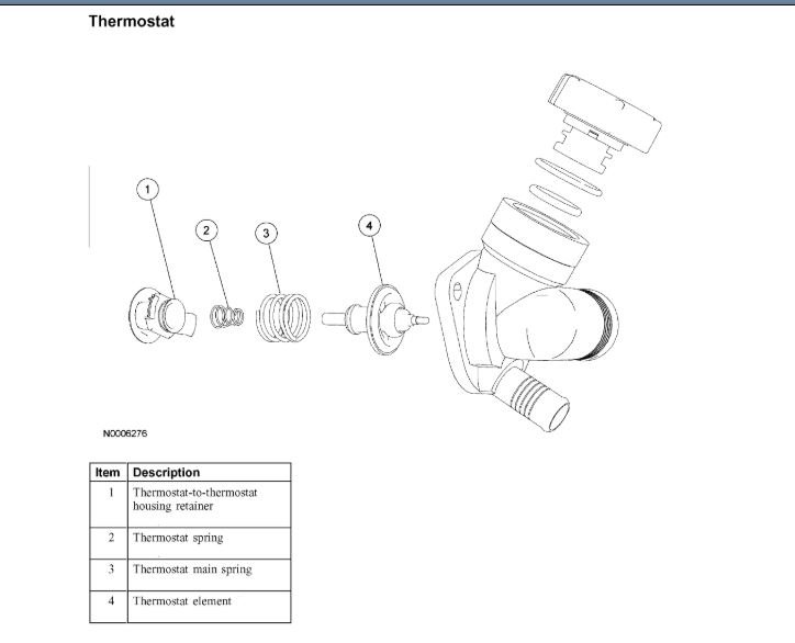

Removal
1. Drain the cooling system. For additional information, refer to Cooling System Draining, Filling and Bleeding.
2. Remove the thermostat housing.

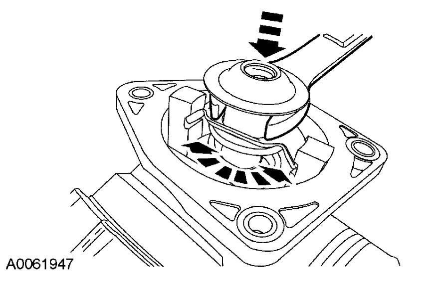

3. NOTE: Thermostat can be rotated in either direction to release it from the thermostat housing.
Using a 18 mm (0.7 inch) open end wrench, simultaneously push down and turn the thermostat retainer to release it from the housing.
4. Remove the thermostat spring, thermostat main spring and the thermostat element.

NOTE: The thermostat can be rotated in either direction to install it in the thermostat housing.
Using an 18 mm (0.7 inch) open end wrench, simultaneously push down and turn the thermostat retainer to install the thermostat in the housing.
