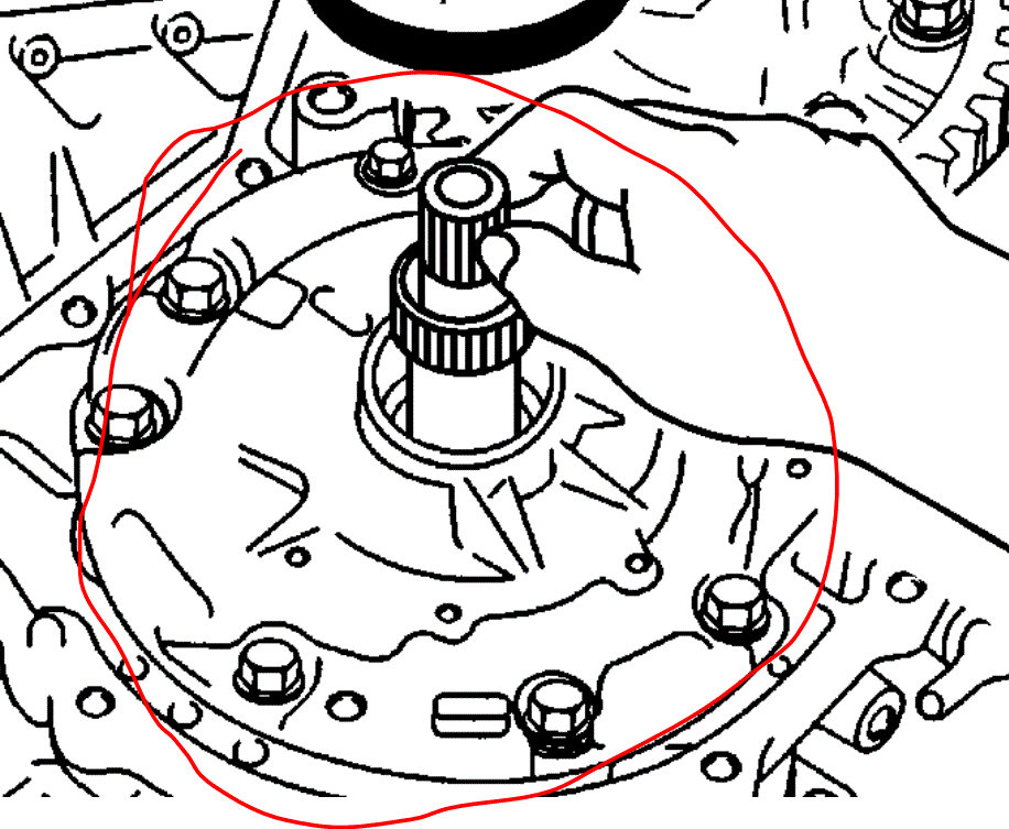

Also, keep in mind there is a front pump (hydraulic pump) at the front of the transmission that could be failing as well. (See Pic 1) The only way to check these things is by testing line pressure. Based on the hydraulic pressure created by the oil pump, the transmission control module (TCM) sends signals to the solenoid and the hydraulic control system governs the hydraulic pressure acting on the torque converter, planetary gear, clutches, and so on. If pressure is low, it will slip. I think you could be on the right track with the converter or it could be related to the front pump. The only way to be sure is to check pressure. And yes, the pump could make a noise as well.

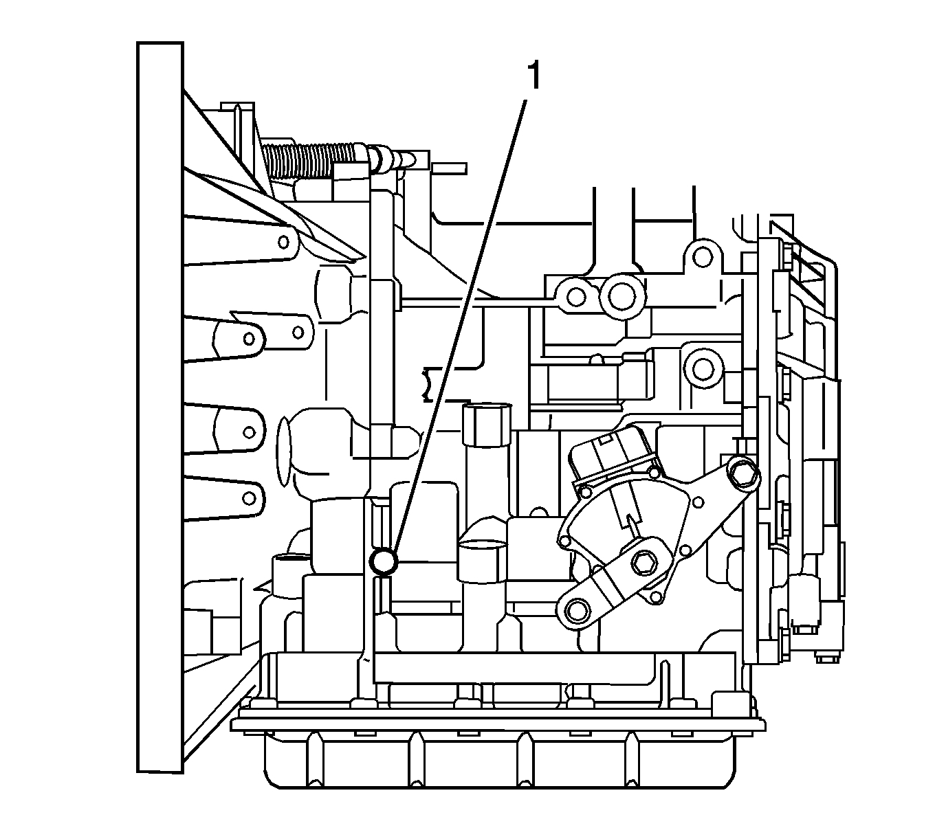

pic 1
1. Wedge the 4 wheels and apply the parking brake fully. Lock the vehicle in place.
2. Install J 21867 and J-21867-50 to test the hole (1) for line pressure.

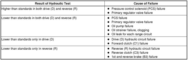

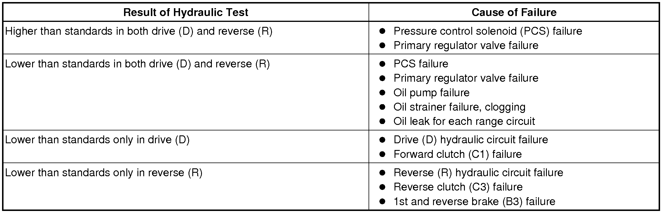

Pic 2
_____________________________
In the last pic, it explains what low pressure can be caused by. I would find out if they have checked pressure. Stall line pressure is indicated in the above directions.
