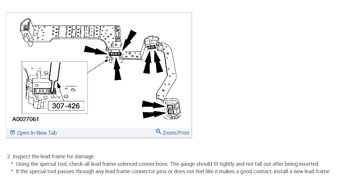

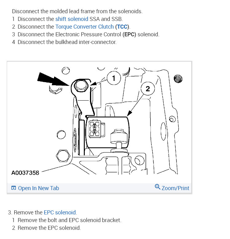

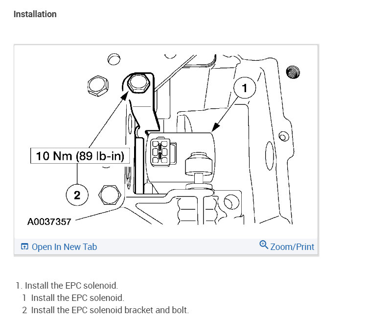

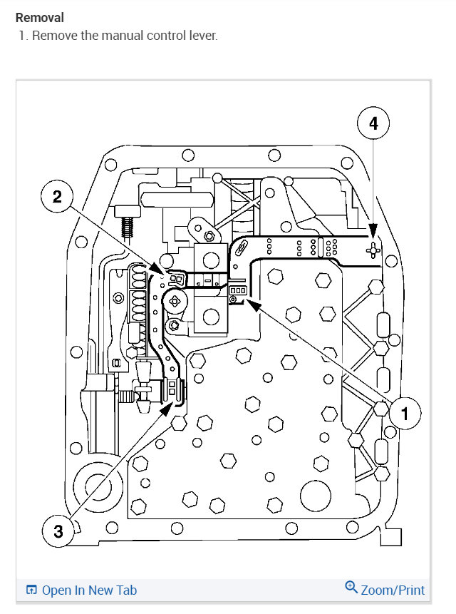

I have seen the pressure regulating solenoid go bad and cause this issue, but we should run the codes to see what comes up. This guide will help, and I have included the location and how to change out the PRS in the diagrams below.

Yep, the first two codes for the EVAP system which shouldn't affect the transmission but the Error Code P1747 is defined as Transmission Pressure Control Short Circuit. Please let us know what happens.

Okay, since I replaced the solenoid, I’ll go and order a new wire harness for the transmission and go from there.
