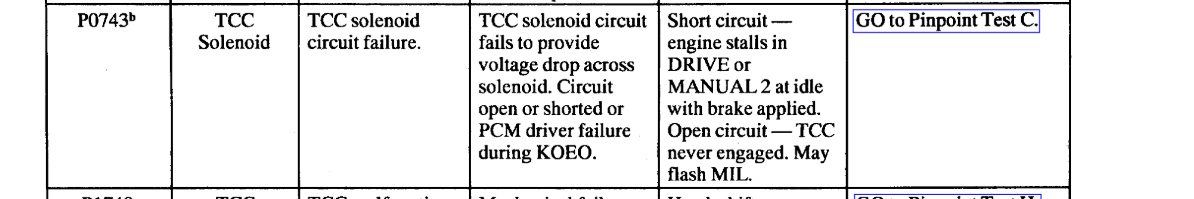

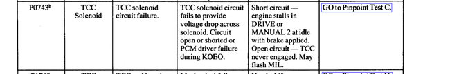

P0743
Descriptor
Probable Causes
Powertrain Control Module (PCM)
Torque Converter Clutch (TCC) Solenoid
Image (Click to enlarge)
