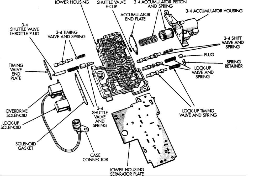

There are a few things which can cause this, sensors, actuators, solenoids. Often times, the overdrive solenoid fails and overdrive is lost. I attached a picture of the solenoid. It is inside the transmission. However, I would not arbitrarily replace it without confirming it is bad.
What I suggest first is to scan the computer for trouble codes. If the check engine light is on, there will be codes. Here is a video that shows how to check:
https://youtu.be/b2IJGfImVvw
If you do not have access to a scanner, most parts stores will do it for free. We need to start there. If the problem is related to the transmission control module or there is an electrical issue such as a bad overdrive solenoid, it will most likely set a trouble code.
Let me know what you find.

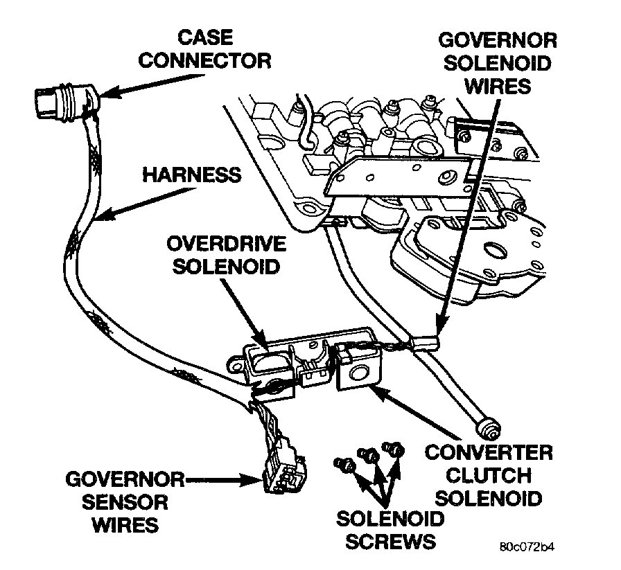

It sound like the overdrive control solenoid has gone out. Here is a guide and some diagram (Below) to help you get the the problem fixed.
Also, I need you to check something. Get in the truck and place the key in the ignition. Cycle the key from off to the run position 3 times (do not start engine). On the 3rd time, let the key stay in the run position. The check engine light will begin to flash codes.
The codes for a 92 are 2 digit numbers. The light will flash then there will be a sligh pause and it will start again to identify the 2nd number of the code. After it finishes the code, there will be a longer pause and it will move on to the next.
Count the flashes to keep track of the codes. Let me know if there are any and what they are if you find any.
