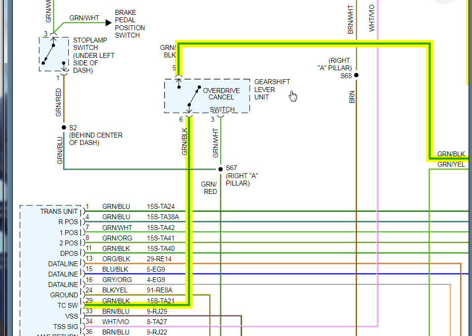

I would see if you can get the codes out of the PCM. I suspect you have a circuit code but that will be more definitive. If you don't have a code reader most parts stores will pull them for free for you.
I think you have a button that is shorted. This is a normally open switch which means the PCM is not getting a voltage signal but when the switch is closed it get a signal on this circuit and turns off OD.
If you can't get codes the best way to test this is to measure continuity on Pins 5 and 6 of the switch in both switch positions. If you have continuity in both positions then this is your issue. You should have an open in one position and continuity in the other.
