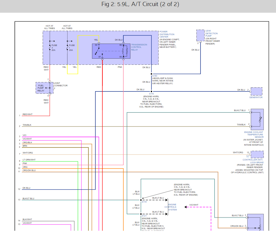

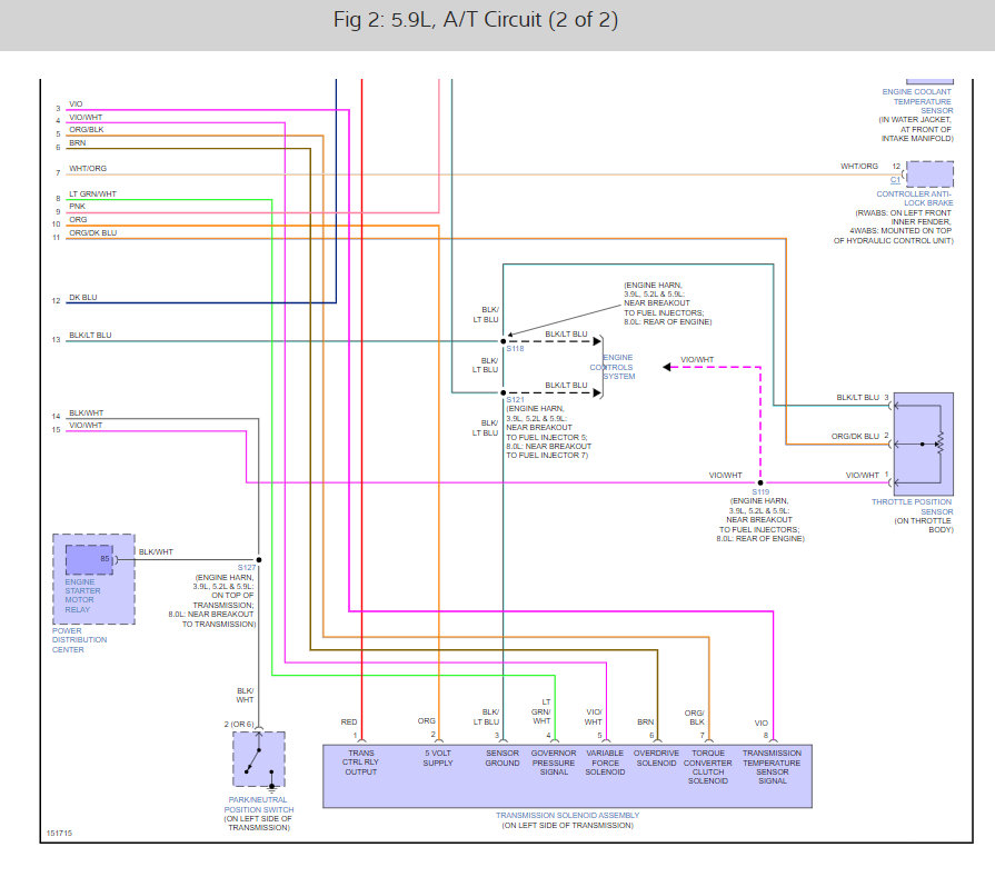

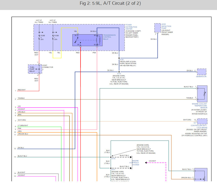

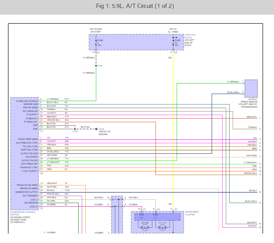

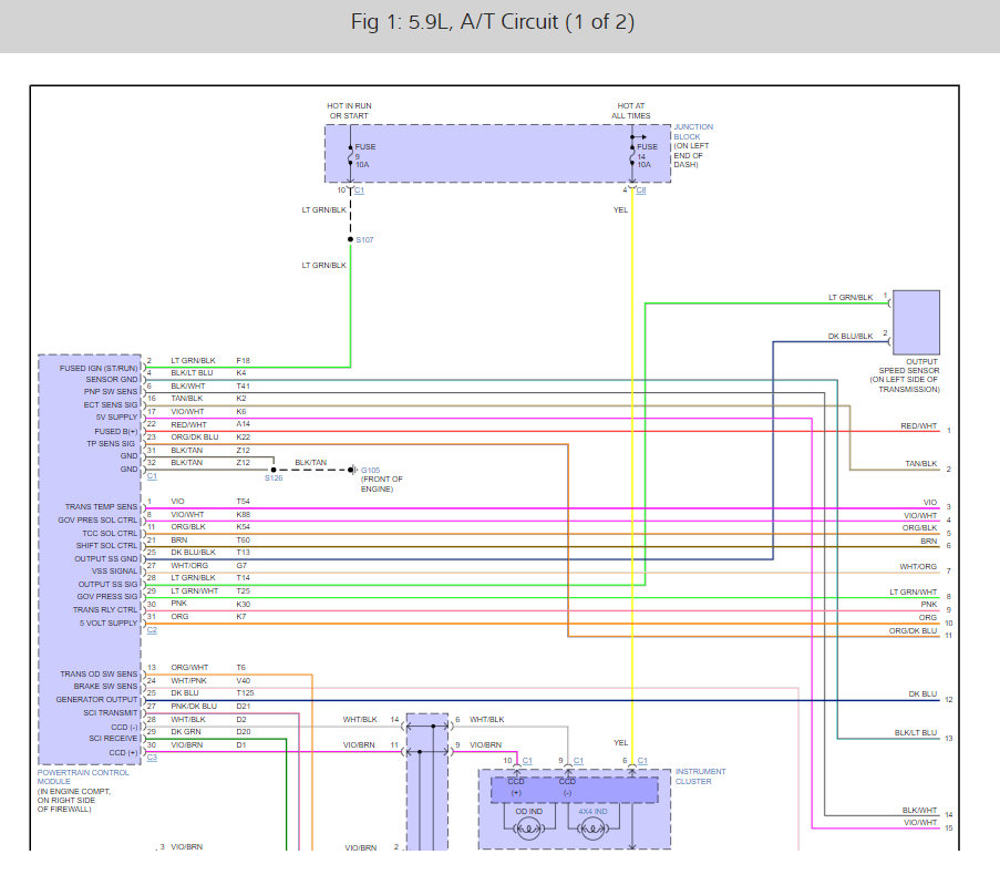

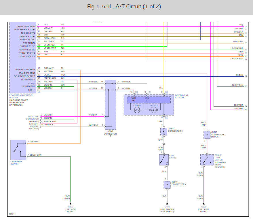

Here are the transmission wiring diagrams so you can see how the system works. Check out the diagrams (below). Please let us know what happens.

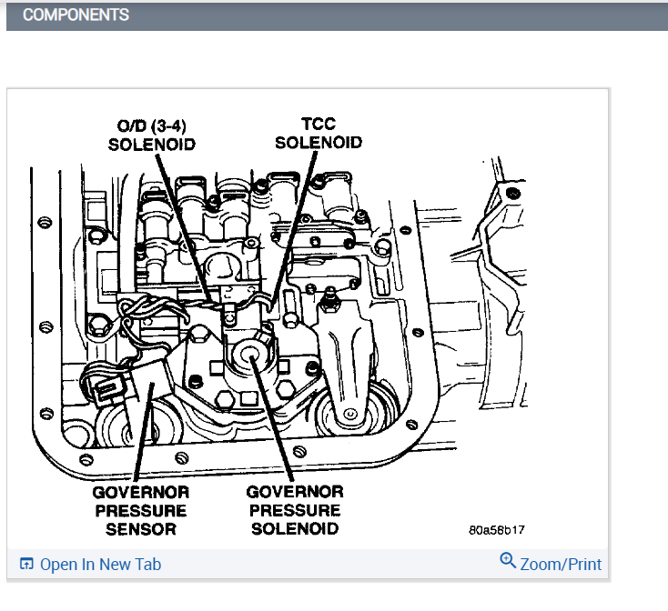

All the fuses are good. Switch seems to work today. The OD light comes on and off. Scanned for codes and got a P1740.
Aug 30, 2022 at 1:21 PM

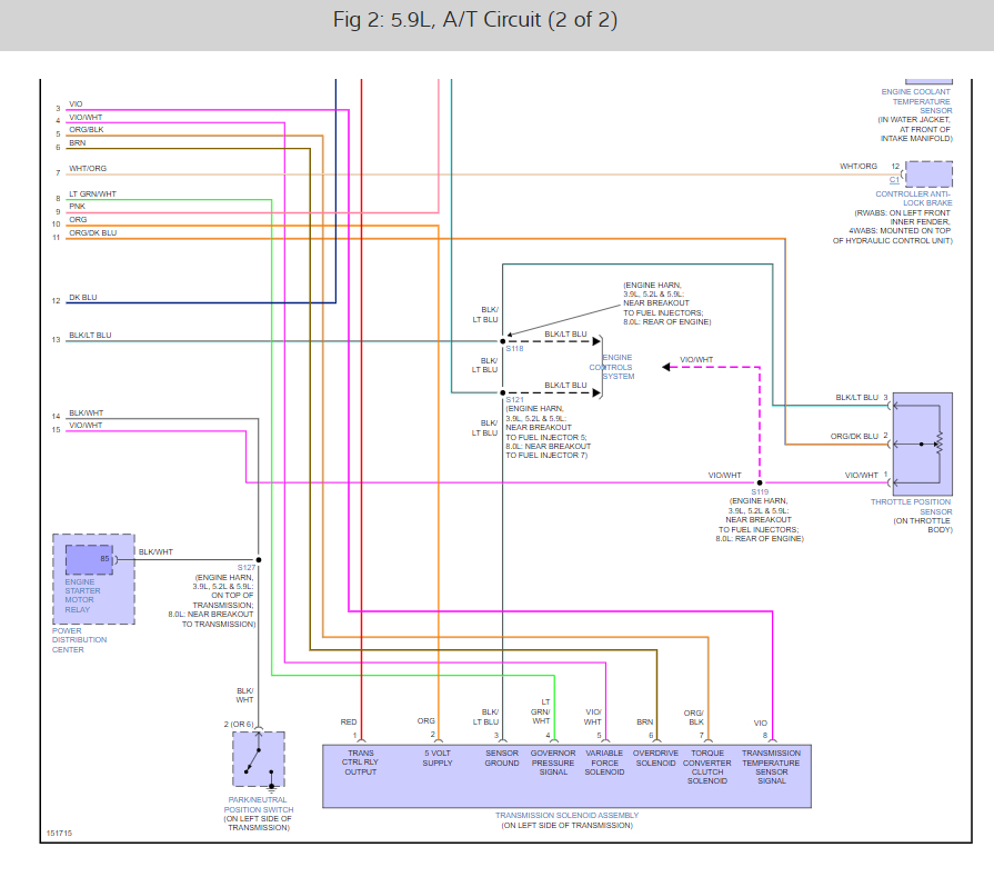

Okay, this code P1740 is for the TCC solenoid here is the location of the unit so you can check the connections and if okay replace the solenoid.
